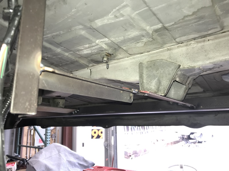

I've attached some pics of the car as found in the driveway, some rust areas and the rear trunk repairs I've started. I'll chronicle the build as I go, so feel free to chime in!

strawman   I've ordered some POR-15 supplies and some Wur...   Apr 18 2008, 12:56 AM

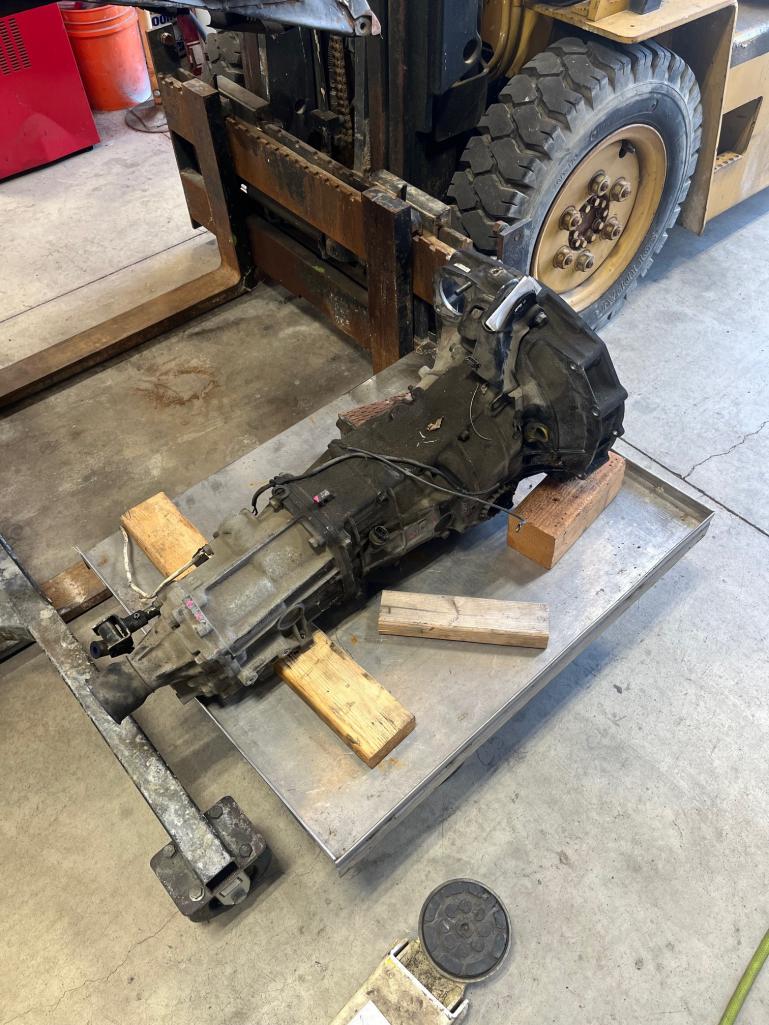

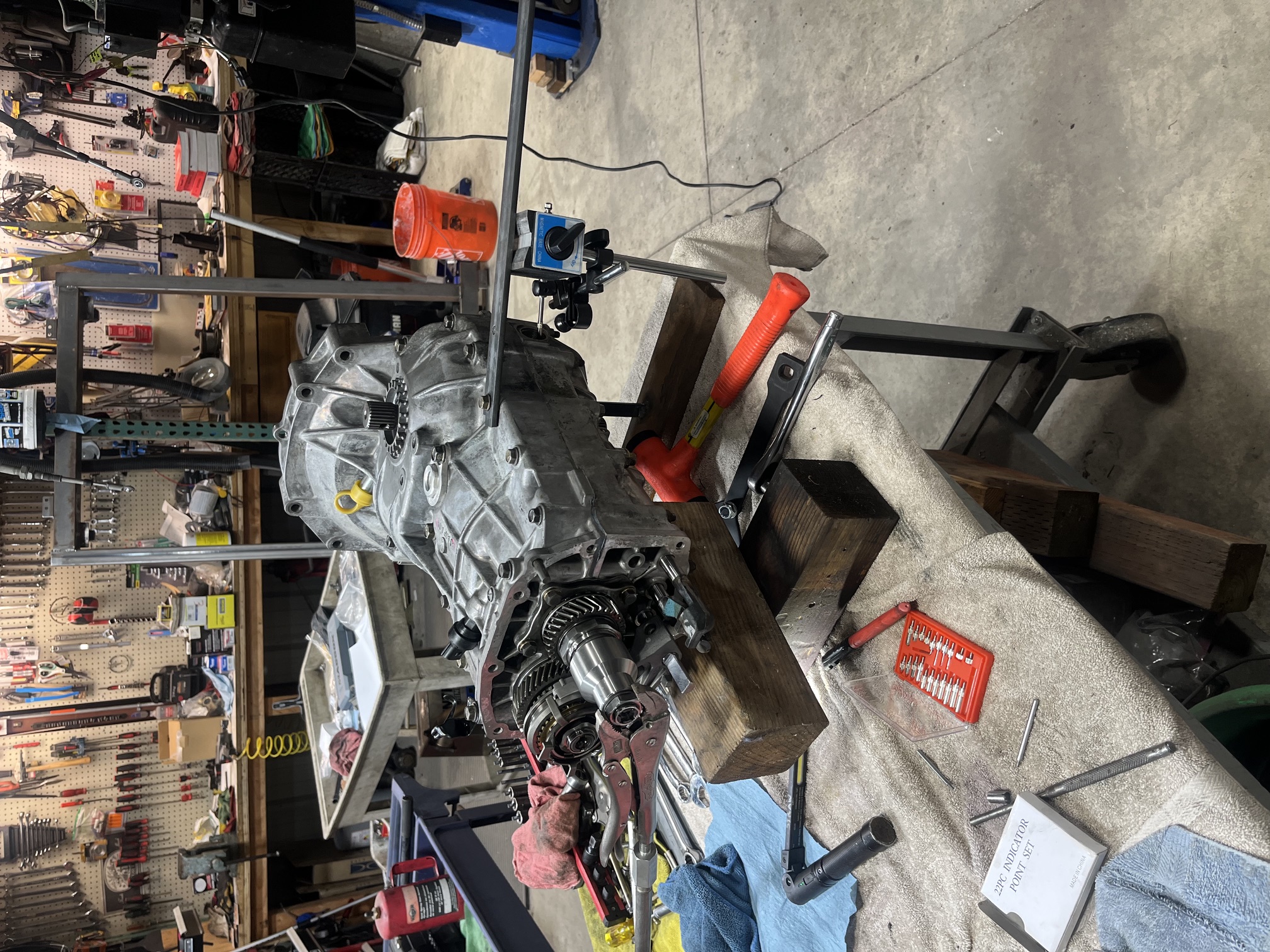

strawman   So I finished up the installation of the OBX limit...   Sep 23 2009, 11:12 PM
strawman   Now that the transmission is ready to go, I starte...   Sep 23 2009, 11:32 PM

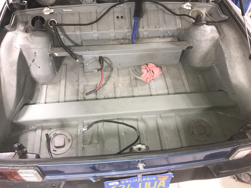

strawman   I finally got around to finishing the rear trunk r...   Oct 22 2009, 01:12 AM

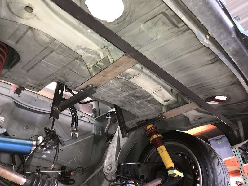

strawman   Finally took some pics of my modified trailing arm...   Oct 24 2009, 12:35 AM
