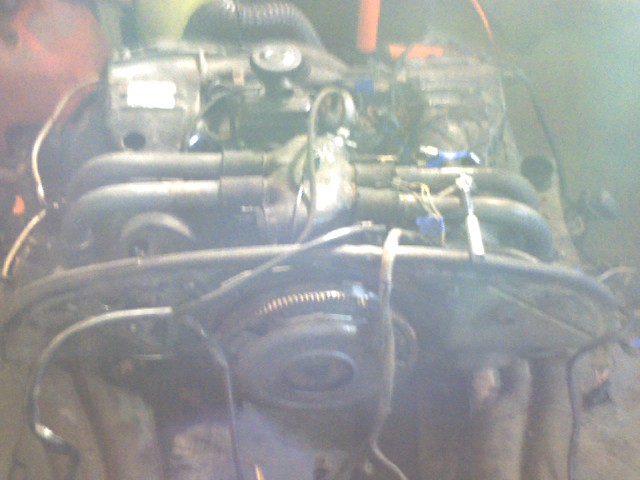

Other Misc pics.
Dirty
Attached ImageAttached Image

But wait, there's more:

The teeth on that flywheel are good and sharp. Here's what happened when I tried to take it off without an impact wrench.
