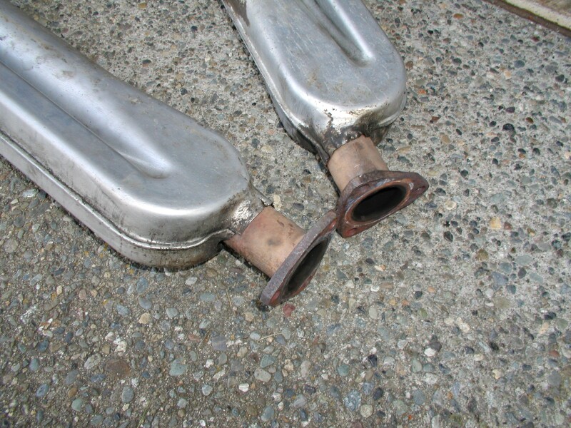

I sure hope they are not the HE's....since I sold my old ones to Nathan. (IMG:style_emoticons/default/sad.gif) I don't recall ever having exhaust fume problems with them.
They were in pretty good shape, pretty clean inside and out. At the tail end of the exchangers, where it crimps around the single tube, that part is loose. I always used a large hose clamp to keep it in place. JB weld might have been a better solution.
One thing you could do to test, is disconnect all the tubing to the cabin and see if the fumes go away..that should help narrow it down.
(I didn't need these HEs anymore since I backdated my system.)
Here's a photo of the ends....

just a quick update on the CO mess:
i capped the heat ventilation hoses (that run down the longs), and this seems to keep the cab full of ONLY fresh air.
i do suspect the #3/4 heat exchanger of leaking -- it blows significantly more air out than the other one. plus, it makes a sound which i first suspected to be valve clash (and was very worried about), but which i now believe is an exaust leak resonating in the HE.
my plan is to pick up some late model HE stubs, chop them short, and fabricate a new header to go to my late-model bursch. i'm short on money, so i can't really invest in a back-dated system (or tangerine) right now, but i got access to a welder!! (IMG:style_emoticons/default/welder.gif) i figure any design i come up w/ is going to be at least as good as the late-model system... i think i'll be omitting that 180 degree bend...
btw, eric: thanks for your consideration, but don't feel in the slightest bad about the HE's! they got me by just fine until recently, and i'll be using them as the template to design a new system... (IMG:style_emoticons/default/beerchug.gif) cheers, nathan
