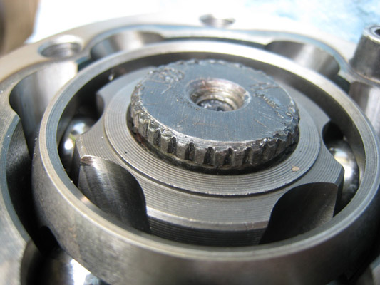

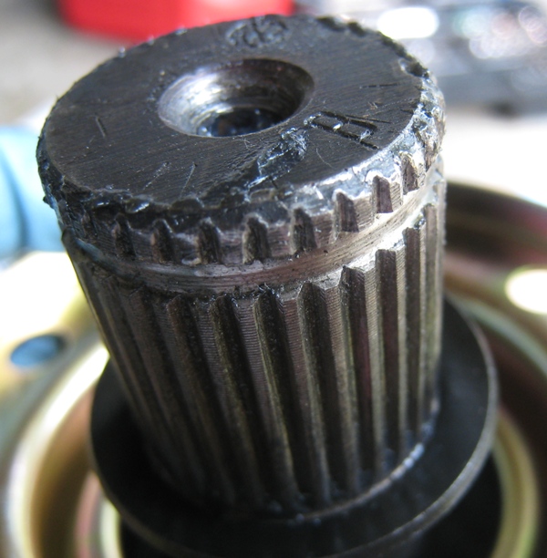

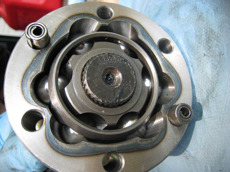

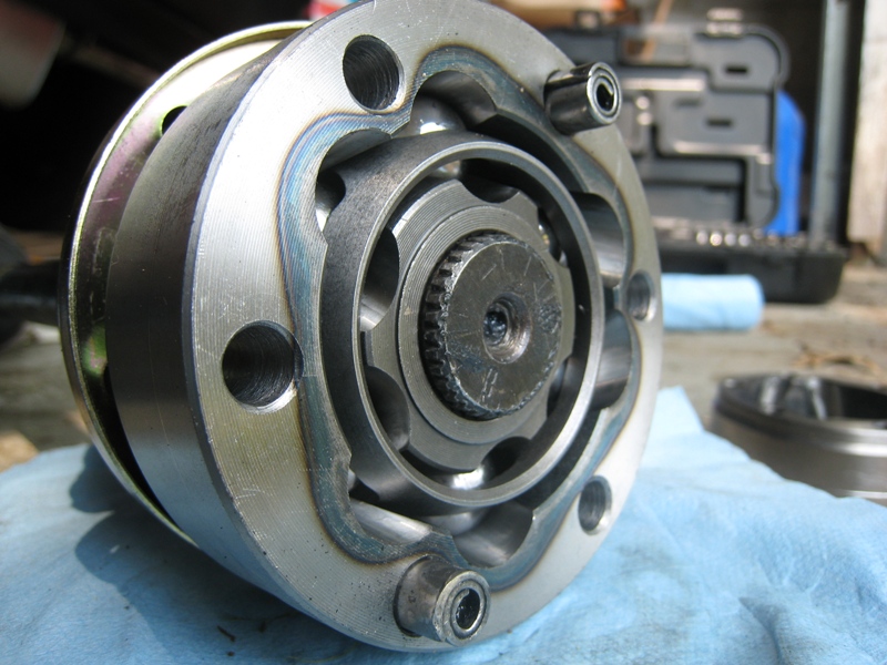

Eric sent me a new CV no charge, got it a few days later. I pulled everything apart and came across something a bit odd during installation. The new CV slides easily over the splines of the shaft with no resistance at all. Furthermore, there is a tiny bit of slop between the splines of the drive shaft and the inner race of the CV. I took a few shots and snapped a quick video. Let me know what you guys think. I was hoping to autocross tomorrow, but I decided to cancel due to this area of concern. I've installed five of these joints before, all require significant force to press the inner race onto the drive shaft. In order to remove the old CV, I needed a bearing puller. Something is strange... is this a concern or am i crazy?? Is the driveshaft too small, or CV inner race too big?? My first guess is that the CV is the issue since the previous CV was a tight fight.

All of mine slip on without pressing. That does look a little large, but then again, the newer parts ain't what they usta be.
And don't look a gift CV in the mouth...
Hows the tranny and engine mounts, and the training arm bushings???????
Ken

I was about to reply that mine typically slip onto the splines without much force, but after watching the video, I changed my mind.
I can't tell exactly from the video how much slop is there, but it looks like the inner race twists on the axle shaft splines. I don't think it should do that. Have you tried a different axle shaft for comparison?
Could pulling your old CV inner race off the shaft have damaged the shaft splines?
I wonder if the inner race was smashed by the old broken joint to the point where the splines were crushed and now the new joint is now a loose fit on the splines.
I wish I had a definitive answer for you, but I do not. I would try a spare shaft with the new joint.
