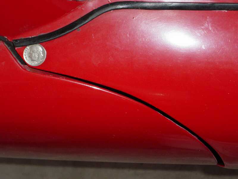

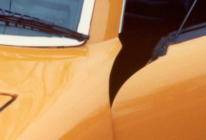

Cowl-to-Fender Seam: absent (metal-filled) or empty for very early 70 (up to #49), rubber seam thereafter. (IMG:style_emoticons/default/confused24.gif)

GeorgeRud   Early cars had a finished cowl to fender seam, no ...   Jun 11 2008, 02:06 PM
6freak   Early cars had a finished cowl to fender seam, no...   Jun 11 2008, 02:19 PM
SirAndy   Early cars had a finished cowl to fender seam, no...   Jun 11 2008, 03:03 PM
davep   Early cars had a finished cowl to fender seam, n...   Jun 11 2008, 03:57 PM
SirAndy   George is correct. Quoting from the factory bulle...   Jun 11 2008, 05:44 PM
burton73   [quote name='SirAndy' post='1043802' date='Jun 11...   Jun 12 2008, 12:53 PM
SirAndy   It is very clear that my car 9140430041 has fende...   Jun 12 2008, 01:09 PM
gms   [quote name='davep' post='1043825' date='Jun 11 2...   Sep 1 2008, 04:39 PM
gms   here is #41 marked up   Sep 1 2008, 04:44 PM
gms   Here is 914.043.0035 it had a filled seam   Sep 1 2008, 04:46 PM
Lavanaut   I have attached 2 photo the red one is 914.043.00...   Sep 3 2008, 07:00 PM
smontanaro   Also the rear view mirror (interior) is tiny in th...   Sep 3 2008, 09:17 PM
Lavanaut   Got dimensions for "tiny" and not tiny?...   Sep 3 2008, 11:23 PM
gms   I have attached 2 photo the red one is 914.043.0...   Sep 3 2008, 10:57 PM

Eric_Shea   #11 is w/o the seam.   Jun 12 2008, 06:01 PM
SirAndy   #11 is w/o the seam. got a picture of that? ...   Jun 13 2008, 12:15 PM
Eric_Shea   Yes Sir but for some reason he doesn't want th...   Jun 13 2008, 03:33 PM
