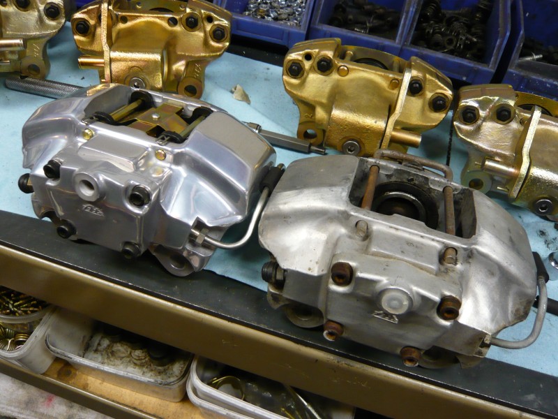

Mine's on the left. It's a reconditioned, very early (69-70) S-Caliper that I will be using on my GT car. Dave's one-off is on the right. The first glaringly obvious difference is the endurance pad pin assembly. Any car that is going to go through S-Caliper pads in a single race is probably going at it for 24 hours.
Upon further inspection, this caliper was finish machined slightly different as well. The tops were flattened but only by a small amount. Various logos and markings are not in the usual production locations and there's a few "niceties" that would be missing. I'll try to cover it all herein.

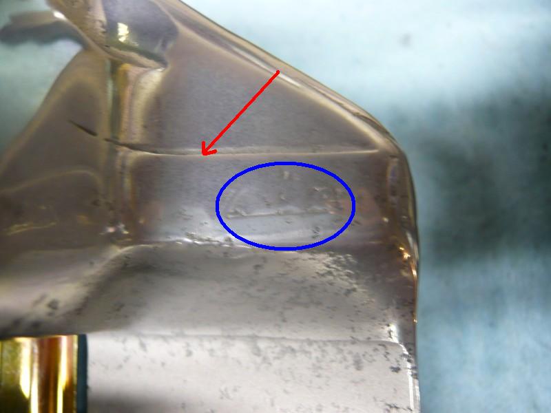

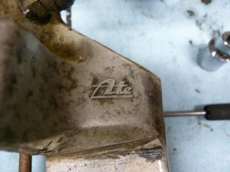

First let's look at the bottom side logos. Both are "basically" in the same place but, the casting lines from the production caliper (red arrow) is missing and the logo is centered (refinishers buffed the other logo a tad much):

Here's the two side by side. Again, proportionately these calipers are identical. You can see how they finished the top on this caliper:

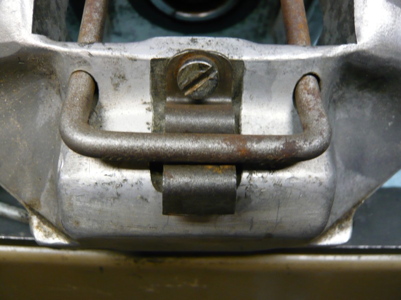

Here's a little more detail on the quick-change endurance pad pin. While this was a rather crude adaptation to the original caliper, I do believe it falls right in line with a factory race look and feel. I'm fairly certain this was an original mod.:

The pin assembly itself is rather crude and not even but again I think this is a factory manifestation. I've seen these pins on one other set of calipers but without the latch mechanism. All in all, it was an interesting afternoon (for me anyway). Here's a full-on shot of both calipers (pay no attention to the two pair of original GT calipers in the background!):

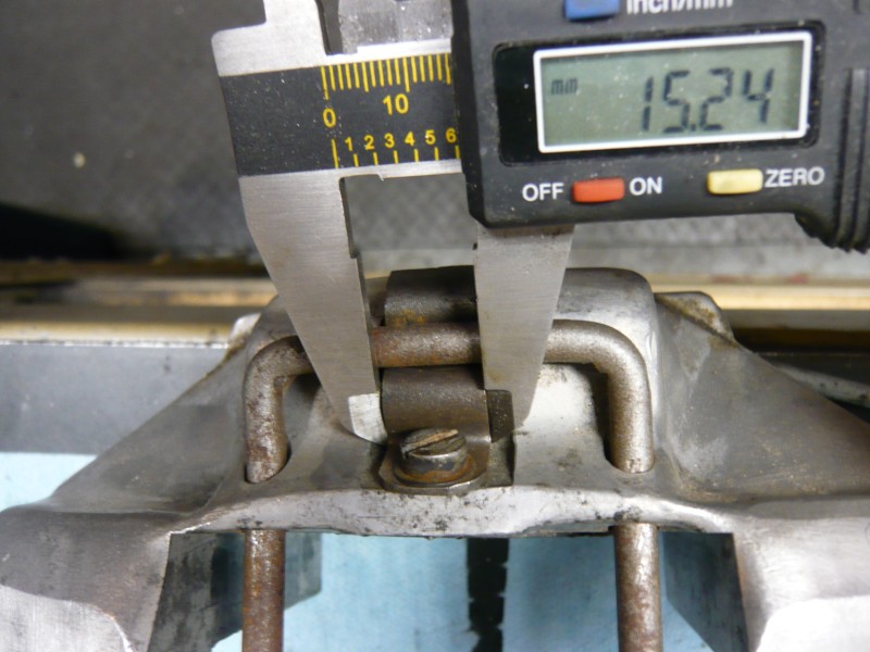

Eric_Shea   Thanks E. One more measurement from this AM: The...   Jun 14 2008, 12:23 PM
