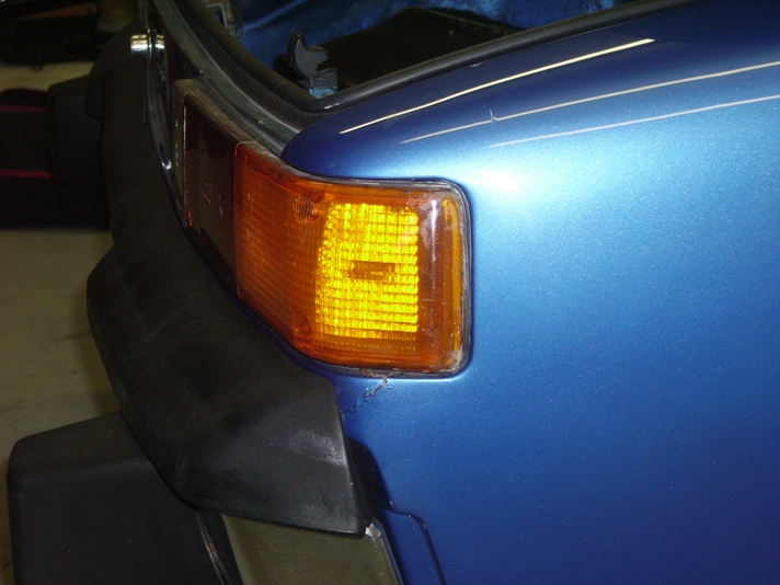

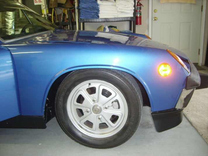

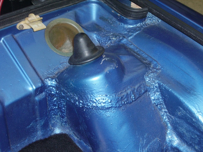

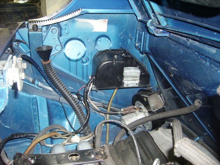

More front trunk.

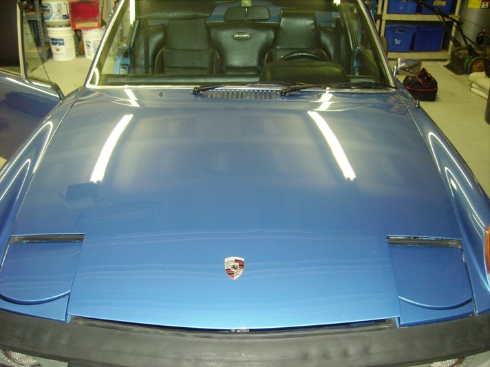

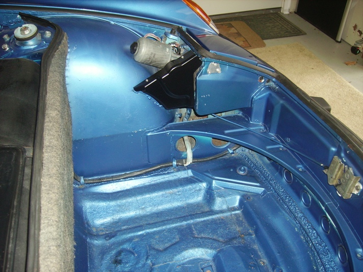

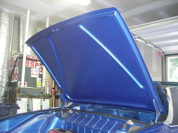

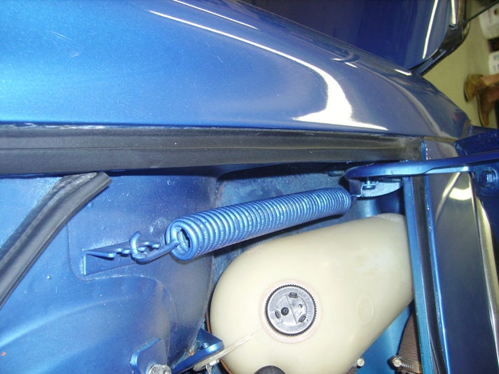

Trunk lid.

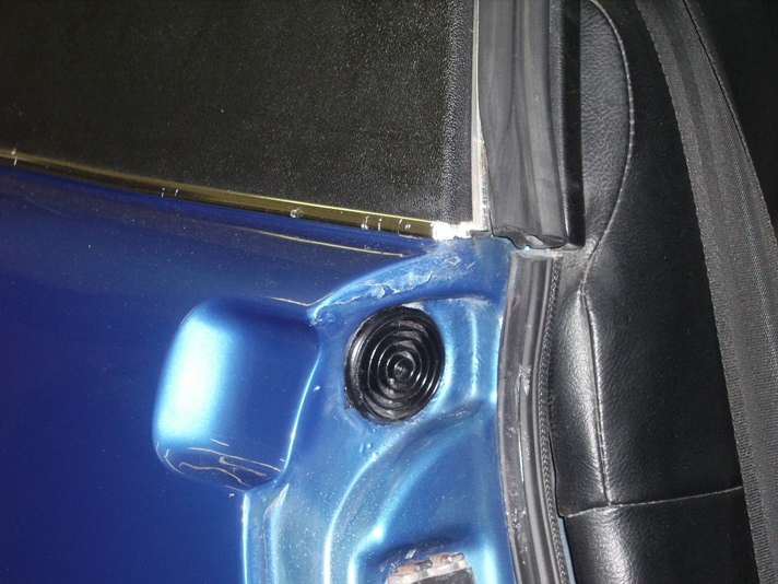

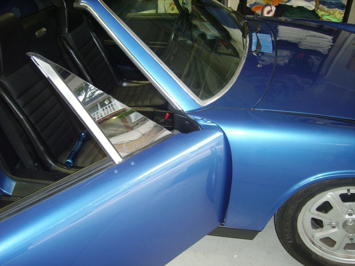

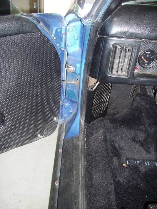

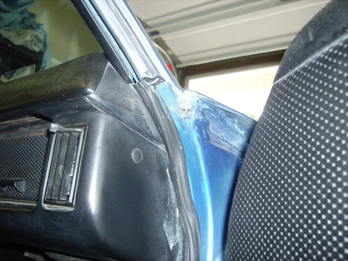

RF Fender, Pass door, door jam.

rust free you say ?
Posts: 16,375
Joined: 7-January 05
From: richmond, Va.
Member No.: 3,419

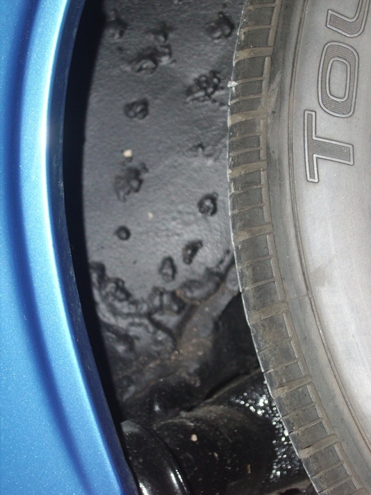

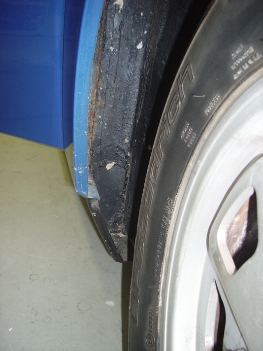

#1 this should not have to be stated but there WILL be rust issues under the fibreglass. NONE EVER puts fiberglass over good metal/ Why would you.
#2 having said that Mike we all know you won't find a real " rust free " car for these prioces. I fully expect to have to do some amount of rust repair.
#3 Rusty how did the floor pans look? As stated abpove I fully expect to have to repair the H.H. on any car Mike gets and most probably the rear trunk as well. Solkid floors and longs would be a big plus point for me (IMG:style_emoticons/default/smile.gif)

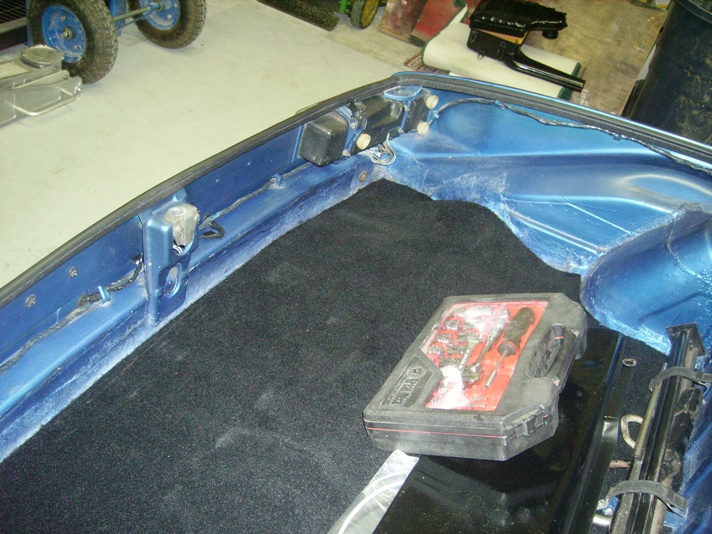

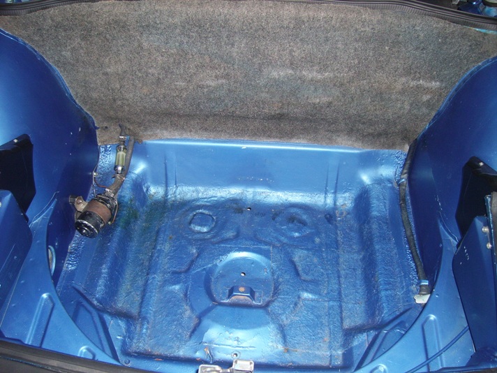

RR quarter, rear trunk.

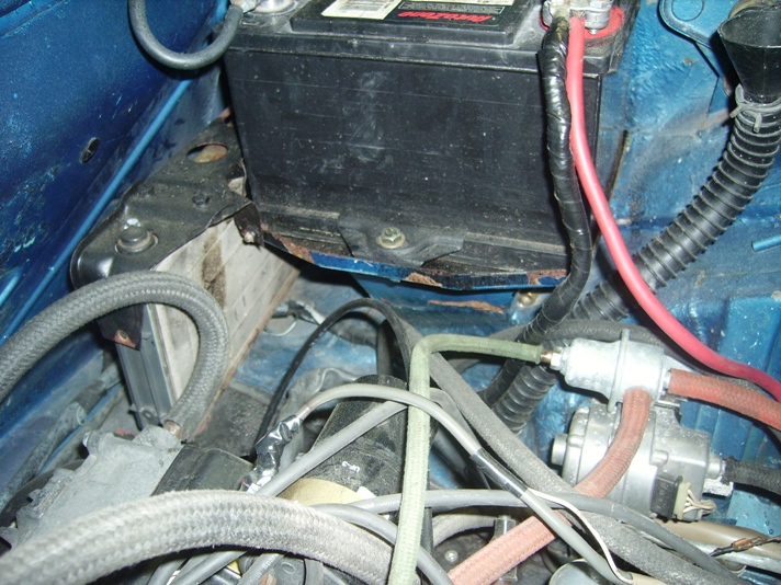

Engine compartment.

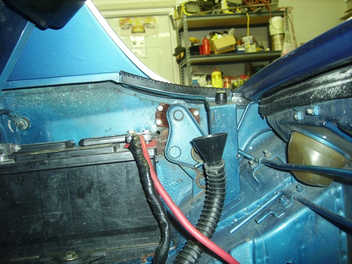

Dr side trunk hinge mount has been replaced before re-spray. Note pop-rivets (IMG:style_emoticons/default/dry.gif)

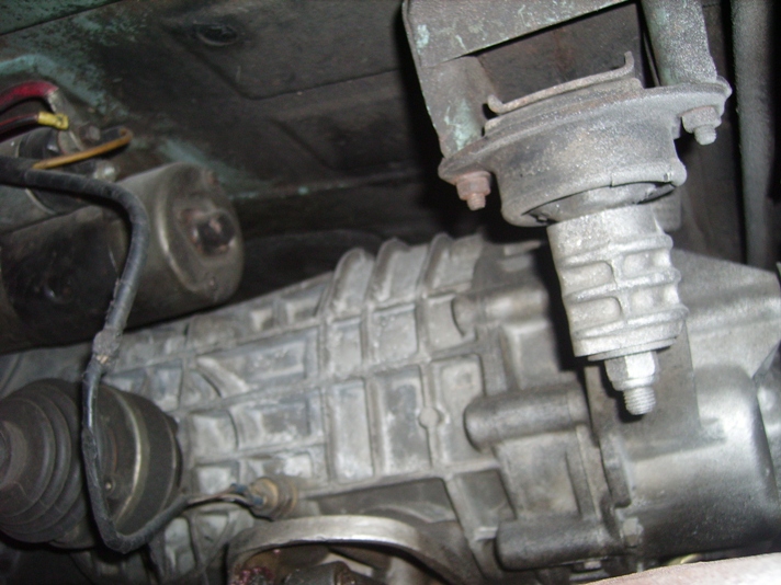

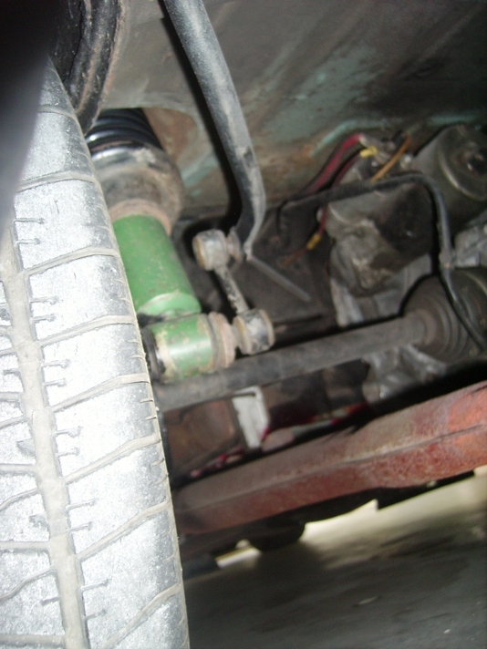

HEs, Bilsteins, starter.

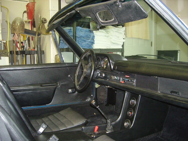

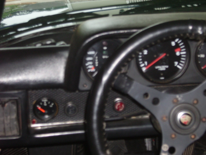

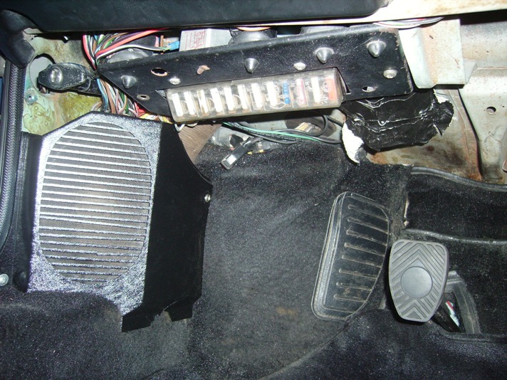

Interior.
Sorry about the one picture... I was channeling Andy. I felt a fierce urge to grab my combat boots and shave a mohawk into my head. (IMG:style_emoticons/default/biggrin.gif)

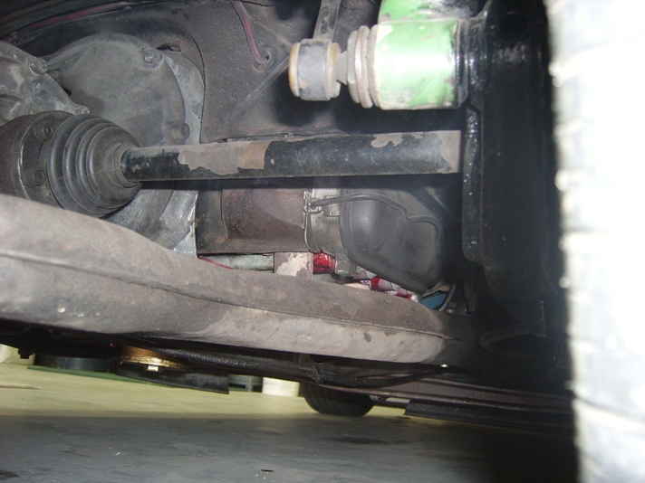

Please note... I don't think this is a bad car... but any buyer should be aware of the challenges they may face in the future.
Also, I didn't do any leakdown or compression tests on the motor.
Scott, I didn't think the floor pans looked too bad. I was especially interested in the area around the pedal cluster... but that didn't show any signs of a M/C leak. Clean and dry... and obviously had been that way for some time.
The seller says he has a lift. (Probably in the side garage that stores his 75 Carrera with the 3.2.) Sadly, I was already almost two hours into the inspection... or I would have stayed and asked him to put it up for more pictures.
