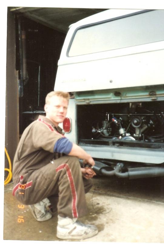

Here's the first one. It was in a 64 Kombi. I put in a bus boys select a drop and eliminated the reduction boxes. This one I bunny hopped in front of the house and broke an axle. My friends told me when I stomped on it the rear tire came off the ground a foot. You can see the cheesy carb linkage. I learned that you needed to spend some money on a decent linkage to keep the carbs sync'd.

I say go for it. If folks can throw in V8's why can't you toss in a T1.
I built the bus 17 years ago and the bug 14. I wish I still had that much hair. I'm sure Jake could hook you up with parts and ideas. I'm thinking a T1 with a Porsche style fan shroud and dual carbs would look quite sweet in your 914.
Heck, I forgot how long I was doing this stuff. I looked at the date on the photo I scanned and just about choked. Man I'm getting old.
