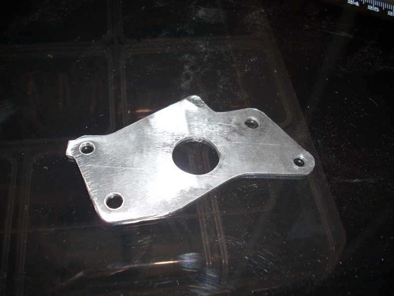

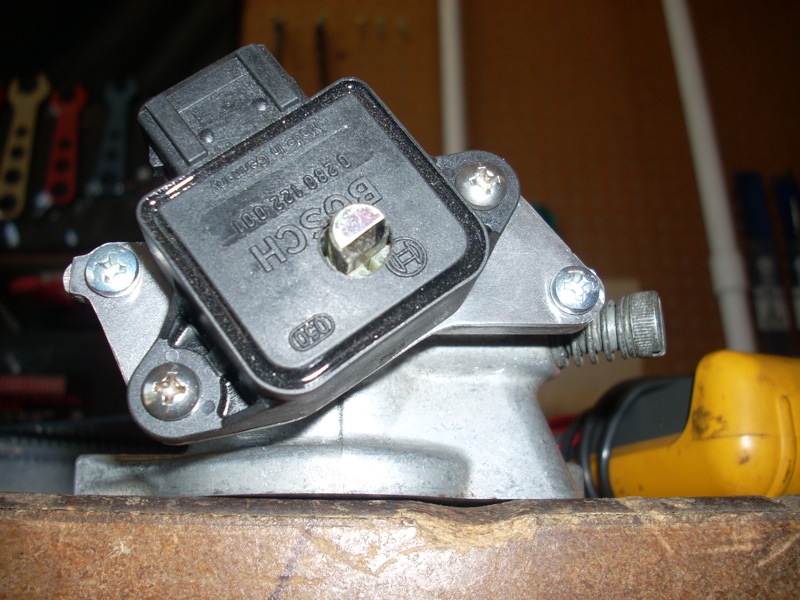

I am using the TPS off of a Volvo 850 because it's a Bosch sensor (I like sticking with OEM manufacturers when possible), fits the D-shaft throttle and is appropriate for MS. I made the adapter plate today.

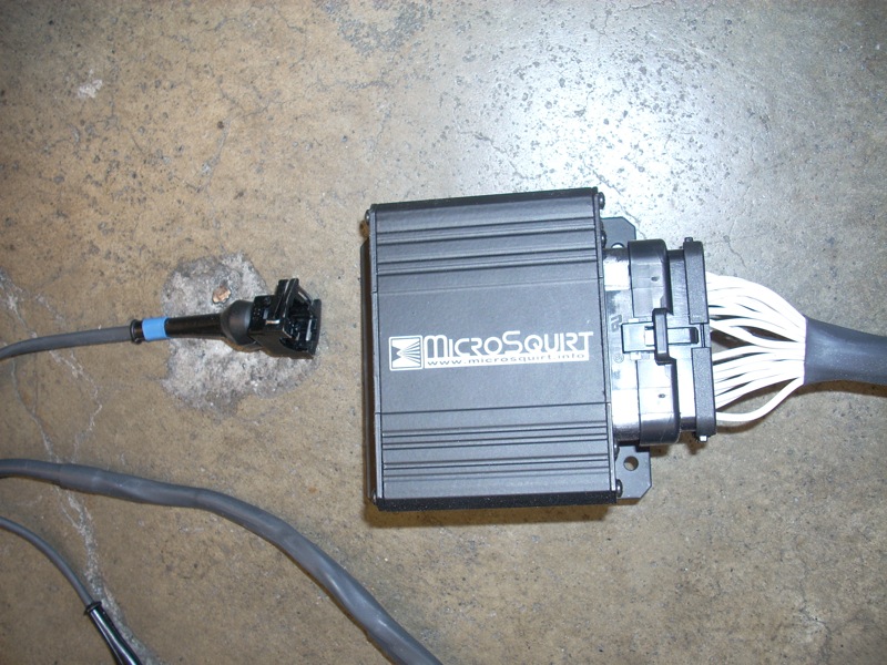

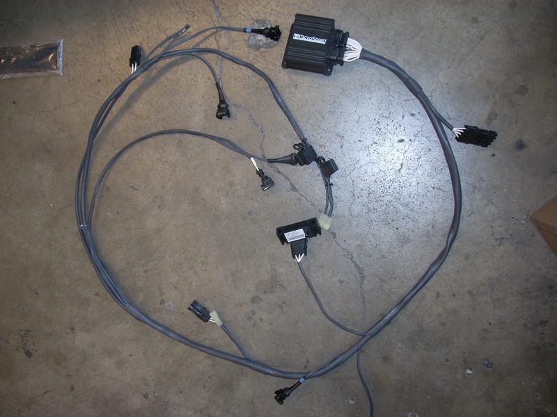

Here is the wiring harness I had Jeff Keyzer make me. We sourced all the correct, uncrimped connectors so each connector could be attached directly to the harness wires.
The MicroSquirt unit is tiny, weatherproof, robotically soldered using surface mount components, and shielded from EMF. It was originally designed for motorcycles, but I think in our case, it's a much more appropriate choice than your standard MegaSquirt.

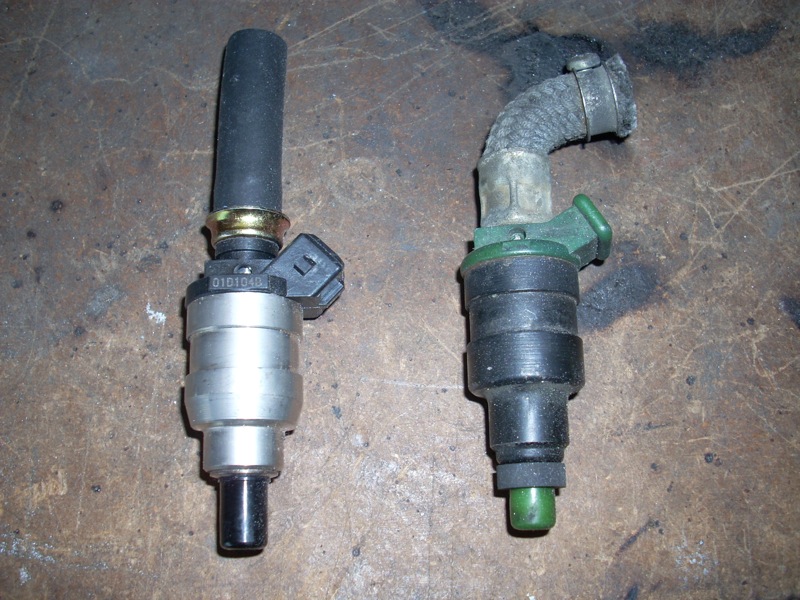

The injector on the left is a custom made high-impedance injector that works perfectly in our manifolds with stock hold-downs, stock connectors, and will allow use of the stock fuel rails. No resistor packs necessary. (IMG:style_emoticons/default/thumb3d.gif)

Giddyup! Right on Mark. Microsquirt? Never heard of it. Price? Are the connectors readily available and not unobtainium? Where do those "custom made high-impedance" injectors come from? Price?
Screw all of that. When you getting working I might just be the first in line. (IMG:style_emoticons/default/laugh.gif)

This looks very interesting.
Is the microsquirt just an off the shelf unit?
Injectors? also off the shelf?
Looks like a fun project and I would really love the hear the results, how easy it is to tune, and how much of a cam it may support....

This setup will be expensive. But doing it right is usually not cheap.
MicroSquirt: $400
LC-1 WB-O2: $200
MAP: $64
TPS: $75
TPS Connector: $35 (this connector had to come from europe) (IMG:style_emoticons/default/sad.gif)
Custom Injectors: $85 each, $340 for four
Wiring Harness: price is not set but more than $400
Injector Connectors: $12 each, $48 for four
I think when everything is done, it'll be around $2000 for the bolt in setup. I'm keeping drawings of my custom parts so that they can be laser/waterjet cut in the future. Everything will mount in the engine bay, so this will be a no cutting/modifying installation (except O2 sensor bung). Also, if everything goes according to plan, the stock fuel pump/fuel regulator will be used, which will save a significant amount of money and maintain a stock look.

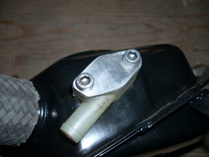

Cold start block off...
MS does cold start enrichment in software and widens the pulse width, so the archaic 'fifth' injector isn't necessary.
I will be using the archaic AAR though. (IMG:style_emoticons/default/laugh.gif) So the feed bracket goes on.
