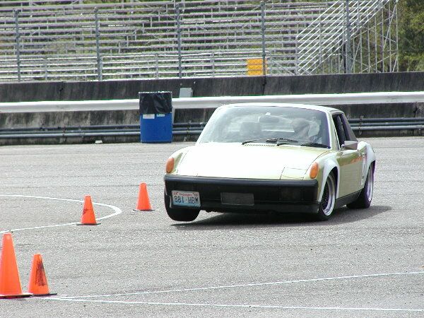

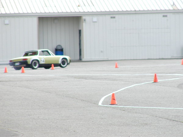

As to the pictured A arms. Nice, but a outmoded/cheep design taken to extreme. MacPherson strut suspensions are.....sucky.....I know, it's what we got. (IMG:style_emoticons/default/sad.gif) I shouda started out with a Lotus 7 (or copy). (IMG:style_emoticons/default/confused24.gif)
BTW, here's a pic (rerun) when I was using 180lb
Welt springs (progressive PsOS). & 21 mm T bars. It don't do that with 200 lb nonpro. springs. I'm still going to 225 or 250s, tho. Too much push.

Here's a bump.

Man! that's good camera work! Oh! and great drivin' too (IMG:style_emoticons/default/beer.gif)
