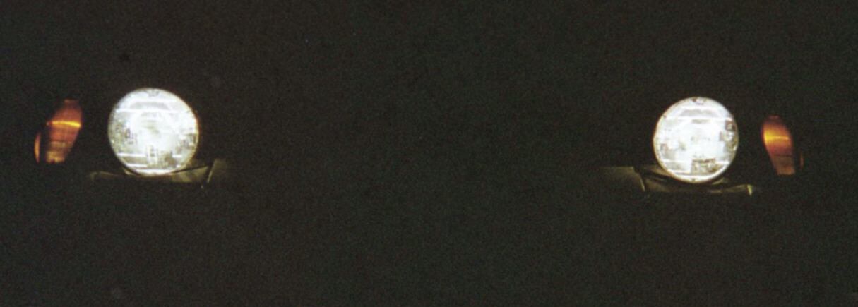

pic attached of these Silver Stars....

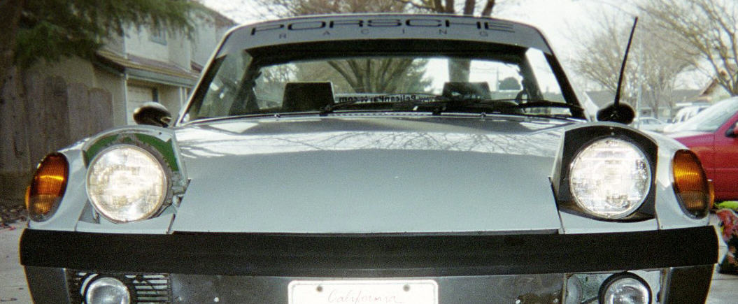

found this pic of 1/2 way thru putting in the Silver Stars.
One Old,
One Silver Star (white)
sorry the pics are so big (IMG:style_emoticons/default/blink.gif)
