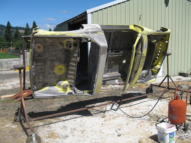

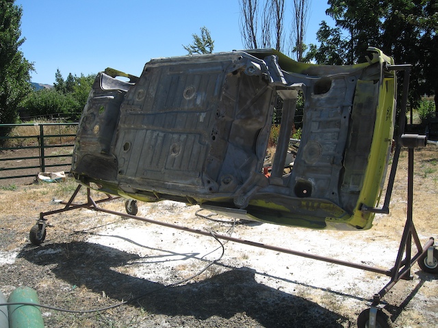

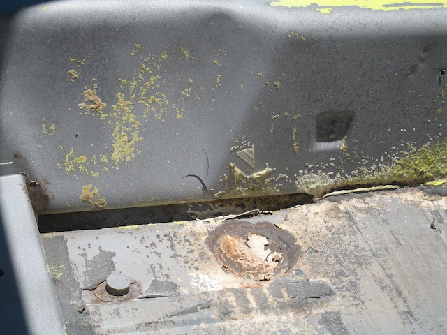

So its time to quit making parts and start building my car. My true goal despite a bunch of design ideas is to have something I can drive, enjoy, use, and convince the wife to ride in, making it worth the all effort I'm putting into this. I've started with a 74 yellow CA car with fairly mild hell hole rust. The first step was to strip the car of everything, steal all the one-quart freezer bags from the kitchen and label and bag everything I could think of. I threw together a rotisserie out of a bunch of rusty scrap pipe I found in a field. I had the wheels kicking around for years from Harbor Freight. I built this so I could have an off road rotisserie and get the car outside to sandblast it. When all is said and done the sandblasting took about 10 hours with about half that time devoted to heating up the seam sealer with a mapp torch and scrapping it out with chisels and picks. I probably spent and equal time sandblasting remnants of seams sealer to the the time spent on the entire remainder of the car.  One thing that really sped up the sandblasting was to pre-prep large areas with paint stripper; the paint would come off very easily. None of the stripping is fun. Sandblasting requires a respirator, hearing protection (horrifically loud) and eye protection. I initially was wearing a tyvek suit and still got dirty. It also was about 100 degrees out and it got pretty ripe in there. I spent the remainder of the time dressed like in these pictures and all was well and good till the air hose separated from the nozzle and blasted the back of my upper arm. Really friggin hurt and looked like road rash. For eye protection I used the hood shown, then tried a full face shield. What worked best however was using an old welding helmet with a clear lens. The clear lenses would last about 1-2 hours and only cost $.49 to replace compared to a few bucks for the hood and 15 bucks for a shield neither of which had a longer life than the $.49 lens for the welding helmet.

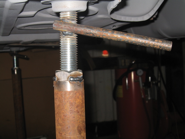

Wilhelm   You will get sand in places you didn't reme...   Sep 9 2008, 01:21 AM

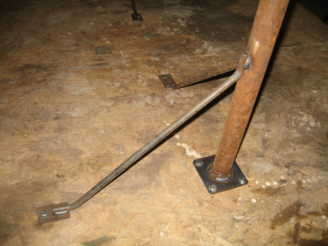

Wilhelm   After much digging out seamsealer and blasting ...   Sep 9 2008, 01:28 AM

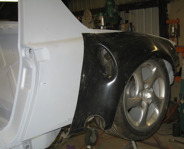

r_towle   I love that rear fender...what is it from??? Rich   Sep 9 2008, 07:30 PM
jd74914   993 Turbo S maybe?   Sep 9 2008, 08:15 PM

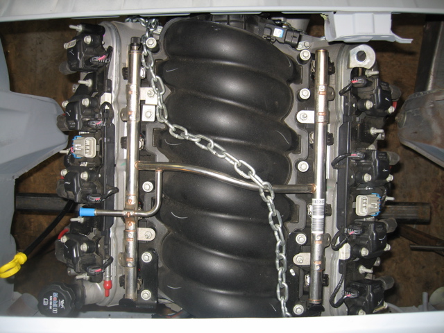

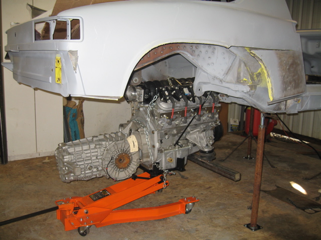

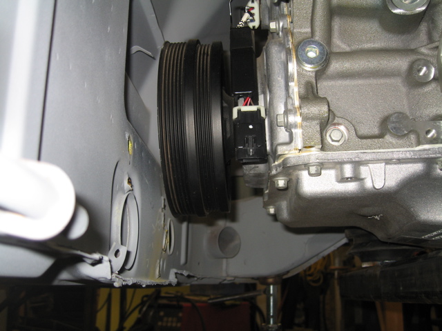

Wilhelm   Seems like I've been working on a million litt...   Dec 8 2008, 07:04 PM
Wilhelm   Today I Decided to do some test fitting of the eng...   Dec 8 2008, 07:11 PM
Wilhelm   With the engine harmonic balancer 1/2 " from ...   Dec 8 2008, 07:15 PM
JRust   Making good progress! I'll have to find ou...   Dec 8 2008, 08:46 PM
So.Cal.914   Making good progress! I'll have to find o...   Dec 8 2008, 09:04 PM
Wilhelm   Hmmm. A bigger engine, you mean like an LS7? N...   Dec 9 2008, 01:15 AM
stephenaki   On a serious note, you were all gonna let me die ...   Dec 9 2008, 02:04 AM
Wilhelm   On a serious note, you were all gonna let me die...   Dec 9 2008, 02:21 AM
stephenaki   [quote name='stephenaki' post='1109710' date='Dec...   Dec 9 2008, 02:23 AM

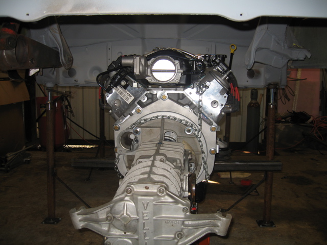

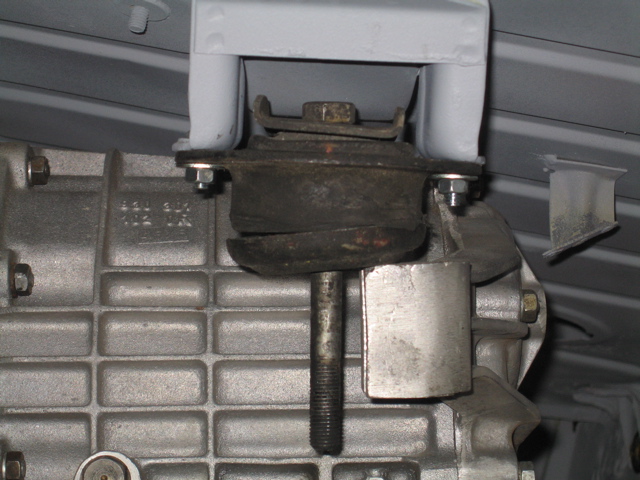

Wilhelm   Great to be back from the electronic limbo! I...   Dec 24 2008, 05:30 PM
Wilhelm   A closer view of the cross bar. The engine cross ...   Dec 24 2008, 05:36 PM
