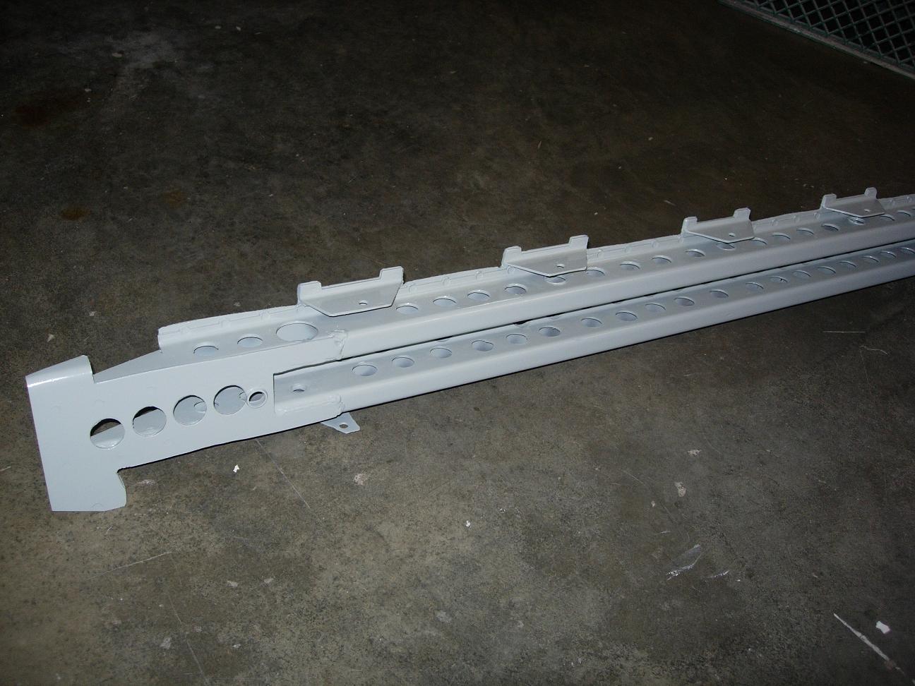

Hack the crap out of them. I got 11.5/ 7 off the rear/front. I had a hole saw and used my drill press. The heat shield is worth 3

Member No.: 2,104
The front

Loose the front and rear face in between the two rectangular fog light holes....
All that can be left is the top and bottom flange...with alot of holes...
I proposed to gut the shocks (the insides of the shocks...) but tack weld the tube together at the right lenght and drill the holes in the mounting brackets...
Again...all you need is the top and bottom flange...with holes
and the fog light holes (you dont even need those..)

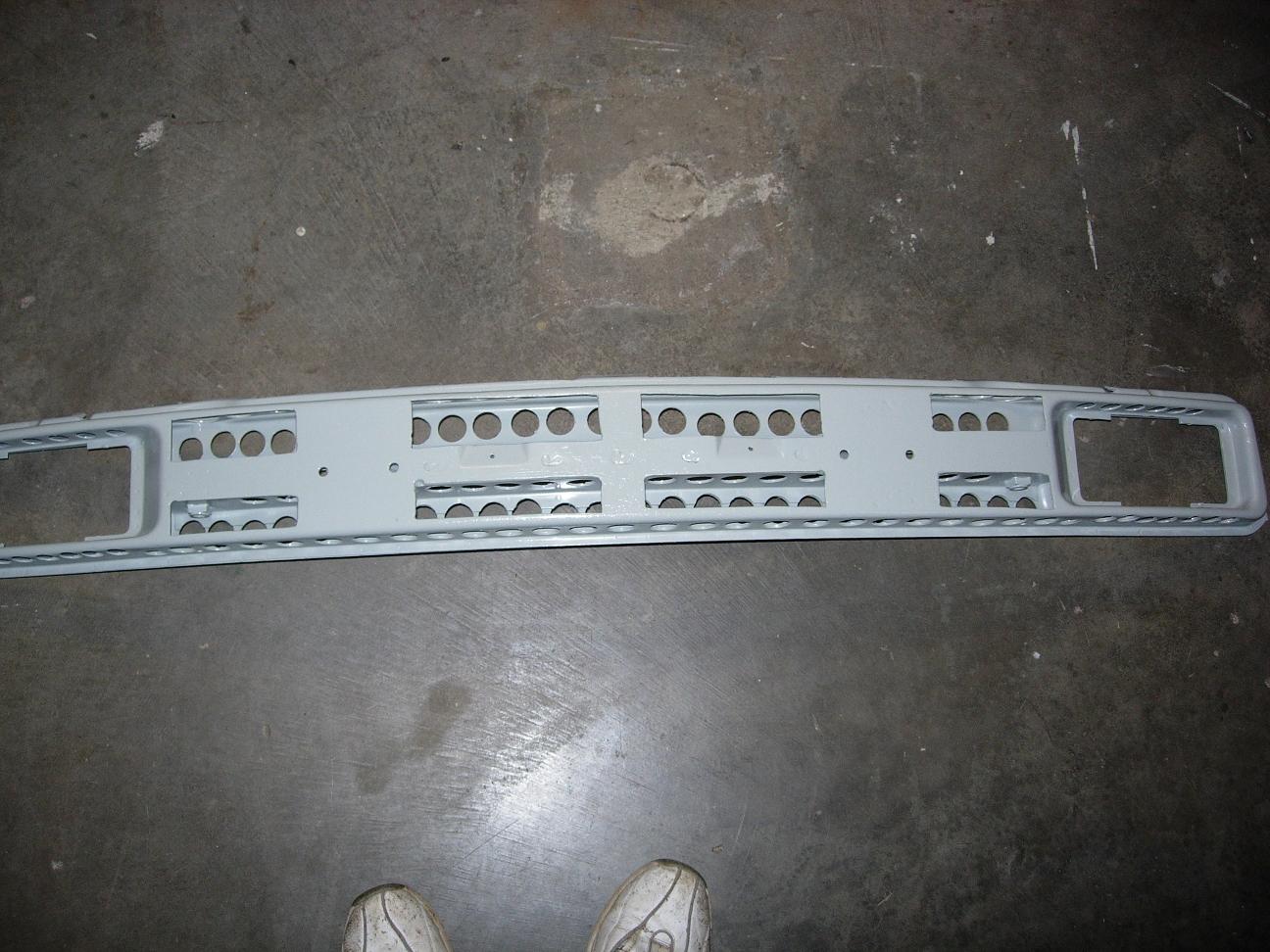

More progress on my BBBs
Tools on the job:
(IMG:http://farm4.static.flickr.com/3288/3016301243_15f4a427f5.jpg)
A growing pile of scrap:
(IMG:http://farm4.static.flickr.com/3073/3017131496_8951a8e84b.jpg)
Welding the bumper lip back on after cutting it off to gut the insides:
(IMG:http://farm4.static.flickr.com/3188/3016296343_7b2b333fdc.jpg)
And introducing...
(IMG:http://farm4.static.flickr.com/3254/3017122002_1f82b18608.jpg)
(IMG:http://farm4.static.flickr.com/3056/3016284833_4b91a1c555.jpg)
(IMG:http://farm4.static.flickr.com/3032/3016264979_5650b446e0.jpg)
Zach

VaccaRabite
post Nov 9 2008, 09:26 PM
En Garde!
Posts: 13,914
Joined: 15-December 03
From: Dallastown, PA
Member No.: 1,435
I manned up and got out my scale.
the front bumper steel insert now weighs 15 pounds.
the rear bumper steel insert now weighs 17 pounds.
This is not counting the rubber and shocks. Just the steel insert.
(from a post by Borderline on stock early bumper weights)
FRNT BUMPER STK 17.5
REAR BUMPER STK 17.5
So, my INSERTS weigh less then the early stock bumpers.
