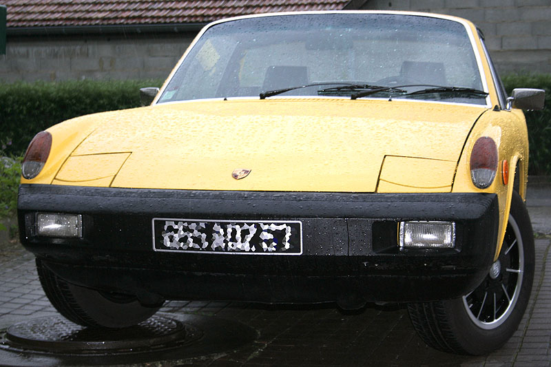

I have done the same on the front a few month ago. A shame I didn't make any picture. I'll do pictures next time I remove them.
I mesured a 7 kilograms difference on front bumper (about 15 lbs). I also removed the bumper "tits". I found smooth "titless" bumpers on ebay. I found out that they are a bit different in the way they are attached to the metal part.
I didn't start to put the rear bumper on a diet. Only attached the "titless" rubber on it. I'll work on the metal part later.
I feel the rear bumber is even heavier and I expect to remove more than 8 kg from it.

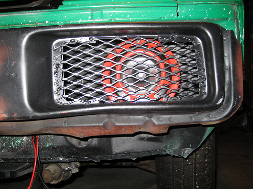

Well, the bumpers will have the rubber cover over them. I doubt there will be a whistle.

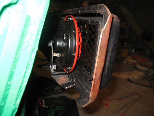

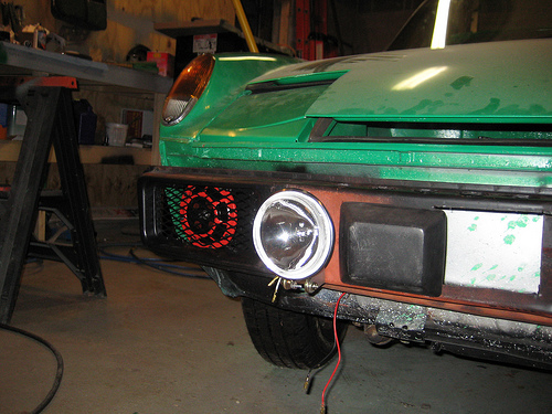

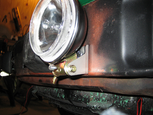

No bumper skin on yet, this is all just mock up. This took all freak'n day to fab up and put together. I work slow, but I feel that I hot a lot done.
One of my supertones, mounted int he bumper where the fog light used to go. Steel grill is protecting it.

Pilot driver light mounting. I had to reverse the mounting bracked, and I welded in a nut to the other side of the bumper. The bolt holding the light to the bumper is an m10.
(IMG:http://www.914world.com/bbs2/uploads_offsite/farm4.static.flickr.com-1435-1337606435.2.jpg)
Tit, light, horn. Will look better when the skin is on. Lots of holes in these bumpers now... (IMG:style_emoticons/default/smile.gif)
(IMG:http://www.914world.com/bbs2/uploads_offsite/farm4.static.flickr.com-1435-1337606435.3.jpg)

Horn mounting from the back.
(IMG:http://www.914world.com/bbs2/uploads_offsite/farm4.static.flickr.com-1435-1337606435.4.jpg)

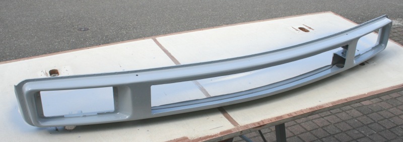

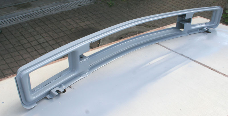

I had time to remove the front bumper and paint the metal insert.
As said before (man ! three years have past) I shaved about 6kg from the front bumper alone.
More to come. Rear bumper will have a diet next week.

I thought about doing what you did with the front bumper, but was afraid that cutting all the front metal would let the pad flap and deform at speed. Have you noticed that at all?
Zach
johannes
post May 21 2012, 11:36 AM
Post #32
Club Porsche 914 France member since 2005
Posts: 3,092
Joined: 13-January 06
From: France
Member No.: 5,409
Region Association: France
QUOTE(Vacca Rabite @ May 21 2012, 05:24 AM) *
Nice!
Zach
I haven't noticed any problem with that setup. I have a small licence plate bolted thru the pad, but I don't think this changes anything. The pad fits perfectly, it's well streched and I can't feel any flexing.
I also feel this minimal setup will stil provide much protection to the car than the earlier (pre 75) bumper.
