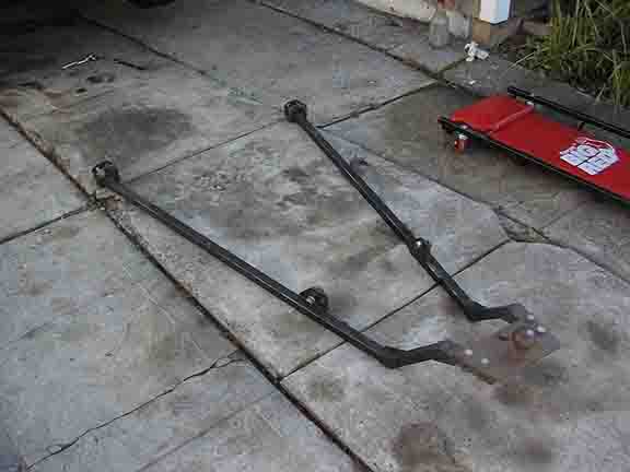

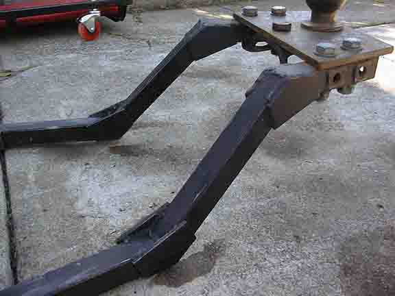

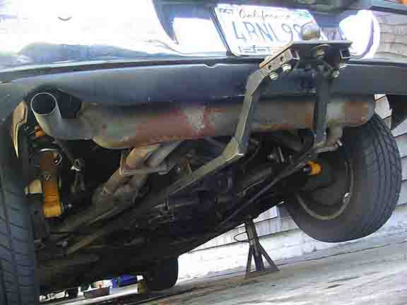

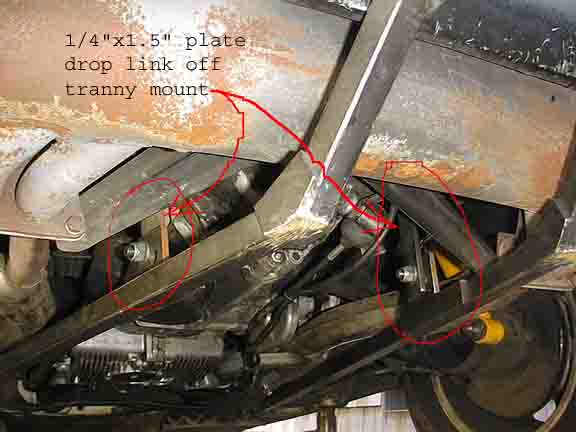

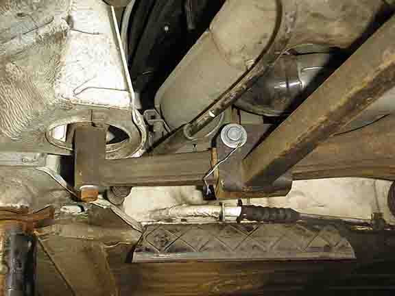

GaroldShaffer
post Nov 6 2008, 01:27 AM
You bought another 914?
Posts: 7,648
Joined: 27-June 03
From: Portage, IN
Member No.: 865

QUOTE(Garold Shaffer @ Nov 6 2008, 12:27 AM) *
Thanks, Garold! Your solution is even slicker than I had hoped. (IMG:style_emoticons/default/smilie_pokal.gif)
Looks like I'll be copying you - I hope that's OK.
Do you limit your towing to smaller trailers? Would you feel confident towing something bigger than what you have pictured? What would you guess is the tow weight limit? Any gotchas or advice?
That's a good-looking car you have, btw!

GaroldShaffer
post Nov 6 2008, 08:14 AM
Posts: 7,648
Joined: 27-June 03
From: Portage, IN
Member No.: 865
QUOTE(number6 @ Nov 5 2008, 11:55 PM) *
-duc
Thanks.
The trailer tows just fine behind me. As for a bigger trailer, well I guess it would be fine, but I don't know the limits. I can say with the little autocross trailer behind it I don't even know it is there. No real gotchas. Only thing I had was working out the wiring for the lights. Nothing major, just was in a rush and I couldn't get them to work until i fixed a ground issue.

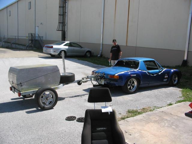

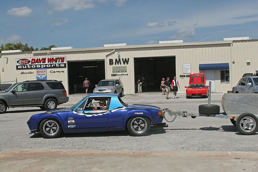

post Nov 7 2008, 08:30 AM
Racer from Birth
Posts: 133,158
Joined: 2-February 04
From: Tampa,FL
Member No.: 1,623
Duc, here is one of my former cars and my track-trailer (Jet- ski trailer modified, old Sears Aluminum roof-top carrier mounted, Porsche Cookie-Cutters) behind it. I never felt the trailer when I pulled it. My hitch was home made - cheesy compared to Garolds
T.C.

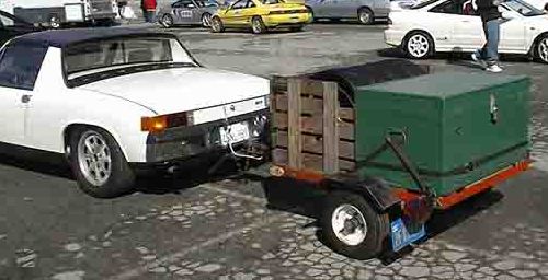

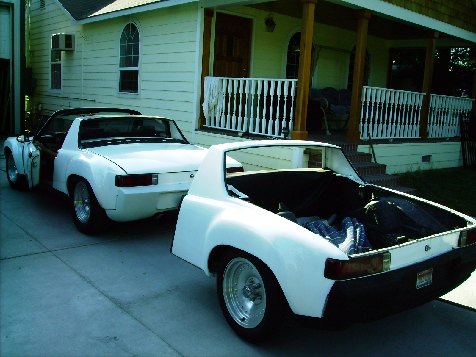

post Nov 7 2008, 09:40 AM
Posts: 9,264
Joined: 7-January 03
From: San Ramon CA
Member No.: 104
Here is another:
Attached Image Attached Image Attached Image Attached Image Attached Image Attached Image

post Nov 7 2008, 10:28 AM
Racer from Birth
Posts: 133,158
From: Tampa,FL
Member No.: 1,623
another shot
T.C.
