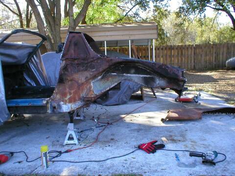

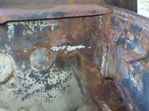

I've got the burnt 914 that needs the left rear fender removed and replaced. I have a parts car that has a good fender. I also want to replace the sail panel. How should I remove the fender? However you recommend, I'll use the exact same method for removing the parts car item. Once I remove the fender, I'll need to replace the door striker and some inner engine compartment sheet metal. Please be very specific and provide pics if possible. Thanks again for all of your help.

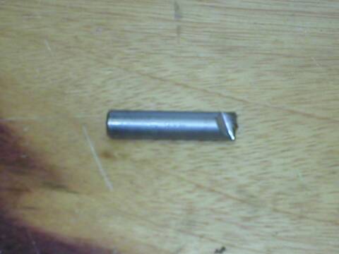

sj914   Looks like you got some 30 year old cheese in pic ...   Feb 17 2004, 03:32 AM
sj914   What does the B&D bullet drill bit look like?   Feb 17 2004, 03:33 AM

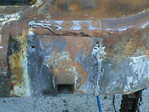

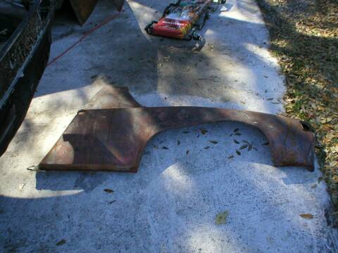

watsonrx13   Well, the removal of the left rear fender continue...   Feb 24 2004, 03:25 PM

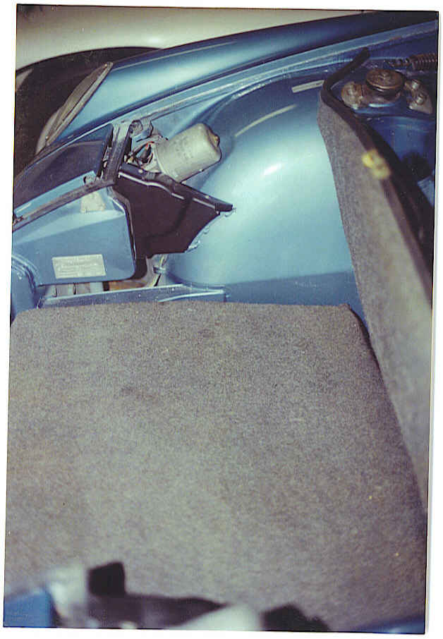

watsonrx13   Chris (Racer Chris) you mentioned that the air tub...   Feb 24 2004, 03:26 PM

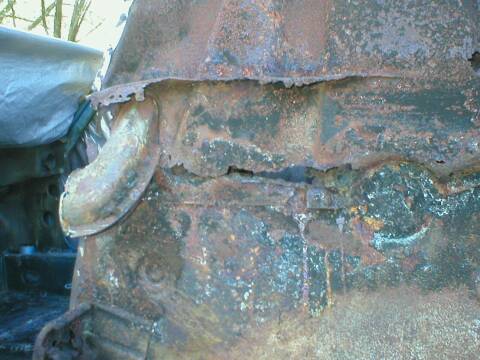

watsonrx13   The rear tail light housing has some previous repa...   Feb 24 2004, 03:26 PM
