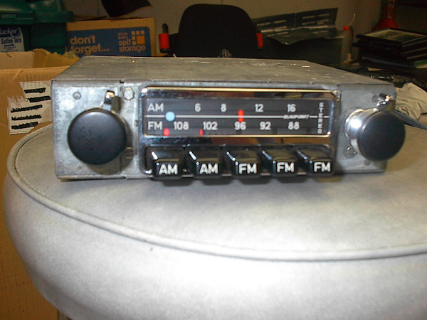

QUOTE(carr914 @ Dec 4 2008, 04:14 PM) *
My 1970 914-6 (#673) came from the factory with a Blaupunkt Frankfurt (USA)

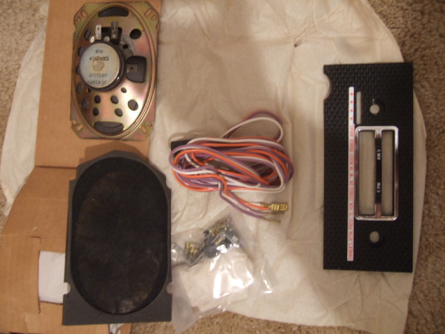

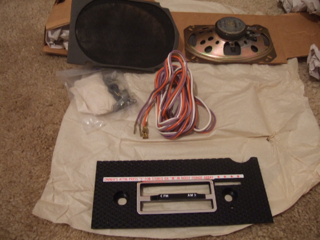

Was lucky enough to find a NOS radio installion kit on Ebay this past Summer. If you need any litterature scanned let me know.

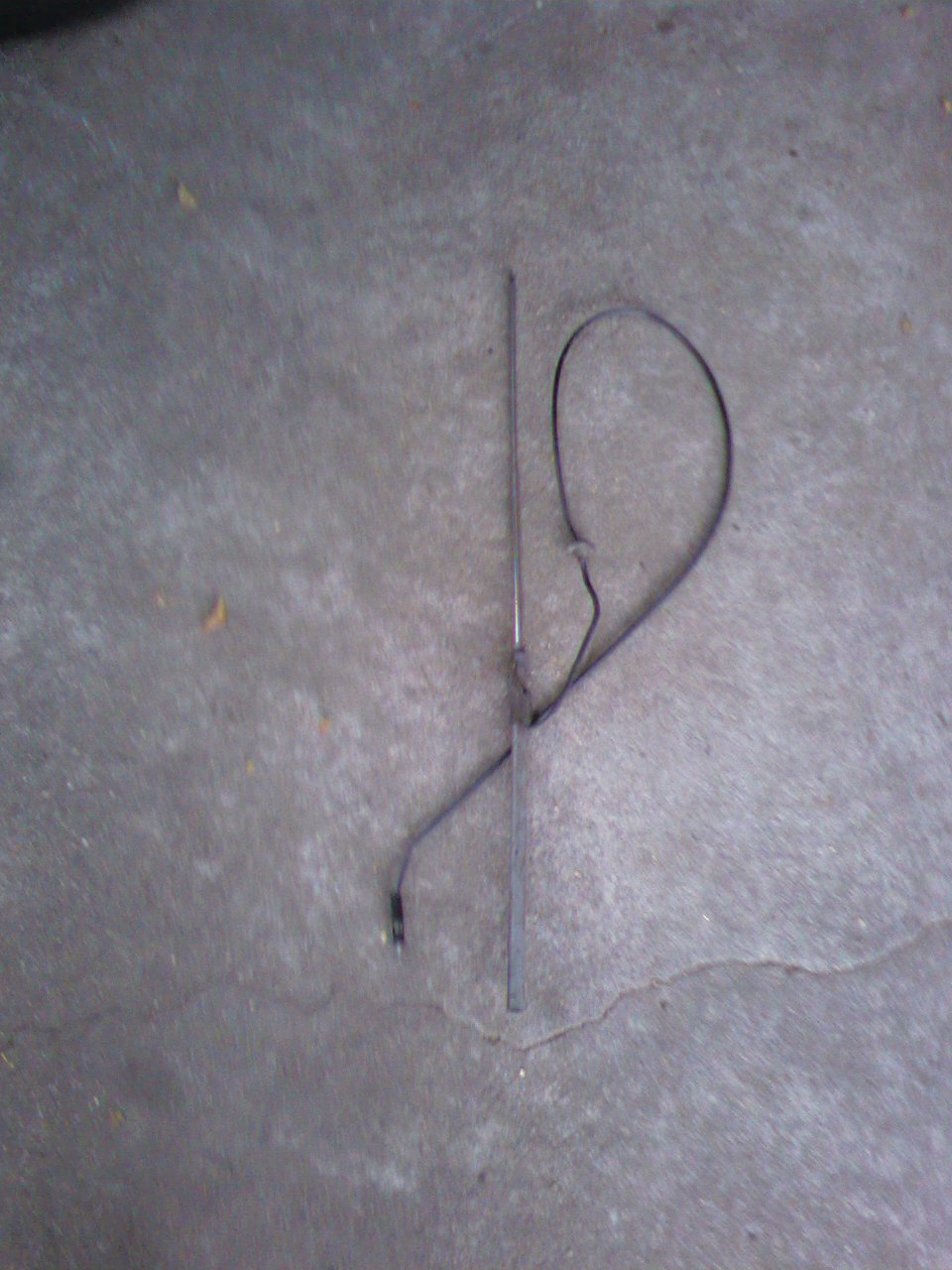

ooooooooh!! ... I wondered who got that one!
... but no antenna??
It should look like mine below with the narrow clip on a swivel to fit in the underside of the narrow radius of the 914 front fender (vs. wider 911/912 fenders, which had a wider clip IIRC), and the asymmetrical chrome trim dome over the top cap of the antenna base ...
BTW folks, to mount it properly, the chrome trim dome is made to adjust the antenna to sit vertically by having the deeper end of the asymmetrical bottom to the outside of the fender (i.e.: long part down & out to outer side of fender).
I've seen people mount them with that dome giving the antenna a rake rearward, which is not only incorrect for the 914s, but also risks having the lower receptacle below the fender into which the antenna retracts, get caught on your tires as you steer & break off &/or damage your fender sheetmetal!!!
