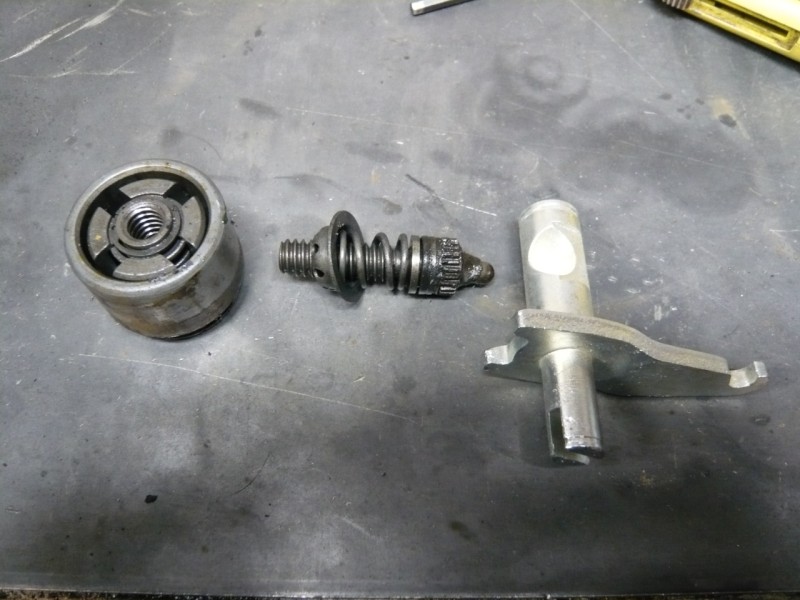

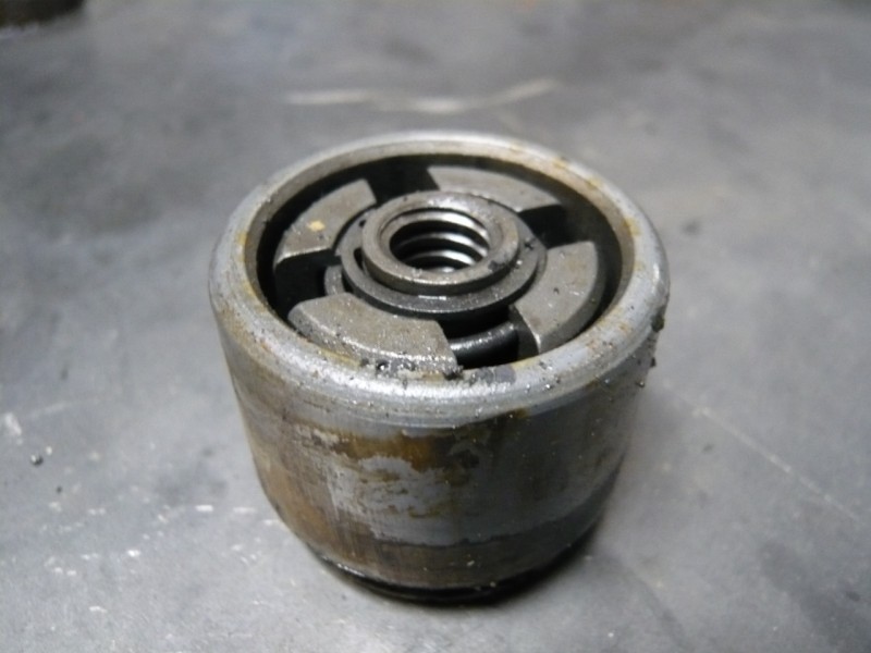

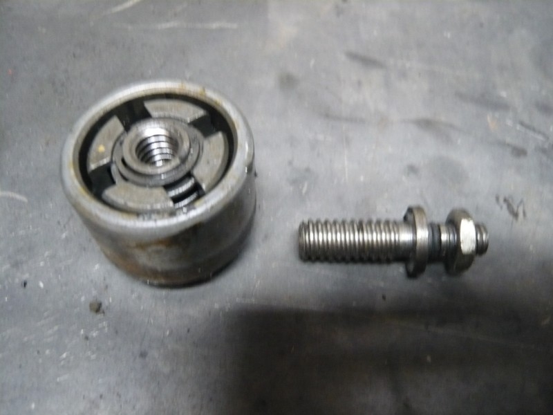

Let’s start with a bit of a lesson as to what these things are and why we need to adjust them. With the ATE IHB caliper there is no need for a separate drum brake system (E.G; the 911 system) to operate the hand brake or emergency brake. Here’s how it works; you pull the lever in the passenger’s compartment. The lever pulls on the cables. The cables pull the arms. The arms move the internal adjustment mechanism forcing the inside piston/pad against the rotor. If the venting clearance is set properly, this forces the rotor against the outside pad as well clamping the rotor securely between the pads. It’s that simple. Here’s a picture of the “chain” as it affects the inner piston on the caliper:
Because we are only utilizing one piston in this process, it is imperative that the adjusting clearance on both the inner and the outer piston be set properly and often. Here's the outer adjuster chain. A bit more simple than the inner setup:
In basic terms, the adjustment mechanism inside the piston simply allows the piston to be adjusted inward or outward while still performing it’s job as a brake caliper piston; apply fluid pressure… clamp rotors. The mechanism allows the piston to travel a good 4-5mm to do this job. Now… if your pads have worn, and you’ve never adjusted your venting clearance, your piston will travel to the furthest extension point and either be blown off its adjuster or (as in most cases herein) not work at all. By properly setting your venting clearances a couple of times per year you’ll help ensure your rear calipers are working. With working rear calipers you’ll stop faster and safer and you’ll have better times at the track. Here's a close up view of the internal adjuster mechanism as it sits in your piston. Imaging your piston moving up and down via this mechanism:

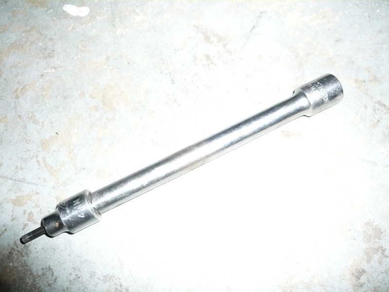

To properly set the venting clearance (as with any job) you’ll need to prep properly. Included herein are some basics meant to augment the factory manual. Here’s a list of some tools needed to perform this job:
o 4mm hex socket (or 4mm wrench long enough to go through the arm).
o 13mm socket
o Socket wrench or arm
o 6” socket extension
o Cold Chisel (possible/probable)
o Hammer (possible/probable)
o Feeler gauges in .004 or .008 sizes.
o Vise Grips
o 4mm hex wrench (simple)

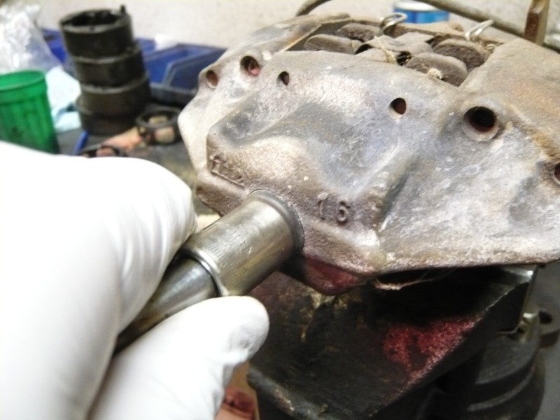

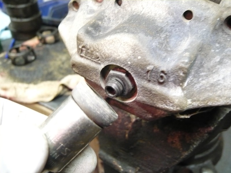

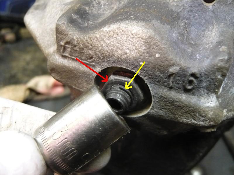

4. Remove the outer dust cover (if your car still has one) and unscrew the lock nut. Here's a shot of the outer dust cover being removed:
IMPORTANT – You MUST loosen this lock nut (red arrown in the following picture) to allow the outer adjuster to operate freely. Notice the clip on the adjuster shaft (yellow arrow). This is meant to hold the lock nut in place. Do not agressively hyper extend the 13mm lock nut past this clip, you just need to loosen it.:
Failure to loosen this lock nut prior to attempting to adjust the outer adjuster is the number one cause of stripped outer adjusters. If you strip your outer adjuster the caliper will need to be rebuilt and/or the adjuster replaced. These are very fragile at 4mm and you may find that the previous owner has already stripped the adjuster for you. That being the case, you may be able to salvage it by tapping the top of the adjuster with a hammer and form the top back into shape enough for the hex to bite.

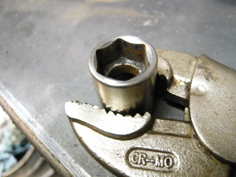

There is a “Special Tool” that is used to loosen and tighten this lock nut but I’ll show you the 914 guy CSOB version herein. I like to call it “Special Tool VG13MM”:
That’s right, take a 13mm socket and clamp it in a pair of Vise Grip pliers. This allows access to the inner adjuster via the 4mm hex through the opening in the socket. Once the lock nut is loosened you are now ready to adjust the gap.

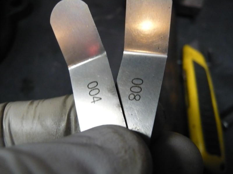

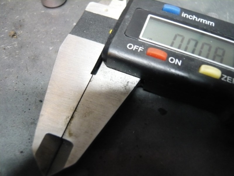

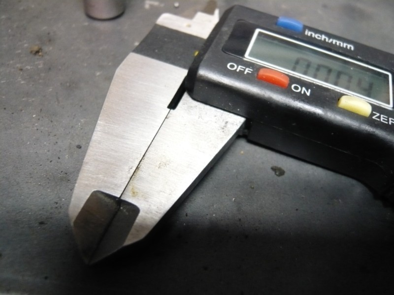

5. Look for the run-out or wobble in the rotor. They all have it, you’ll want to look for the high side and have that in your pad area while you adjust the clearance. I like to use a Sharpie and outline the caliper top and bottom on the rotor so the rotor stays in the same place as I adjust. Take a .004” feeler and put it between the outer pad and the rotor. Using a simple 4mm hex wrench adjust the clearance to .004” so there is light pressure on the gauge.:
Lets address this .004” and .008” debate that needlessly rains supreme on the Internet. The factory had originally printed a .008” spec in the Factory Manuals. All of the other (Haynes and Clymer) manuals picked up this spec. Since then they (the factory) changed the spec to .004”. The Alfa manuals spec at .01”. Does it matter? NO! You’re splitting hairs here… LITERALLY. The difference between .004 and .008 is the difference between a thin hair and a thick hair. A business card is .011”:
The problem doesn’t lie in .004 and .008”, it lays in what your pads are adjusted to now which is much greater than either of those two, I’m guessing!! (IMG:style_emoticons/default/biggrin.gif)
6. Remove the feeler gauge and rotate the rotor making sure you did adjust to the “high” spot on the rotor. There should be no binding as you rotate the rotor. If this checks out true, hold the adjuster with the 4mm hex and tighten the 13mm lock nut with our new “Special Tool” VG13MM.

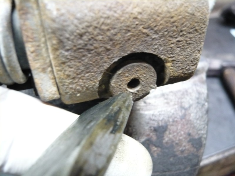

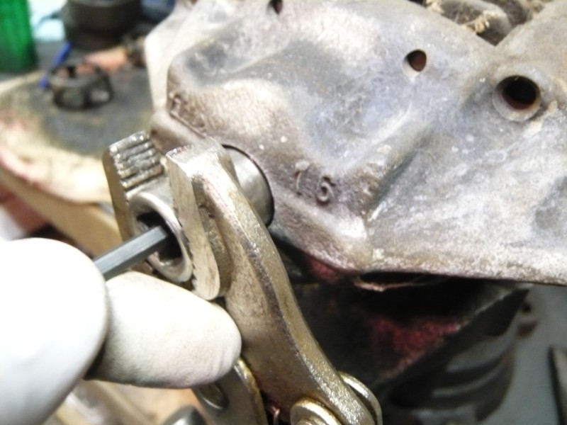

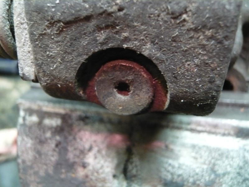

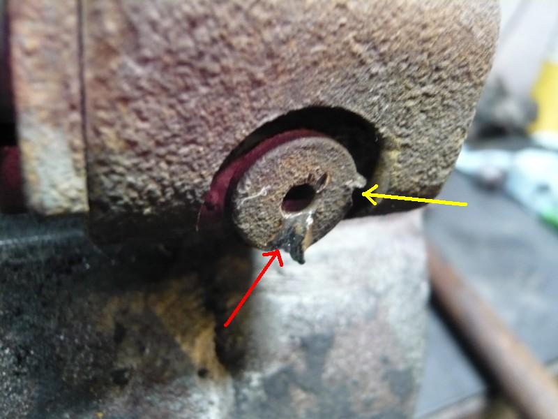

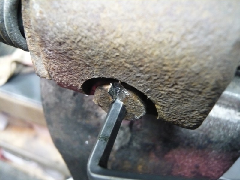

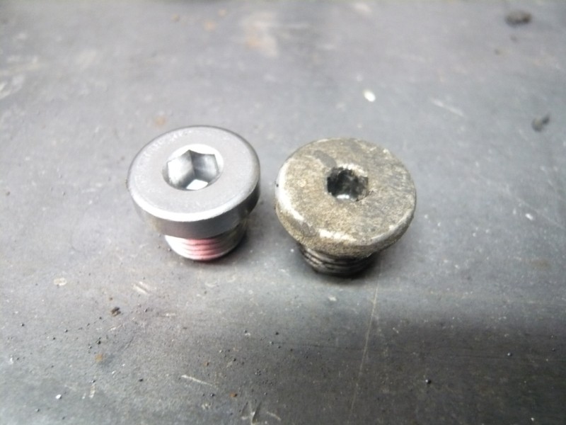

7. Move on to the inner adjuster. This is where the problems can arise. The number one problem with the inner adjuster is the cover that seals it from the elements. These have a 4mm hex head when new and the small hex and shallow depth of this hex fitting is in no way capable of overcoming the rust and grunge that builds up on the 10x1 thread engagement. Basically stating; the thread engagement is too much for the 4mm hex to overcome in “most” cases. Look at that pathetic little thing!:
What does this mean? A “stripped” 4mm hex and now you’re left wondering how you’ll ever be able to adjust your inner adjusters. To make matter worse; all of this needs to be accessed through that hole in your control arm. There is a solution for getting this cover off and there is a longer term fix. If you have a feel for these kind of things (and I don’t expect most of you to know when the breaking point is on a 4mm hex) you can tell if it’s going to come or not. If it’s tight STOP, especially if you’re not equipped with the “longer term fix” (which would be a new cover). You’ll need to use this piece again so let’s not bugger it up too badly. The best way to remove it is to use a cold chisel and turn it with the chisel and hammer:

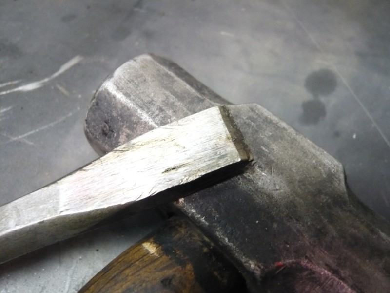

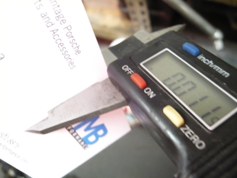

You will probably need to take the caliper off the mounts to do this but, here goes the procedure. Placing the chisel at the 8:00 position, angle it 45 degrees in the direction of desired movement. Sharp blows with the hammer and chisel will loosen the cover without further damaging the 4mm hex:
In this example you can see the force required to get these off sometimes (red arrow) and you can see that this has been done before (yellow arrow):
This allows you to reinstall the cover once you’re done adjusting the caliper. Insert the hex and spin off the cover:

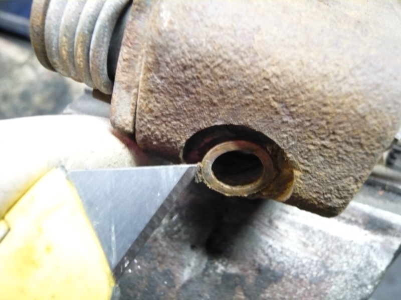

Once you get the cover off you can remove the copper washer with a utility knife:

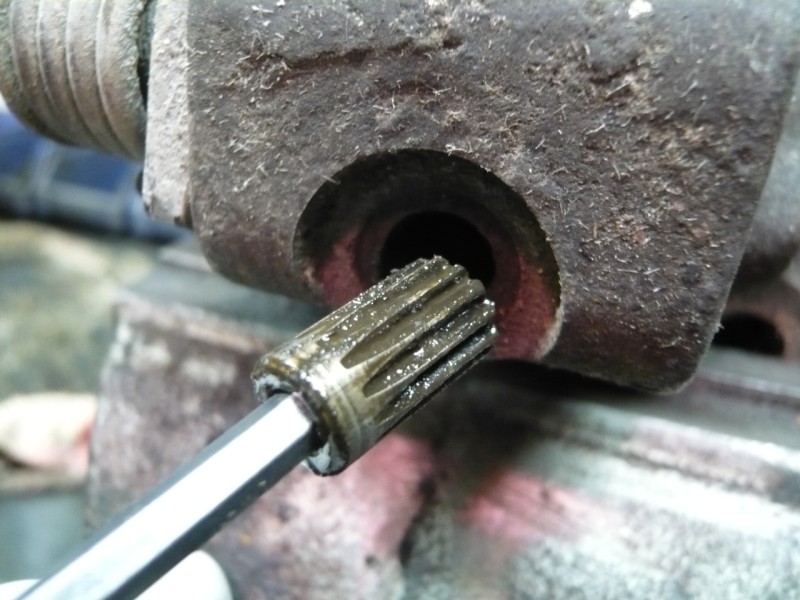

and access the inner adjuster gear:

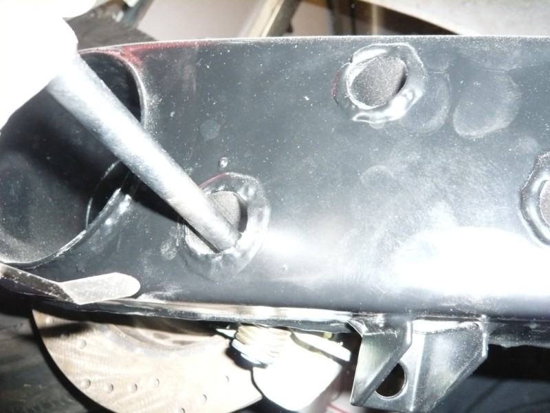

Lets clarify the use of gears and the direction of rotation upon adjusting the inner piston. The reason we need the above gear is the handbrake arm (in the first picture) is squarely in the way of direct contact with the inner adjuster. The way around this is to place a gear below the adjuster to drive it. Once something is gear driven the motion for adjusting is sent in the opposite direction so… what would be a counter clockwise move to get a piston to adjust out is now a clockwise move… make sense? As stated before; to properly adjust the inner pistons you need to go through the adjuster hole on the control arm. Once the cap is off you’ll take a 4mm hex socket on a 6” extension arm and adjust through the arm:
(pay no attention to the extra holes in the arms herein)
TIP: If you think your calipers are old, grungy and stuck, tap the handbrake arm inward with a hammer (watching not to hit too hard or go too far and shear off the stop pin for the arm). Do you remember how we described this hand brake arm mechanism earlier? Imagine it now breaking an old, grungy, fluid and rust bond by forcing the piston out toward the rotor. By tapping it you will force the piston loose and it will probably adjust properly (even though it probably needs a rebuild at this point). Make sure you are at that high spot on your run-out and adjust your inner pad to the .004” setting.

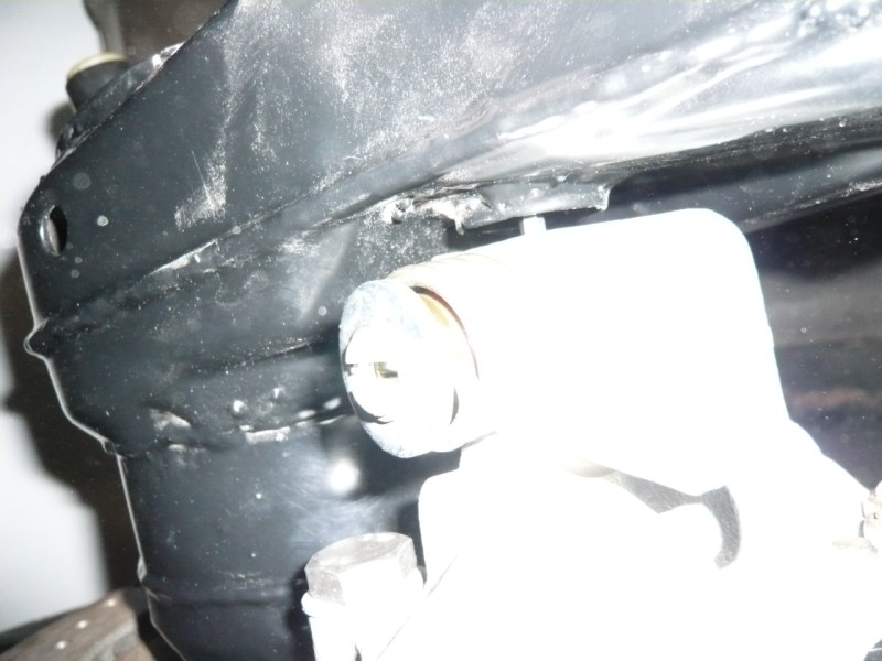

8. Double check the clearance on the run-out and reinstall the adjuster cover, leaving that gear right where you found it. If you did not find a gear in there you’re not alone. We stopped supplying gears as most cores came back missing a gear. Fear not. You can adjust both calipers with one gear. Check your other caliper for a gear and use it on both. Regarding the adjuster cover and the “fix”; we have sourced a plug that has the same 10x1 thread pattern and has the same look as the factory plug. It is much better because it has a 5mm “very deep” hex slot in it. The 5mm slot will overcome anything those 10x1 threads can throw at it and, with the extra depth, it has much more wrench engagement:
This is better than some of the other aftermarket plugs as it allows you to mount and dismount your calipers in normal fashion. The other aftermarket solutions are 10mm raised body plugs that stick out so far they do not allow you to mount your caliper to the arm with the plug on. You will need to remove that plug and reinstall it through the arms. Not a big deal but, when there’s a better solution, use it.

Thanks for this post. The special 13mm tool is shear genius!

For the "special tool" I've always used a Craftsman box end wrench without any problems.
Sometimes the boxed end wrenches just don't sit perfectly around the 13mm nut and they can round the edges of the nut. Either the size of the boxed end itself or the handle on the wrench will cause them not to always sit tight in that round cavity surrounding the nut. Sounds like you have one that works. That's why I like the solid grip of the 6-sided socket for this.
