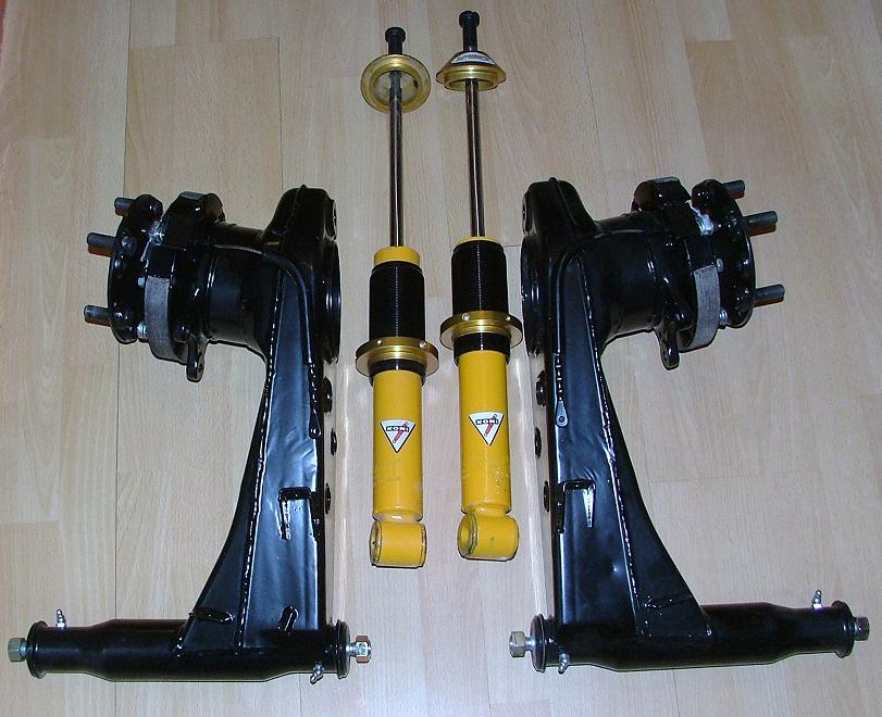

Been ordering a lot of parts lately. I got these reinforced rear control arms with
911 e-brake set up from Eric Shea a while back. They include Chris Foley's
e-brake cable extensions. They are just beautiful to look at.
I also got a set of Koni adjustable rear shocks with coil over perches.
The front struts also contain Koni adjustables, which are pretty shot. They
compress but don't spring back. I am thinking of having them rebuilt, I saw
a thread on here from someone about it, I think it was Eric Shea.

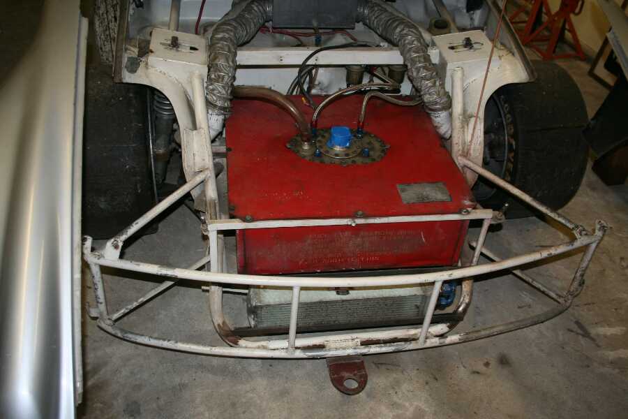

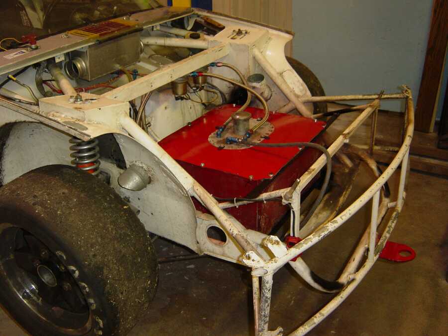

I went with a smaller fuel cell even though it is not the original, I do not need 22 gallons in a race and I was able to move it back 6" and lower it 4"
first picture 22 gallon fuel cell
second picture 12 gallon fuel cell

Glenn,
I am doing the same thing, getting a 10 gallon fuel cell and adding more bracing
to the front of the car. I am sticking with dual fuel pumps in the same location
as before with dual relays controlled from switches in the cockpit.
I am keeping all the original fiberglass fenders and buying new ones.

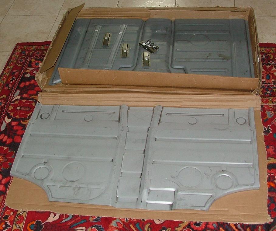

Got new restoration design floors, including the special they are doing now on
the rear floor, reinforcing tracks, and seat mounts. A great deal, I ordered 2
sets (1 for the red car). I think it took less than a week between ordering and
having them on my front door. (IMG:style_emoticons/default/piratenanner.gif) (IMG:style_emoticons/default/piratenanner.gif) (IMG:style_emoticons/default/piratenanner.gif)
Just gotta flip the car and weld these puppies in. (IMG:style_emoticons/default/welder.gif)
John

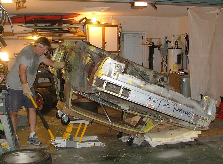

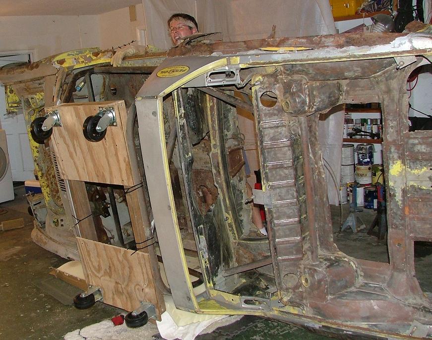

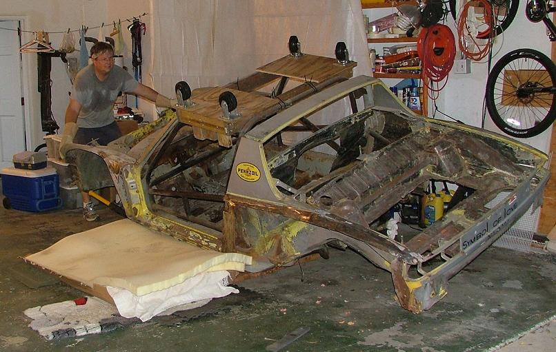

Flip Your 914 the CSOB - Redux
Front suspension mount points are toast so I could not rock this car on my 914
rocker. I had to flip it a different way to replace the floor pans. The car has a
solid roll cage in it which gave me an idea.
I wasn't sure the garage was wide enough to allow for a roll over. Some careful
calculations followed. Car is 150 CM high times pi (mmm pie!) um carry the two,
think about 69, oh f*ck it! Just push it over and see what happens!!! (IMG:style_emoticons/default/happy11.gif)
Just to make it look dramatic. Car is actually quite stable this way.
Catch it with an ATV jack. My wife actually helped with the whole thing.
FourBlades
post Nov 23 2010, 12:12 PM
Post #129
From Wreck to Rockin
Posts: 2,056
Joined: 3-December 07
From: Brevard, FL
Member No.: 8,414

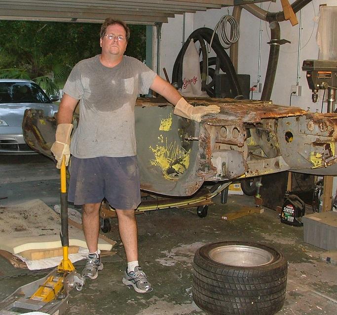

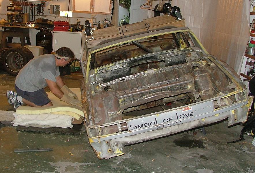

Gently lower the car down. Did not dent the side at all.
Best East Coast 914 Choppers glare.
Now the old floors can come out.
John

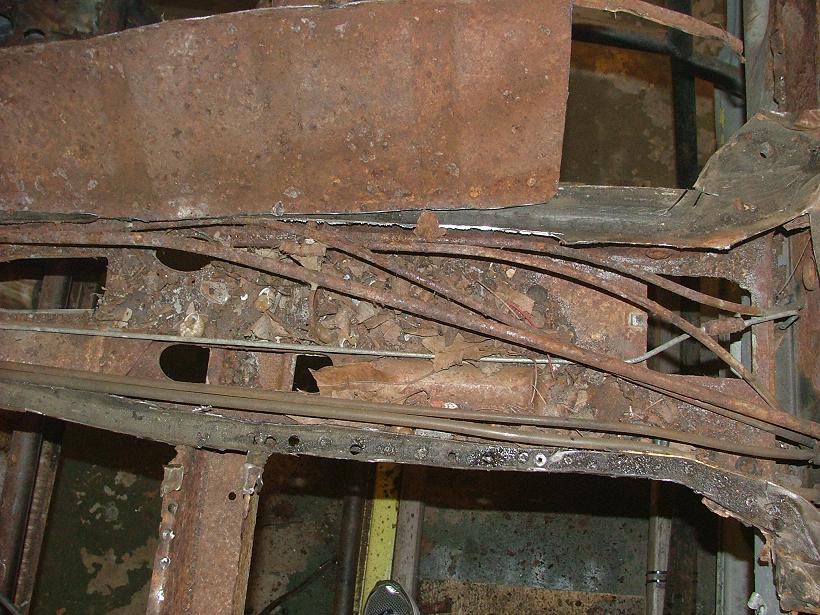

FourBlades
post Nov 23 2010, 12:21 PM
Post #130
Posts: 2,056
From: Brevard, FL
Member No.: 8,414

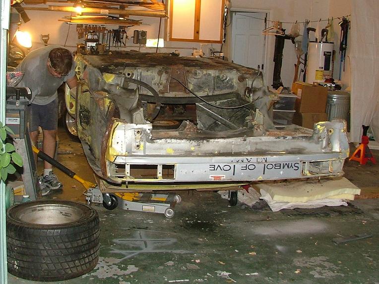

Let's open this tin can!
MMM, tasty!
A little cleanup, a few spot welds to drill out and I will make MUSR 2015.

carr914
post Nov 23 2010, 02:57 PM
Post #131
Racer from Birth
Posts: 134,827
Joined: 2-February 04
From: Tampa,FL
Member No.: 1,623
You are a Mad Dog !
I mean that in a good way (IMG:style_emoticons/default/smile.gif)
krazykonrad
post Nov 23 2010, 03:17 PM
Post #132
Posts: 1,181
Joined: 21-February 06
From: Canton, GA
Member No.: 5,610
Hope you can get it rolled back over when you're done! (IMG:style_emoticons/default/blink.gif)
Great post and great project! Best of luck! (IMG:style_emoticons/default/popcorn[1].gif)
Konrad

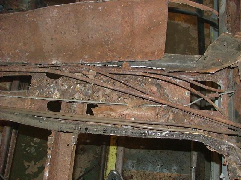

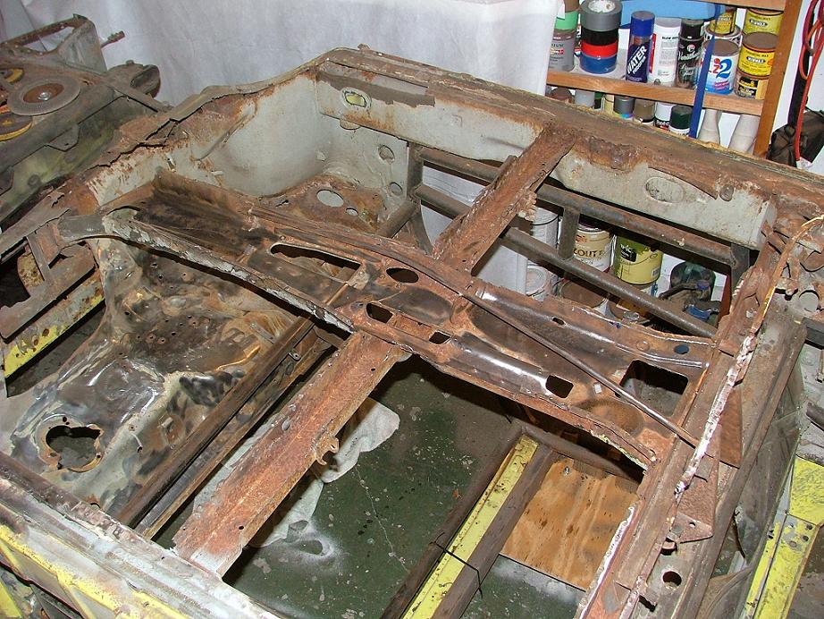

Drilled out the spot welds and removed the old floors. Had some help from Sean
and his friend Mike, which saved a lot of time.
Removed all the rusty tubes. The clutch tube is still in good shape. Will put a new
accelerator cable tube back in and weld up all the holes. Will reinforce the clutch
tube while I am in here.
Started cleaning the dash area which has lots of holes, rust and damage.
Much easier to get to this with the car upside down.
After the floors, still have to fix the hell hole, front trunk, and front fascia.
John

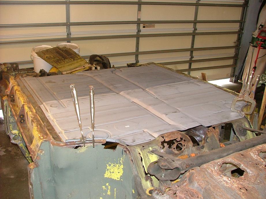

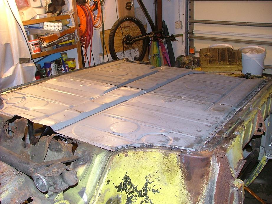

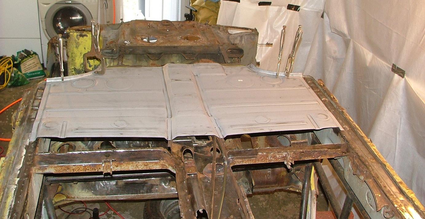

Test fitting the new floors.
You can see how rotten the front of the car is.
Floors are mostly welded in!
John

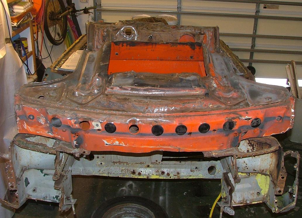

Here is the replacement piece that Terry (914xprs) cut off a parts car for me. He
had it to me less than a week after I talked to him about it, including shipping.
A good guy to work with.
It had a cut out for an air conditioner, which does not matter to me because I am
putting in a front oil cooler anyway. It will be fun surgically replacing the old stuff
with this. Terry also sent me a new headlight bucket to replace one which was
shot.
I will need to build some kind of jig to preserve the suspension mounting point
positions when I remove the front floor. I wanted to replace the floors first to
have something solid to weld the jig to.
John
