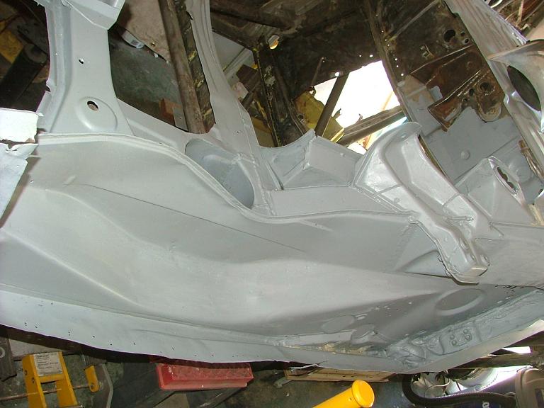

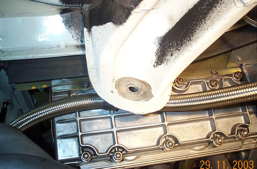

When I spoke of grinding your welds smooth this is an example of what I meant.
The rear wheel/axle arch is an often cracked area. You want to avoid "kerfs"....notches on the edges which concentrate stress. Smooth/faired welds are the cat's ass.
FourBlades
post Feb 13 2011, 08:16 PM
Post #202
From Wreck to Rockin
Posts: 2,056
Joined: 3-December 07
From: Brevard, FL
Member No.: 8,414
JP,
That looks nice and neat. I have been working towards that. Seam weld, sand,
go back and fill in any notches or porous welds. Repeat.
I finally started priming stuff to keep it from rusting while I work, but I know
I have more cleaning up to do.
John
J P Stein
post Feb 14 2011, 10:01 AM
Post #203
Irrelevant old fart
Posts: 8,797
From: Vancouver, WA
Member No.: 45
Sorry if I jumped ahead too much..... the primer kinda threw me.
I used a rattle can etch primer made by RM for spot work. It is compatible with any build primer/topcoat I threw at it.
At any rate, a picture is worth a thousand wurds. Here's an ear. I coud have done a better job of it, I guess, but geting out from underneath the SOB became a higher priority.

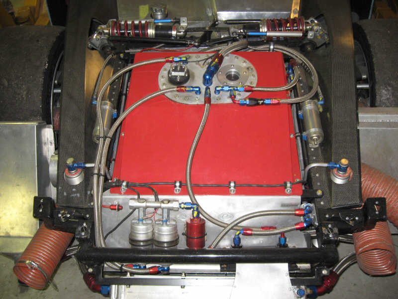

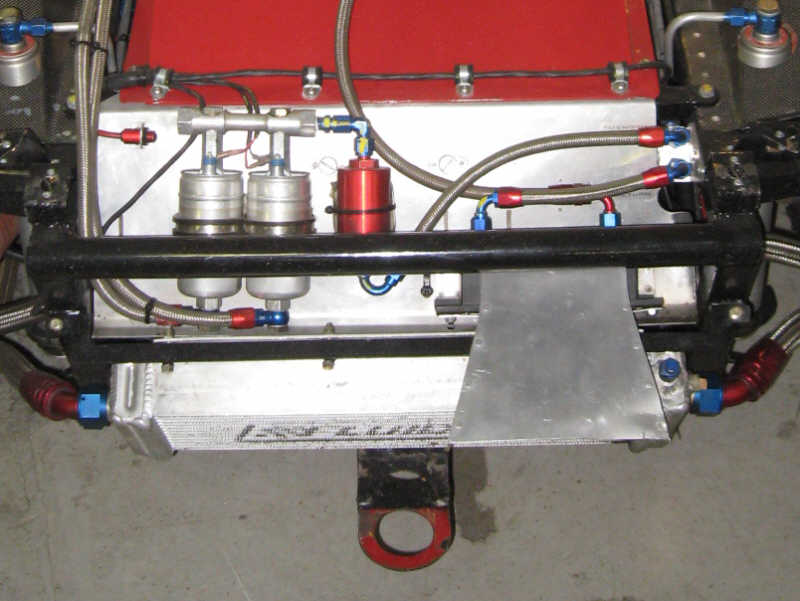

ChrisFoley
post Mar 3 2011, 10:19 PM
Post #205
I am Tangerine Racing
Posts: 8,032
Joined: 29-January 03
From: Bolton, CT
Member No.: 209
John,
Here's an example of a redundant fuel system for you to look at for ideas:
Note the duct to a fuel cooler on the right

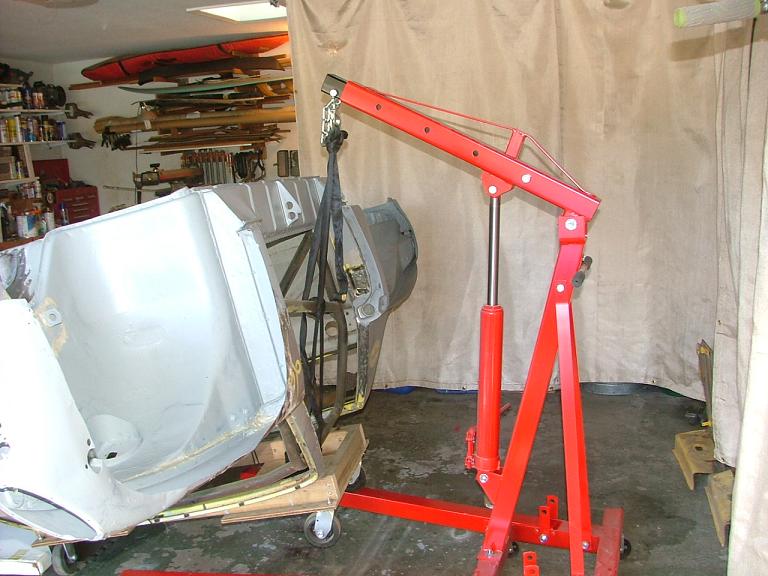

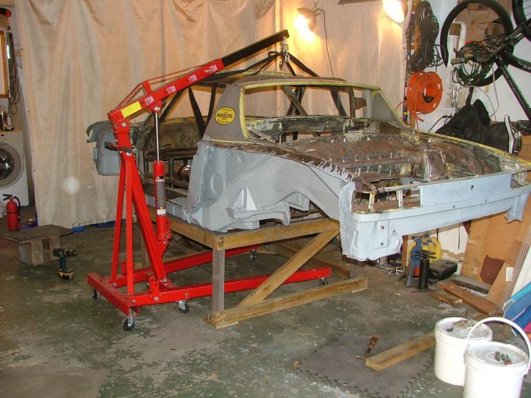

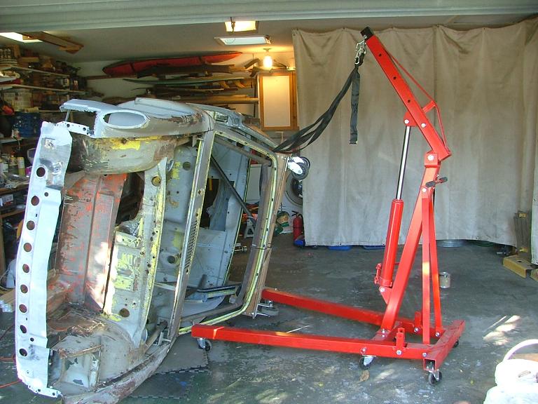

post Mar 24 2011, 02:55 PM
Post #209
Posts: 2,056
From: Brevard, FL
Member No.: 8,414
I think I see a black 914 in that video and maybe a silver one.
I finished seam welding and cleaning up the longs.
Reflipped the car the easy way using an engine hoist.
No drama this way.
John
gms
post Mar 24 2011, 03:09 PM
Post #210
Posts: 2,755
Joined: 12-March 04
From: Chicagoland
Member No.: 1,785
It is amazing how just a coat of primer makes the car look so much better
Great Job!
