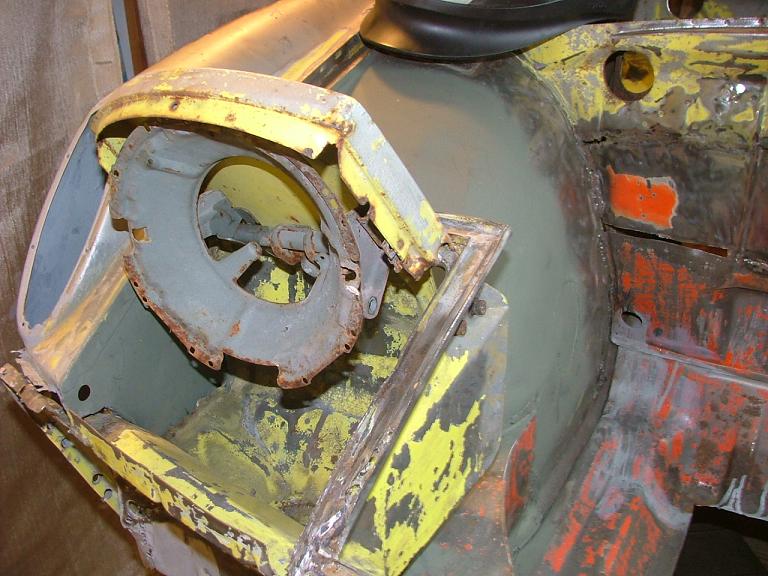

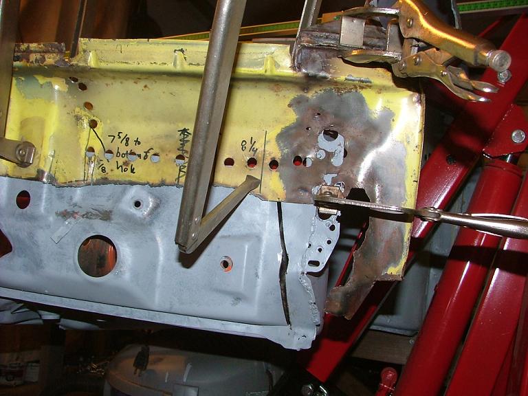

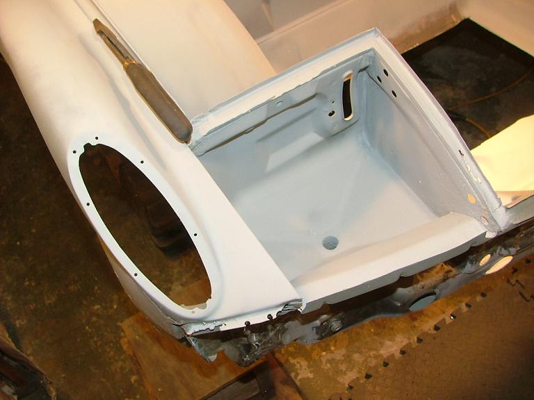

Been working for several weeks to rebuild the front end of the car.
The front fascia only comes up about half way and both head light buckets are
rusted badly.
I have replacements that Thomas sent to me I will use to fix this.

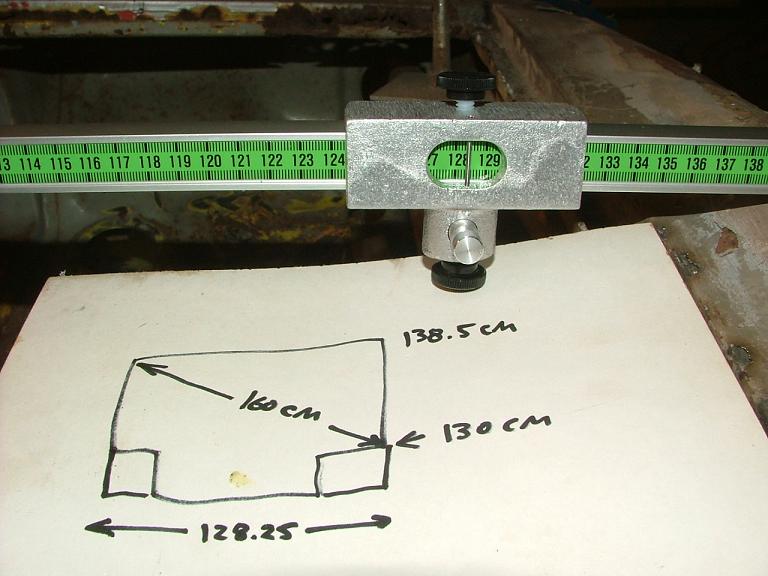

Somehow I can't get the new section to fit the car. It is like it is too wide to fit
between the fenders. Took some measurements on my other 914s for comparison.
No wonder, this car is 2.5 cm narrower than it should be, it is 125.75 cm across
at the very front.

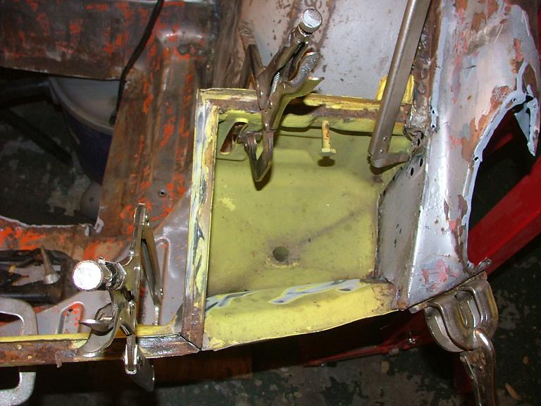

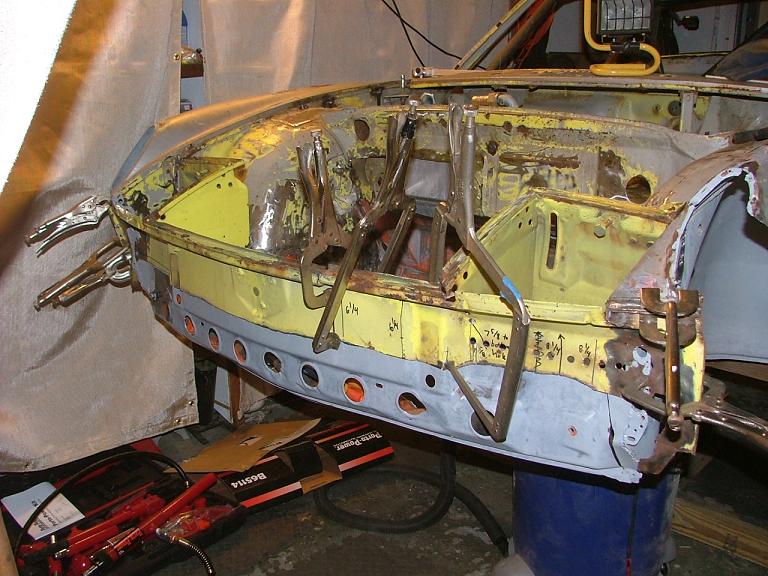

Get out the porta power and start pushing it back into shape.
Push it, check it, push it, check it. Get frustrated by the spring back and really
crank it. Needed to cut through the fascia to the proper fit and bending. Push it
and now it stays where it should. Checked the diagonals and widths. Hammer
it here and there to shape it right.
Try fitting the pieces again.
Now everything fits well.
Nothing like a 4 ton hydraulic ram to ensure cooperation.
John
FourBlades
post Apr 22 2011, 11:05 AM
Post #223
From Wreck to Rockin
Posts: 2,056
Joined: 3-December 07
From: Brevard, FL
Member No.: 8,414

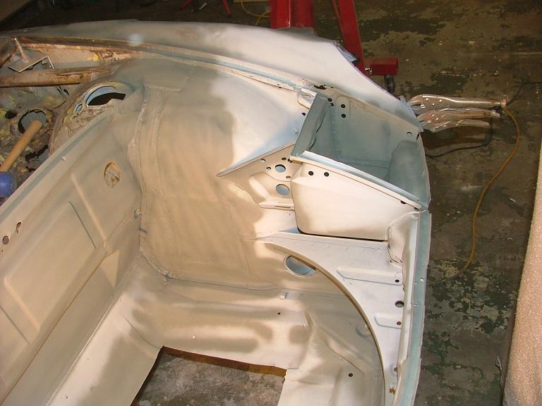

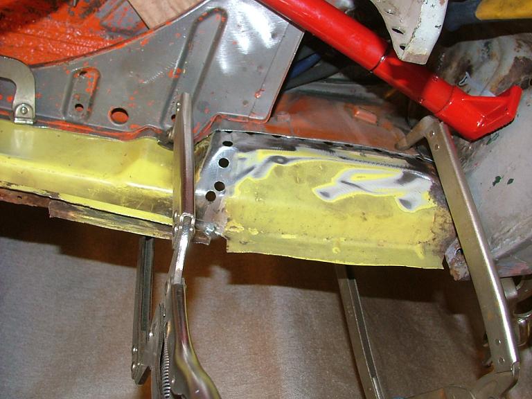

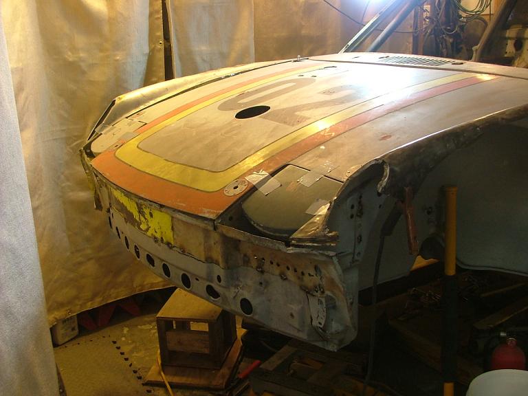

Tack weld the pieces on and check the fit with the hood. The hood fits well except
where they must have reshaped it to make up for the pushed in driver side. The
driver side fender was replace at some point by brazing on a piece from a green
car.
Check the fit of the headlights and covers.
It all fits decent. The gaps are a little big but it is good enough for a race that
has been wrecked multiple times.
Fully welded it a few inches at a time by cutting through the overlapping pieces
and filling in the kerf.
Clean it up and prime it. I ran out of one color of rattle can self etch and started
in with another color part way through.
Starting to look pretty good.
This was a pretty major effort to reconstruct but I am happy with how it turned
out.
John

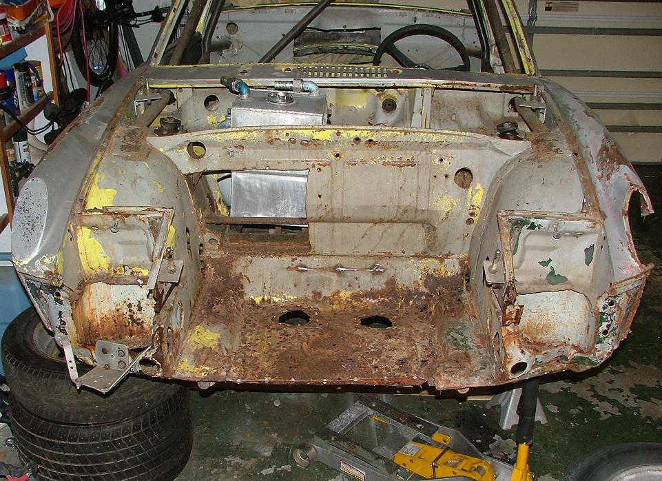

Ha ha remember what I started with:
Gives me the willies to remember that.
John

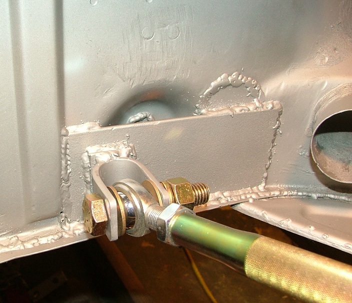

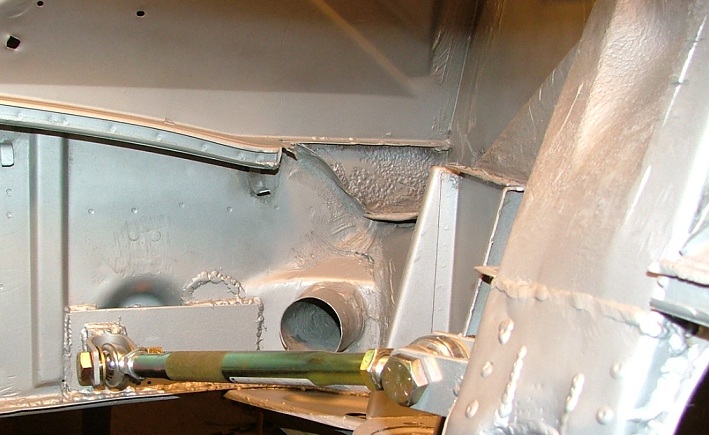

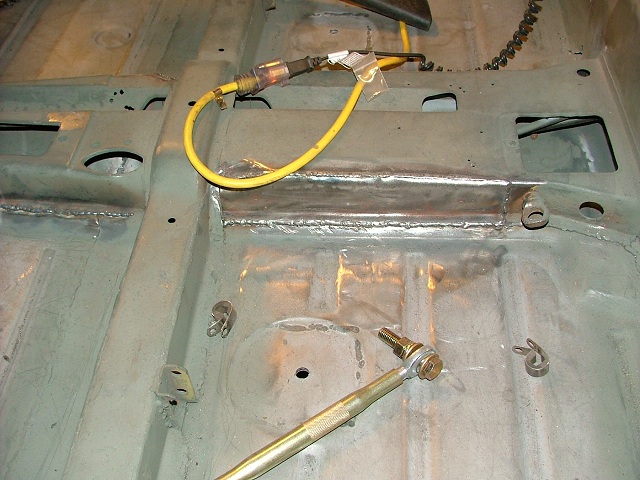

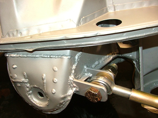

Been working on finishing up the engine bay. Welded on Tangerine Racing rear
suspension ear reinforcement plates and made some removable chassis braces.
The longs were cracked on the outside around the suspension points so this
should help stabilize them.
Those are 1/8 plates welded on the firewall. I put the attachment point down low
where the floor pan helps reinforce the firewall.
I added some 16 gauge plating to the top and bottom of the suspension mounting
point where the brace attaches. I am missing a jam nut on this brace.
I've got some smaller heim joints and tubes to build reinforcements for the carrier
on the other end of the suspension mounting point. That should help stabilize the
other end of the rear arm and keep the toe in from changing.
John

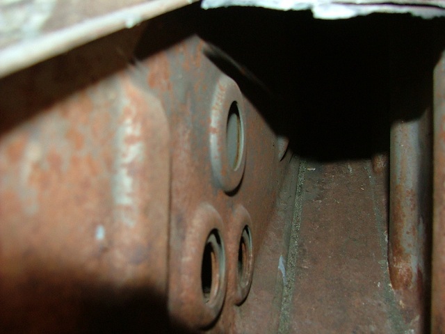

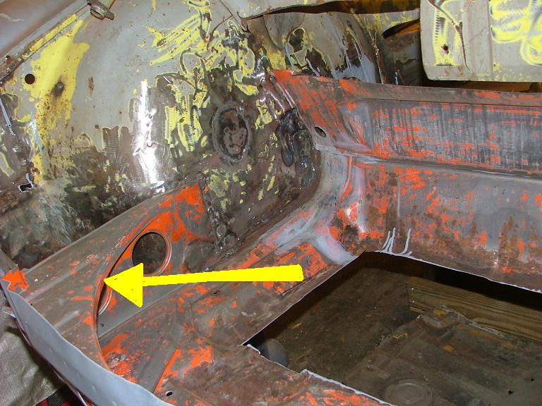

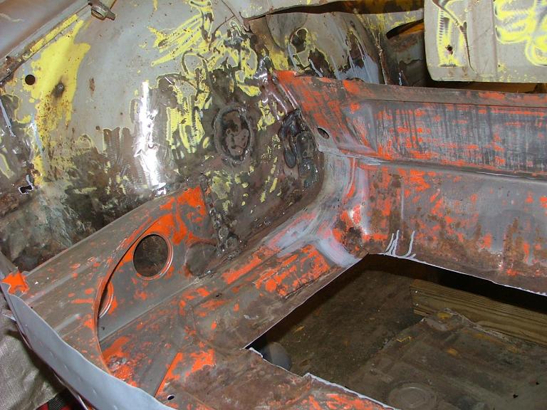

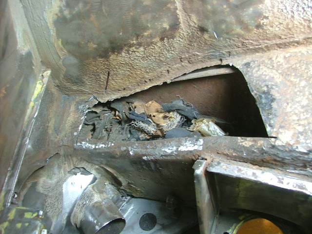

Cut out the rusty hell hole.
Some cool rat parties went down inside this race car.
Cleaned out the rat pad using latex gloves which were promptly tossed.
Took some recon photos of the inside.
Does not look too bad actually.
This will get treated and painted before sealing it back up.
John

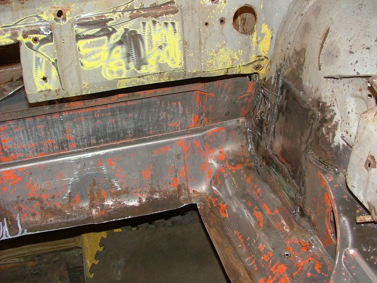

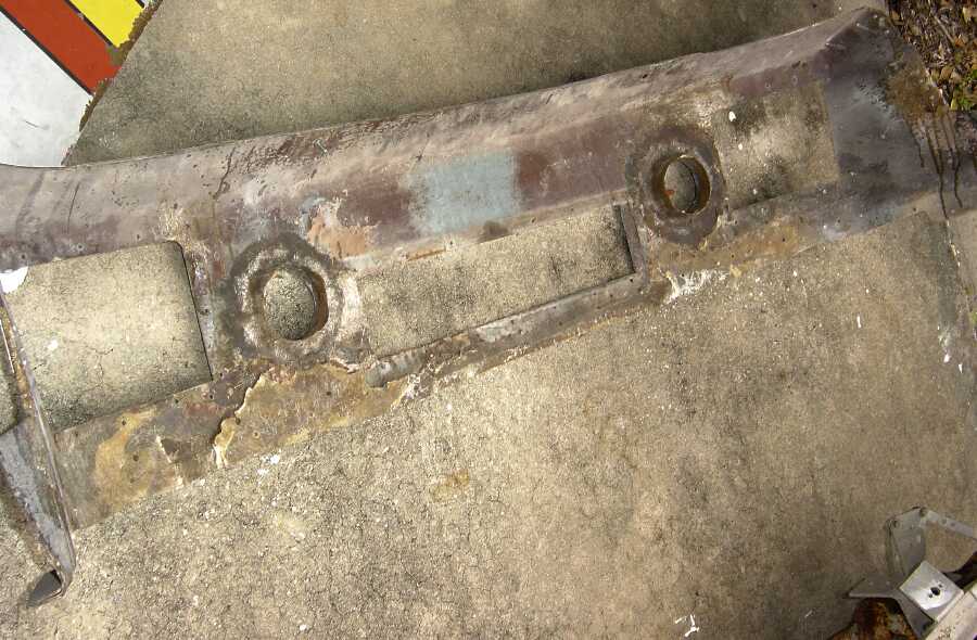

Been working on the tunnel and cross brace. Basically all the metal within an inch
of the floor is completely rusted away. Cut this all back to solid metal and patched
in new pieces.
I thought about trying to get a perfect tunnel from a donor and buy new, repro
cross braces and inner firewall pieces. I could have made the interior look close
to brand new stock but the guys who built this car originally would never have
done that. I plan to just have a bare metal, painted interior where all the welded
panels will show. I could try to grind all the welds smooth, but again, that was
never what the original builders did.
They did race the car with factory sound deadening tar in place. That all went with
the old floor pan and it got stripped off the tunnel. I wonder why they did not
bother with that obvious and easy weight reduction?
Should I replace the factory tar to be closer to how it was in the day? I have no
idea but I am leaning towards no.

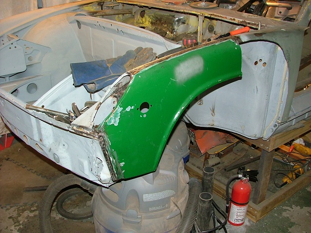

Welded on a new fender to replace the trashed one. Terry (914xprs) supplied
this cherry piece for me.
John
