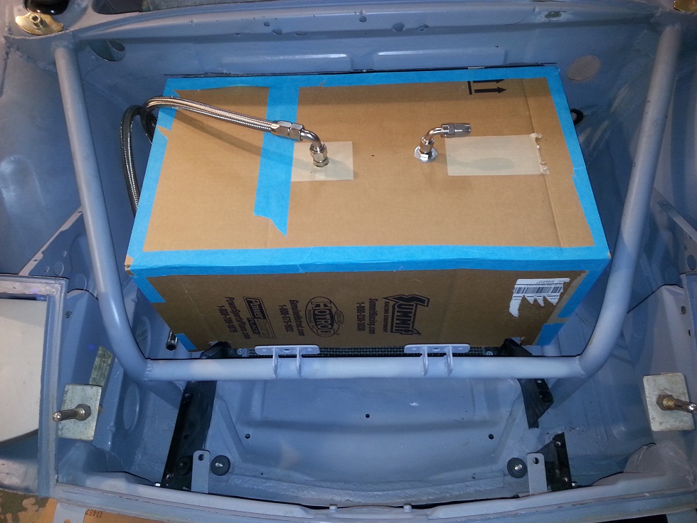

Doing some measuring it looks like I could fit a 4 inch wider and 2 inch taller cell with minimal teeth gnashing and hair pulling. That would give around 16.8 gallons minus some because I would order 2 corner surge tanks with doors in each back corner. So probably 15 usable gallons before you risk sucking air. Or maybe use TCs mat if they make a twin pickup version and get even more useable fuel.
Assuming 8 miles to the gallon that is 120 miles on track or 32 laps at Sebring, which would take 75 minutes at 2 minute 20 second laps. I would probably be ready for a beer after 75 minutes anyway. Do these calculations seem correct?
If that was not enough I could also add a swirl pot, although I can't find any 3 gallon ones like Dave suggested.
Give me some ideas and feedback here people.
John

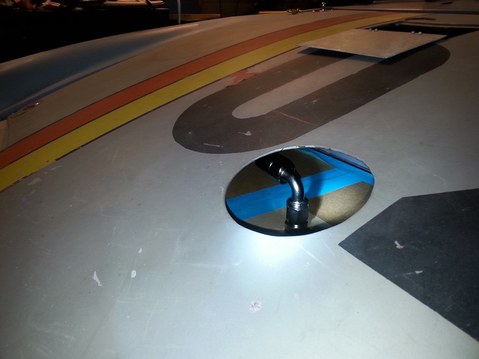

Made a low tech mock up of a 16.8 gallon tank. It is 2 inches taller and 4 inches wider than the old one. I can move it back 1 more inch with some more bulkhead cutting and then the fuel pumps will still fit. I will also have to trim the oil cooler shroud. There will be a 1 inch lip around the top holding the top on which I have measured for and still fits. The front edge of the tank clears the hood by 1 inch or more. Don't want to cut it too close.
The tallest attachment is the vent fitting. It still clears the hood with 2 inches to spare.
It looks like this would work. Now to see how much $$$$ the fuel cell makers want for a custom size. I will also ask if they are aware of the Holley Hydramat.
John

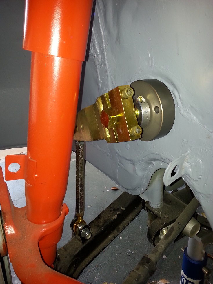

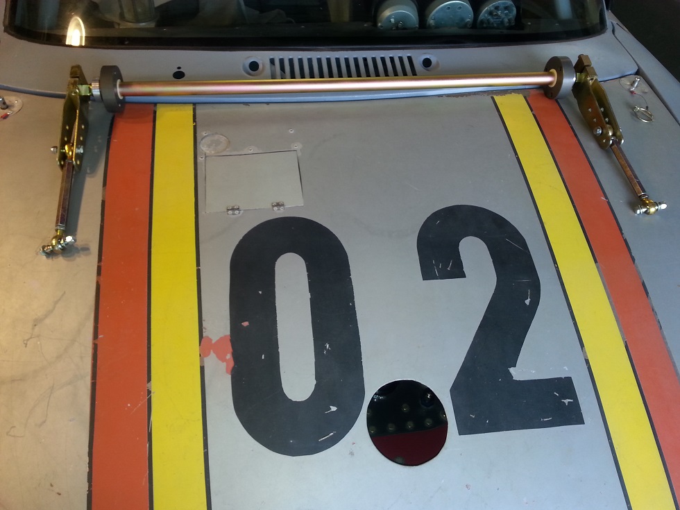

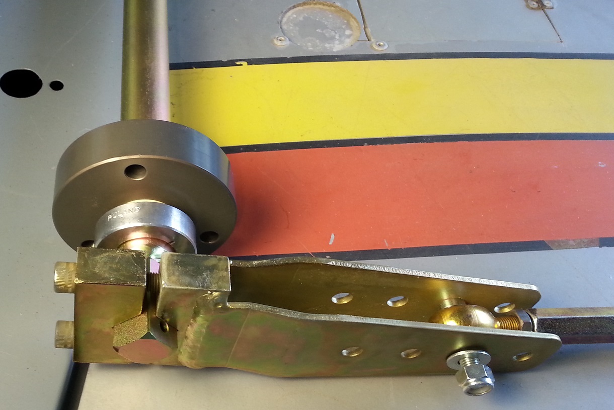

Big thanks to Brian Boss from German Parts and Restoration www.gprparts.com !
He took the initiative to contact me after I posted a thread looking for a vintage looking anti-roll bar. I wanted a large bar that would work with the car's original and fairly unusual arms and drop links. I did not want one all red or blue anodized parts that would not look 70s.
Brian pointed out the RSR bar made by Tarret Engineering had a vintage look. He was able to work with Tarret to get me just the bar and bearing blocks for a fraction of what the whole RSR kit would cost. Finding the right parts takes an incredible amount of time on a project like this so it is really nice to have informed help from a vendor! Thanks also to Tarret for agreeing to package this! (IMG:style_emoticons/default/first.gif)
So here is some anti-roll bar porn:
The RSR bar is beautifully made and plated and the bearings are anodized in grey.
I zinc plated and chromated the original arms using a Caswell Plating kit and got new rod ends and hardware for the drop links.
On the car:
Thanks again Brian!
John

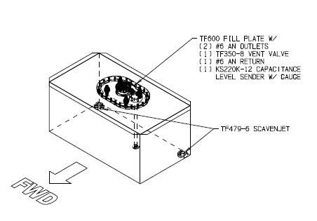

Custom 15 gallon ATL fuel cell ordered. I was pleasantly surprised to find this was only a few hundred dollars more than a stock size fuel cell would have been. ATL said that getting a rectangular cell made was not that time consuming thus not much more expensive. Their people were super helpful. I got two pickups in opposite back corners to avoid fuel starvation.
Should be here in a couple weeks.
Pyrotect had an even lower quote for a custom cell with the same fixings. I would have picked them but the car originally had an ATL cell. Never knew much about Pyrotect before now but they have some good products at very good prices.
John

Your sway bar arms look like the arms provided in the H&H sway bar kits. I have H&H bars on my car, purchased and installed around 1980, and the arms are practically identical, except the Cad plating on mine has long deteriorated. Your installation looks great.
FourBlades
post Jun 5 2015, 08:12 AM
Post #492
From Wreck to Rockin
Posts: 2,056
Joined: 3-December 07
From: Brevard, FL
Member No.: 8,414
Thanks Mike. I've been wondering who made it.
John
Are you running 2 pumps? If not, you might still suck in an air bubble on a hard corner if running through a T fitting to a single pump.
FourBlades
post Jun 5 2015, 09:37 PM
Post #495
Posts: 2,056
From: Brevard, FL
Member No.: 8,414
I am running two pumps and would plan to run both at all times.
The car will be carbureted which helps a little because the bowls store some fuel.
John
