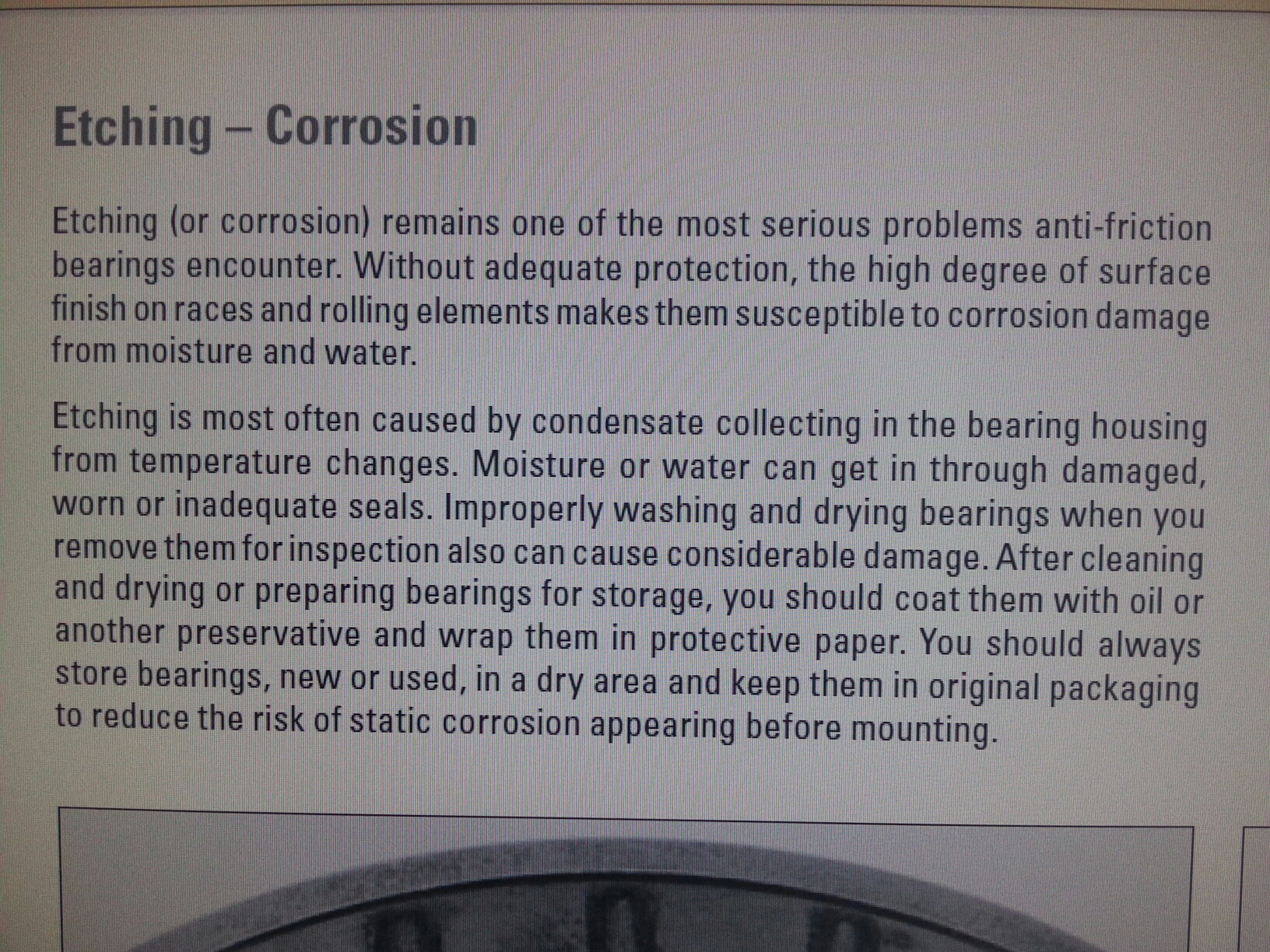

I see frosty balls in the first few pictures ..those are shot , and I would never have rebuilt a CV with them..premature failure is immanent! ...good bearings are mirror shiney
and im not trying to bash anyone ...just the facts

QUOTE(6freak @ Feb 18 2016, 01:12 PM) *
What the fuck are you talking about?....hey wait a minute (IMG:style_emoticons/default/dry.gif) Keep your comments about my Canadian testicles out of this topic (IMG:style_emoticons/default/stick.gif)

Pardon me the proper term is Etching...around here we always called them frosty

Member No.: 8,829
I mentioned it a few years back about the condinsation in bearings and it causing microscopic explosions because you cant compress water...someone asked what i was smoken haha...i dont think they believed me ,but its true

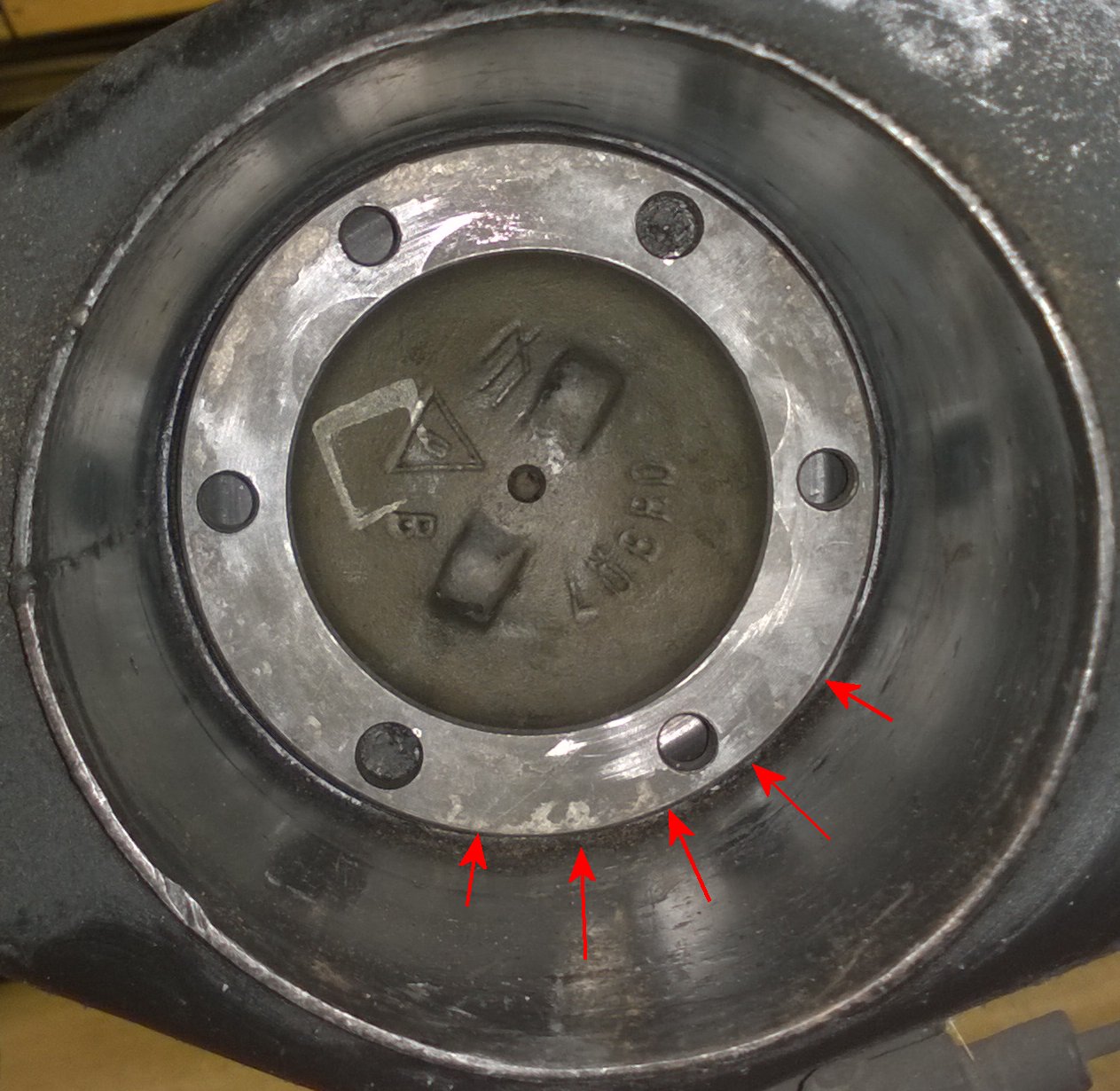

Hang on a second though, I don't think this is my problem. The 911 hub to stub axle width dimension I measure where it slips into the bearing is 37mm like it should be.
The problem I have is that the 108mm diameter is rubbing on the inside of the 914 control arm. The cause may be my 911 handbrake. I fabbed and welded a bellcrank to the bottom of the control arm. The heat added was just enough to distort the metal and cause the contact. A dremel and a few mini sanding drums and a mirror was all it took to get the clearance needed. The concern now is how much does the hub expand once it all warms up. That just might suck. (IMG:style_emoticons/default/dry.gif)
Also, in rebuilding the CV joint boots, the Oetikers that Pelican stocks are roughly 74mm which don't fit the boot plates I have, even when fully crimped. With the boots installed, mine measure about 66.5mm. Apparently, there was a change some time in the early 70's to the larger 74mm. I found 2-3/4" (71mm) Oetikers at MSCDirect and they upgraded my shipping to Next Day UPS. http://www.mscdirect.com/product/details/48549729
The inner boot location measures about 33mm so a 1-3/8" Oetiker (34.6mm) should work http://www.mscdirect.com/product/details/48549364

That sucks. And tough to get in there to grind some metal off. (IMG:style_emoticons/default/ar15.gif)
