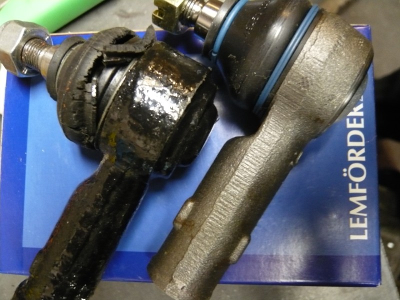

Quite a few years back a friend of mine happened upon some off brand turbo tie rods on eBay. They were $80 a set which was hard to pass up.
The following started to happen about 2 months after installing them. They are shown beside their Lemförder replacements for reference.

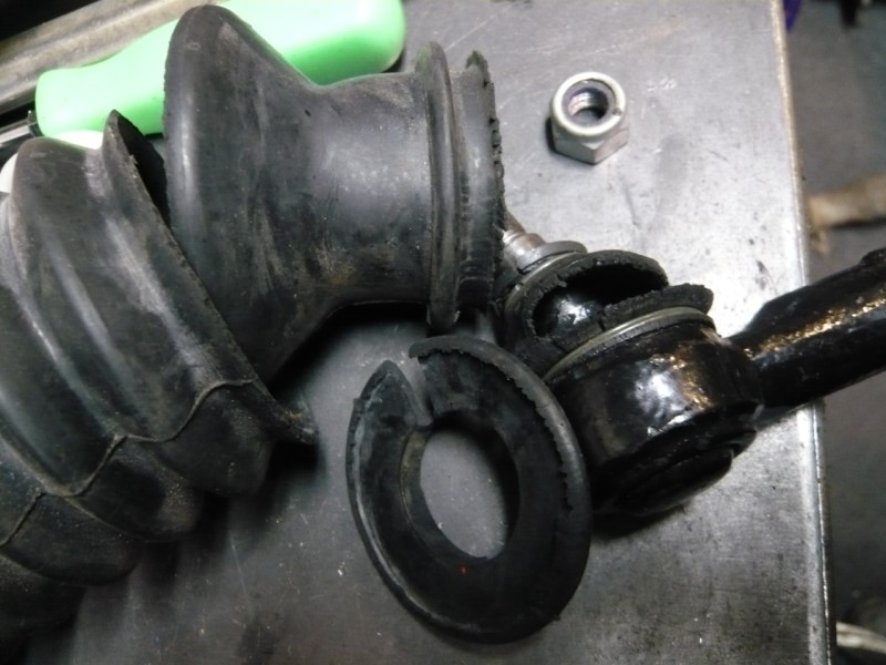

It's fairly obvious that the rubber was missing a key element of ozone protection (antiozonates). This is what everyone means when they attempt to steer you away from cheap turbo tie rod alternatives.
These were never in use...
Even the new boots that came with the kit were trashed.
Lemförder turbo tie rod ends = $40.00 each
New Boots = $10 each
Total cost for El Cheapo kit = $180.00 plus shipping of new parts ($190ish?)
New Lemförder kit, complete $188.00
Great deal... (IMG:style_emoticons/default/dry.gif)

I second that! Those cheapo ones are complete crap. I had the same exact experience, within 2mo of install they looked as old as the car was (IMG:style_emoticons/default/dry.gif) Not worth it at all.
