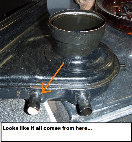

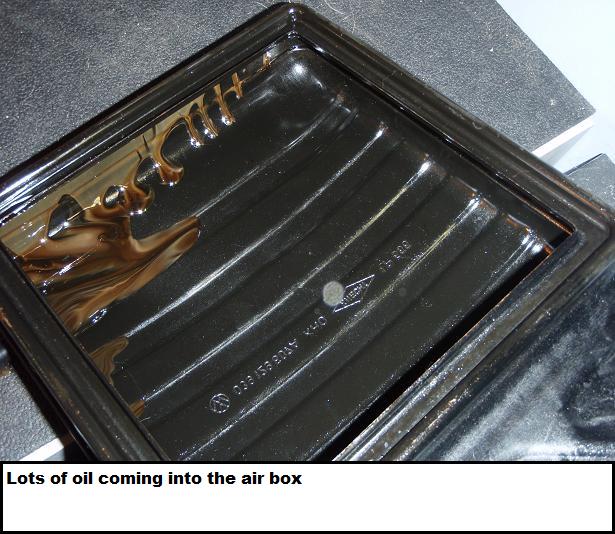

take a look guys, by the way I did get her home the other night, and i beat the snow.

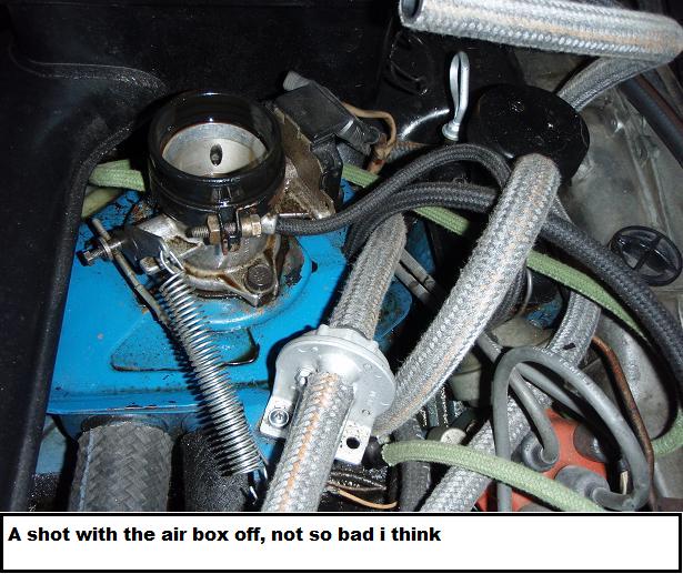

more

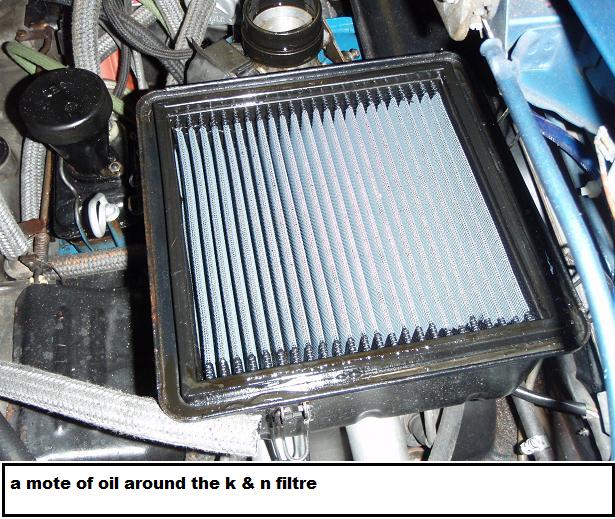

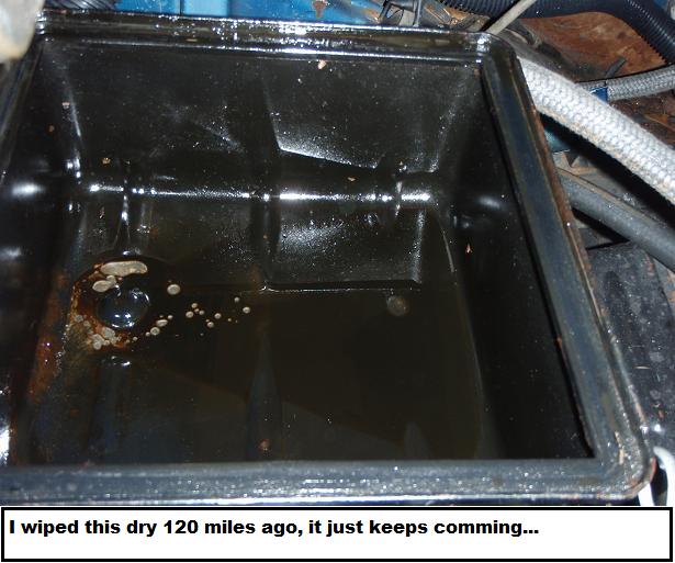

last ones

Been a while since I had FI on the car. Could you tell if it was coming from one of the breather tubes for the heads? Any smoke out of the tail pipe while running? I can't imagine anything other than excessive blow by causing that - which the compression test should show you.
Jake Raby
post Mar 3 2009, 06:54 PM
Engine Surgeon
Posts: 9,398
Joined: 31-August 03
From: Lost
Member No.: 1,095
Tons of blow by... Either the rings are shot or the exhaust valve guides are shot, or both..

When combustion gases go flying past the rings they can only escape through the PCV and the head vents. The gases pick up oil and oil vapor(s) along the way giving you a nasty mess (as witnessed above).

Bad rings can create blowby as they allow gases to fill the crankcase, forcing an oily mess from every orfice...
The same thing happens with bad exhaust valve guides as the exhaust gases pass between the stem of the valve and the valve guide, pressurizing the rocker box and then the crankcase..

My engine does the same thing when a hose falls off the head breathers or any other part of the pcv system. Check all your hoses and connections...sometimes they crack or loosen up down by the cylinder head.

How did your engine run before this mess? The stacked vacuum elbow being disconnected would have been a MAJOR vaccum leak. Is this your oil leak problem. No.

QUOTE(yeahmag @ Mar 3 2009, 07:51 PM) *
the hose it is comming from goes into the threeway split thing front left side of the engine, from there i would guess it is coming from the head.
yes, espically from hard throtle when i let go of the pedal.

QUOTE(championgt1 @ Mar 3 2009, 09:15 PM) *
the car ran absolutly great, even with the smoke... it is/ was fast. i used a piece of silicon inside the double stack, but im not so sure it was perfectly tight, and from what im learning there is quite a bit of pressure in my case.

QUOTE(jsayre914 @ Mar 3 2009, 10:28 PM) *
From what I have experienced with lots of motors, not just type 4, is if you get smoke on the highway when you let off the gas pedal, its rings.
