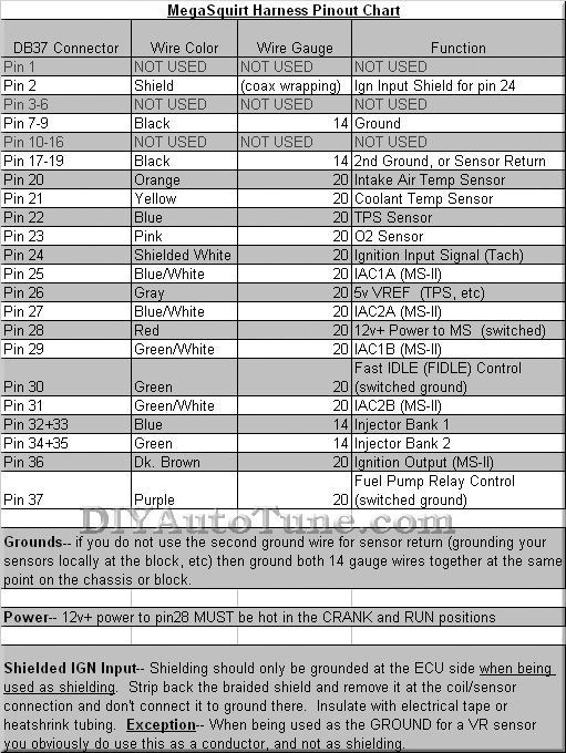

Finishing up phase 1 of my MS2 install. I cant seem to get the unit to trigger. I am not using the coil driver right now. I have a hot spark in the dizzy. Should I tie the - side of the coil to pin 2 or pin 24 on the MS2? Am i way off here?

Pin 2 is the ign shield for pin 24.
Pin 24 is the ignition input signal from the tach.
