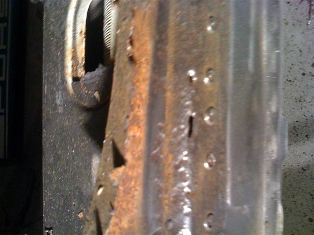

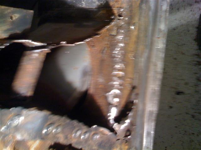

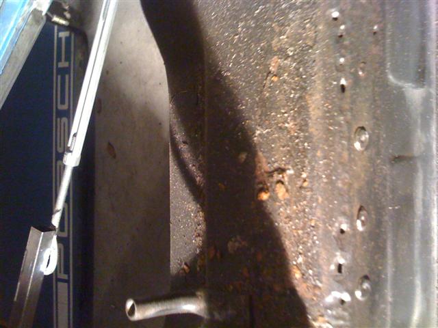

Hey guys. What should I do with these small holes in the longs? Should I patch with pieces of spare longs I have or try to fill the holes with molten metal. Any advice would be appreciated.

step away a foot or 2 let me see more and I'll tell ya. is that the junction of eh long with the floor board?

Yes it is right where the floor pan get welded to the longs. Very small holes and I think the inner long has two sheets of metal. I heard you can stick a nail in the small holes then weld it in the hole and grind. Oh yah I took the pictures with my damn IPhone. Will take more pictures with actual camera tomorrow

IMHO, pinholes like that mean it's much worse on the inside. But it's really had to tell from those photos whats going on.

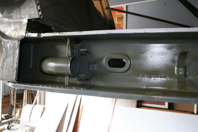

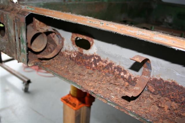

This is from my car...
Pinholes on the outside of the longitudinal
This is what was on the inside.
In my opinion how bad this section is depends a lot on how bad your hell hole is. pretty much all of this is due to drainage from the hell hole.
Regarding fixing it. It just really depends upon how "nice" you want your repairs to be and how deep you want to go. I could have just welded on clamshell reinforcements and sprayed down the interior with some type of rust treatment and it might have been just fine for a number of years, but I decided against that.
Here it is after a lot of work and just prior to welding back a new repo outer longitudinal...

Here's a thought. Pick the worst area, of the long and cut out a small section (several inches long) that captures the worst area. Look at the inside of the small section and make your decision.
If it's rusty inside, that long rusted out from the inside out and needs fixing.
If it's not, then the long rusted from the outside in and might be patched.
After deciding that it's OK, then you weld the cutout piece back in.
However, if I'm reading the pics correctly. the rust looks to be in a line along the bottom of the long. That line of holes means that there is a local line of weakness in the metal and a tendency to break along the line. To fix it, you have a lot of pinholes to weld without access to the inside of the long. Pinholes tend to get bigger at welding without a copper backing plate, and it can be a real b*tch to weld upside down.
