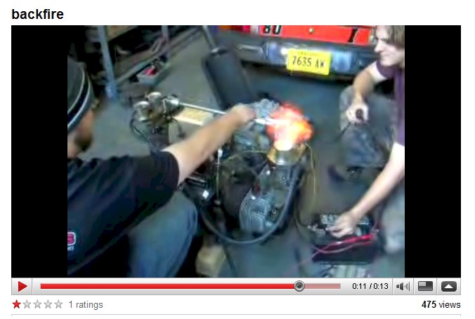

My carbs are popping on decel. It could be timing, but I bet that my Eurorace headers are leaking from the collector. I know I can see exhaust coming from it at idle. I think I remember seeing some sort of aluminum tape that you could put on exhaust pipes to seal a leak. I thought that might be an easy way to seal up those joins after I have the pipes ceramic coated. Anyone know anything about it? What have others done to stop the collector leaks on their EuroRace headers? Zach "Could be timing"? 'Splain that, please. I see it pop up all the time in these discussions, but have never, in nearly 40 years of schooling and wrenching, seen any documentation to support this statement. The Cap'n http://www.youtube.com/watch?v=PbnVnjfgM8A T4, backfire due to being 180 out of time (surrounded by World members). I dunno about when time is close enough to be running. But another member recently had a thread about a running engine that was backfiring stop when he got the timing right. But, as I said, I think my issue is exhaust leaks from the header collector, and not timing. Zach |

lesson learned that day - fire out the carbs is bad : ) Attached image(s) ![]() |

T4, backfire due to being 180 out of time (surrounded by World members). I dunno about when time is close enough to be running. But another member recently had a thread about a running engine that was backfiring stop when he got the timing right. But none of those were backfiring on decel as you stated in your first post. A otherwise good running engine that backfires on decel will most likely have an exhaust leak ... (IMG:style_emoticons/default/shades.gif) Andy |

Let's talk about this. Your car runs, right? I thought so. The evidence you give for reaching the conclusion that timing will cause backfiring consists of a video of an engine backfiring with the timing 180 degrees out. Note that it it never starts, and that the backfiring is through the intake, not the exhaust. An engine 180 out won't run. Nor will one 90 degrees off. Maybe even 45 degrees. Even at 5 or 10 degrees, timing won't cause backfiring in our exhaust systems. Exhaust backfires in T4s tuned for the street is usually either a serious lack of exhaust back pressure or a leak, allowing fresh air to be drawn into the system. Backfires through the carbs on a running engine are generally either intake leaks, badly worn carbs, or failure to properly adjust the carbs and the linkage.
