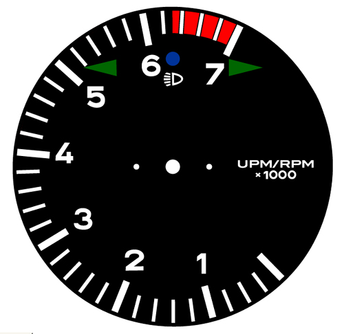

One of the downsides of using a smaller steering wheel is that you have limited visibility of some of your gauges.
Well, at least if you're any taller than Clay ... (IMG:style_emoticons/default/poke.gif)
I've been running my Tach upside down for quite a while now which really helps with the visibility.
However, i am not quite happy with the looks. So i decided to make my own Tach face for the upside down Tach.
Below is a picture of the new Tach face i made ...

Seems appropriate.

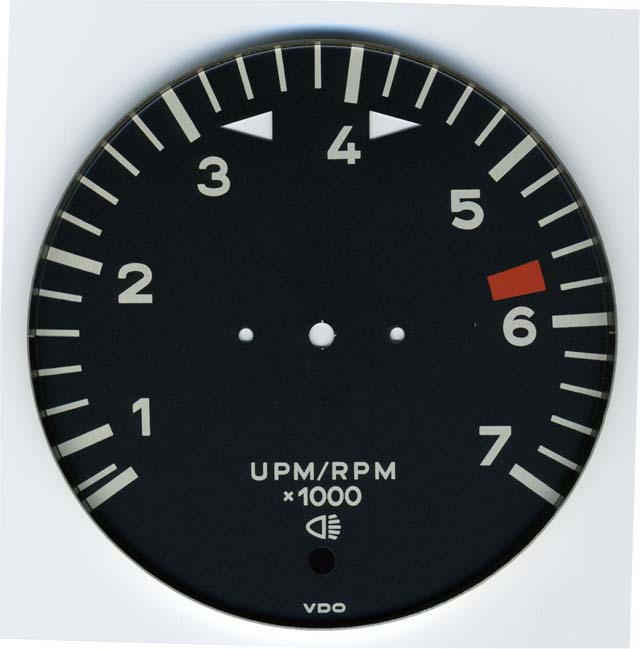

And the original for comparison ...

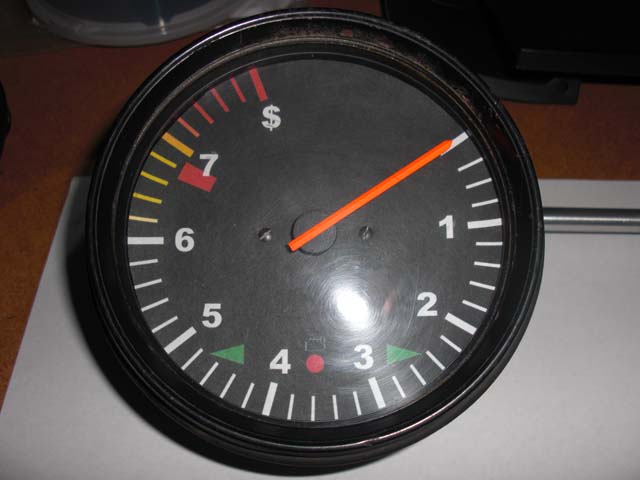

Keep the tach right side up and just move the numbers...
We do the turned tach all the time, here is one we just sent out. This one in particular had a 6250 redline, so we put it at 12:00
Do you want the correct Porsche numbers? I can send them to you if you want.

Problem with that is, i can't see the turn signal indicators either if they stay on top.
Plus, i wouldn't be able to see the redline on that Tach of yours! (IMG:style_emoticons/default/huh.gif)
I'm happy with the way it works right now, the only annoying thing is that the numbers are upside down. That's why i thought about making my own face for it.

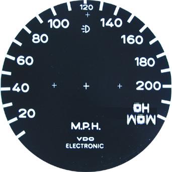

Here's a quick and dirty paintbrush rendering of the speedo I want in my 914 after the 4.0L engine is installed.
If you have ever heard Bill Cosby's 200MPH you will get it.

Faster than anything Steve McQueen owns......

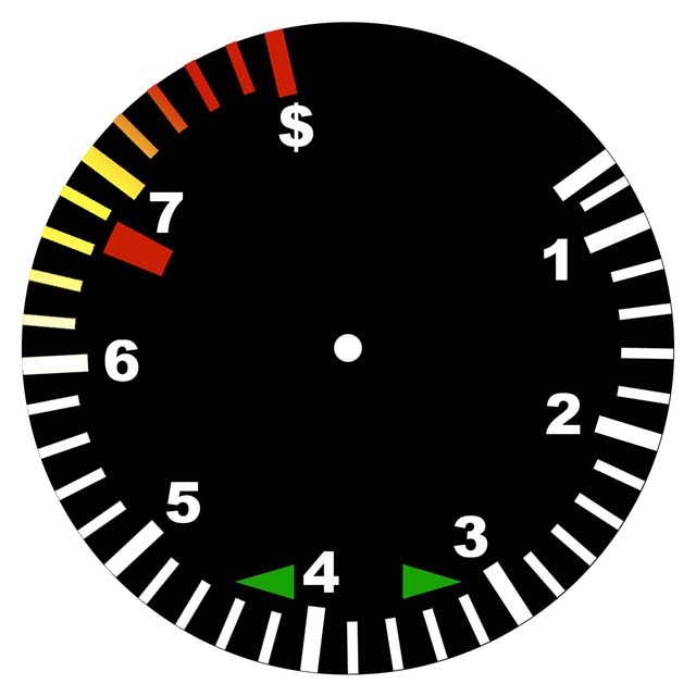

And here's the 6 cylinder version!

What do you print them onto?

Testprint on plain paper, i just assembled it to see how it looks. The GF took the camera, so pics have to wait.
The final print will be on thin glossy self-adhesive photopaper ...

Making your own stuff is neat. It would be my luck it would not be uv resistant and dissappear in about a month.

Yeah, i thought about that. Maybe i'll hit it with a coat of acrylic clear ...

just laminate it

Hi, I made some test stickers from the printing sticky paper you are talking about. I used Polyurethane in the rattle can. fog the first few coats so your ink does not run. Then some nice even coats (you could use semi-gloss). It blocks UV (UV makes the colors fade) and it is on the outside of my truck. I've washed it a few times, after it got muddy, and no lifting. Plus it has been hot here.

I love the $ sign... too funny but oh so true when they whiz by valve float (IMG:style_emoticons/default/laugh.gif)
