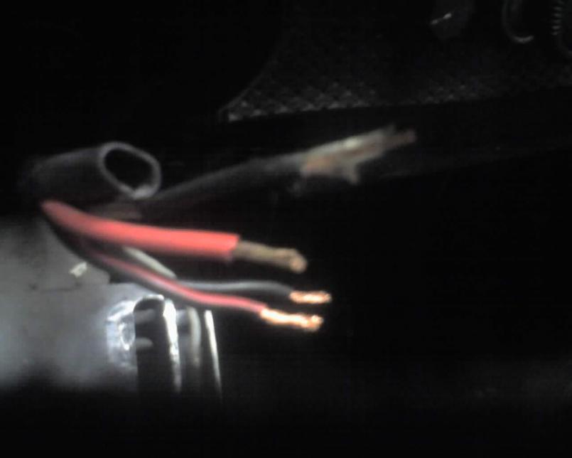

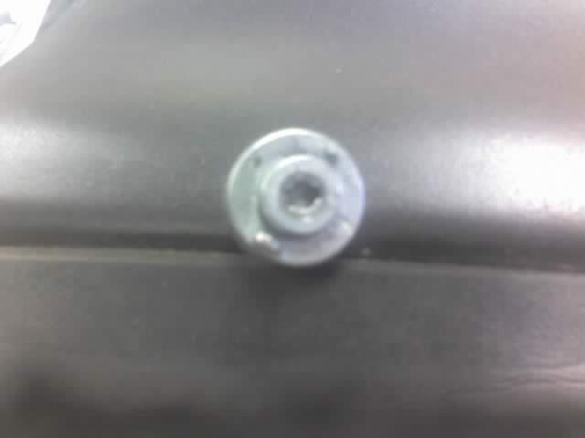

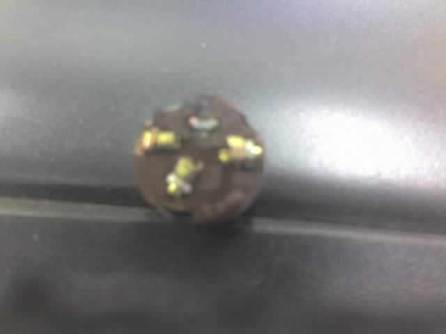

A 914 owner contacted me and needs help with an 'ignition harness' for a 1971 914. I think they need something up by the ignition switch but really am not sure, do you? If so, please contact them directly.
Here are the photos and message they sent:
Owner Darcelle Jazaeri" <dweart@hotmail.com
Mechanic wjackso1@gmu.edu
Hi Jeff,
I wroute you a while ago about needing an ignition wiring harness for a 1971 Porsche 914. Below are the pictures you requested. Please advise if you have this part, and if so, how much it would cost. Thanks so much for your help.
Darcelle
> Date: Wed, 22 Apr 2009 14:19:58 -0400
> From: wjackso1@gmu.edu
> Subject: pictures of the wiring harness & connector
> To: dweart@hotmail.com
> Darcelle
> Here is the pictures you needed of the four (4) wires for the
> ignition. The plug end for the ignition switch.

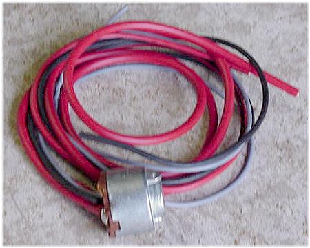

The very early cars (70/71) had a 'harness' soldered to the electrical portion of the ignition switch. This member is hoping to repair their early switch.
Apparently they're still available from Porsche for about $45.

never mind ... looks like the wires were cut off
