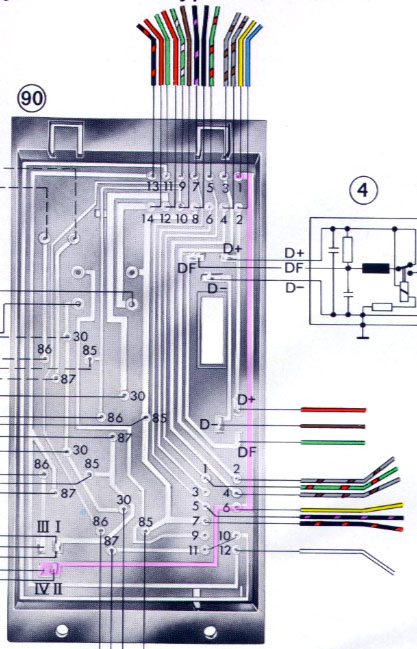

You didn't do anything with the wiring at the starter?
The starter wire is pin 1 at the forward connector on the relay board, pin 6 on the rearward connector on the relay board, and is also connected to both rearward FI connector pins.
McMark
post Jun 24 2009, 08:48 PM
914 Freak!
Posts: 20,180
Joined: 13-March 03
From: Grand Rapids, MI
Member No.: 419
(IMG:style_emoticons/default/cool.gif)

Thanks for the diagram--could I have reversed the FI connector?
QUOTE(McMark @ Jun 24 2009, 06:48 PM) *
