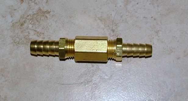

i added one of these tubing adaptors and it makes you never have to worry about a step down hose that is expensive and hard to find. thanks Chris at CFR!

So, how much was the tube? I reckon the only place to get that thing is from CFR, while the $20-25 hose is available at any Porsche dealer in the world, although they'll have to order it. And you won't need 2 pieces of hose and 4 hose clamps, either.

$10.95 delivered price, yes, have to use two bits of hose and four clamps to join it all together.

I have a similiar setup on my early car with no problems in about 1.5 years. For $10.95 delivered I would go with CFR's piece but the brass fittings will work. Thanks Chris for all the great parts (IMG:style_emoticons/default/aktion035.gif)
