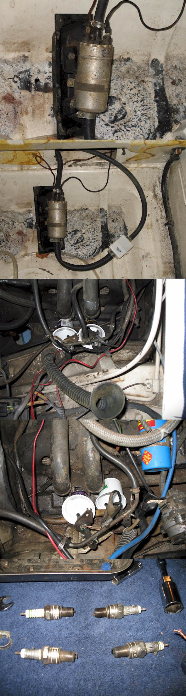

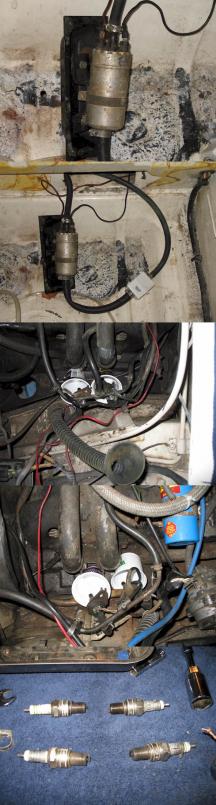

thanks and i appreciate the offer - i have some spares - after removing me injectors and spark plugs - i realized i was definitely not getting fule - i pulled the fule pump and it was getting power but not coming on - i will replace it and see what happens.
