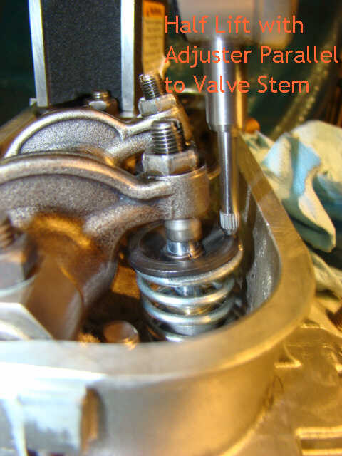

That's not anything like I did.
I ran the shaft of the dial indicator parallel to the valve stem shaft so I could measure total lift of the valve. I then divided that number in half and used the adjustable pushrod to find a length that resulted in the adjuster screw being parallel with the valve stem at half lift. Changing the length of the pushrod would change lift some so it was a trial and error kind of thing.
I also used shims under the rocker assembly to help with how much thread I had for moving the adjuster screws in the rocker arms.
As I understand it the most important issue is lateral forces on the valve stems causing wear of the valve guides. Having the adjuster screw parallel with the valve stem at half open results in the least amount of wear. As I remember, it is better to give up a little lift to have the right orientation at half lift.
Dave

Here's a pic

Half lift alignment will give your motor a longer life. You should check full lift to ensure that you are in the ballpark, but full lift should be sacrificed to ensure good half lift alignment.

That is a good picture. I think the adjuster in that picture could be straighter or more inline with the valve stem. Also the rocker could be moved to it's left a little. The idea is to only have the adjuster working across as close to center as possible. If the adjuster is all the way up in the rocker arm the rocker arm needs to be raised to get the adjuster straighter. Close isn't really part of the procedure it needs to be right. Don't get in a hurry there is no rush it isn't easy but once it's right the guides will last a long time.

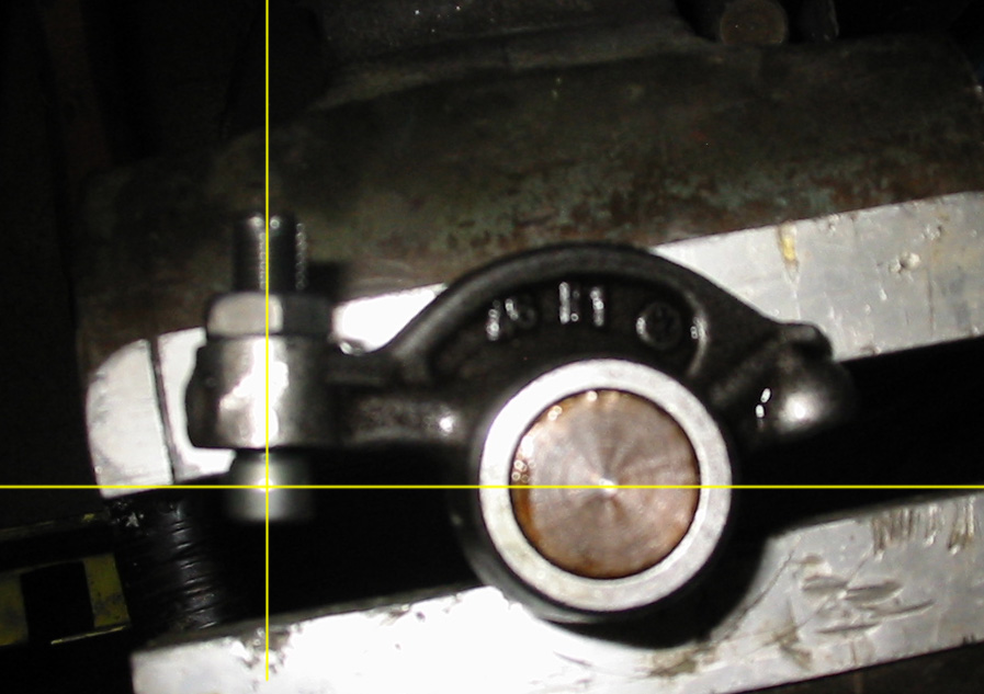

Your rocker arms need to be ground down about 1/16" where the swivel cup of the adjuster gets close. I found that if I turned the adjuster all the way in to where the swivel cup hit the arm and then backed it out about 2 turns was a good starting place. It needs some clearance to allow the swivel cup to swivel when it opens the valve. Also, if you really think about it, to get the adjuster screw inline with the valve at the half lift point, you need to add shims to the rocker arm shafts. My cam is pretty low lift and I needed to add about .080" of shims under the rocker arm mounting blocks. I my opinion, this is more important than the length of the push rod. The higher lift cams will need smaller shims if any at all.
This photo shows the orientation of the rocker arm should be at half-lift. The valve stem should be exactly in line with adjuster screw at half lift. To get there, you have to adjust the pushrod length and the ht of the rocker arm shaft. IMHO
