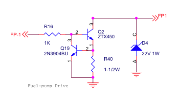

So the fuel pump NEVER turns on?
If so, then it's a blown driver transistor in the MS or a wiring problem (I know you've checked!). I don't think there are any settings that will cause the pump to never come on. The prime pulse settings that others have mentioned only affect how long the pump runs after you turn the key to the on position (before starting).

It definitely sounds to me like the MS is not switching the fuel pump line correctly. If you connect a test light from 12V to the fuel pump output of the MS, it should turn on for a couple seconds when you turn the key on. Are you using a relay board?

do you know which parts of the board hardware I should look at?

Yeah, but I need to know what Megasquirt version you are running first. V3 board or V2?
RJMII

The fuel pump driver transistor is Q2, it should be labeled on the board.
Have you checked the wiring to the Megasquirt and are you sure the Megasquirt is getting power (ie. it shows up with valid sensor readings in Megatune)?
