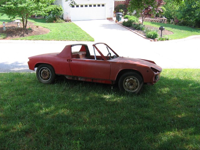

This is how it looked when I first got it. Brought this home from Southern Caifornia. The transport company rolled it up in the yard since it had no brakes.

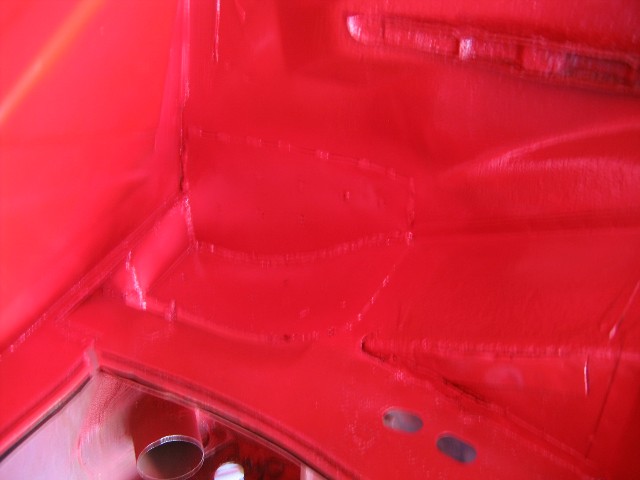

Repaired hell hole

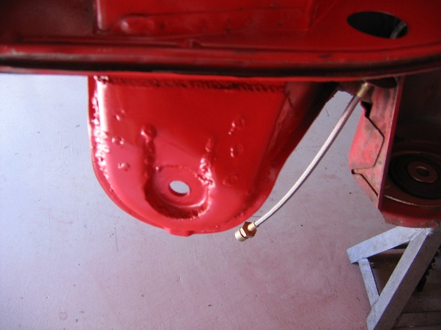

Reinforced rear suspension console

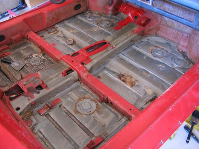

Removed sound deadening from the floor and prepping for POR15

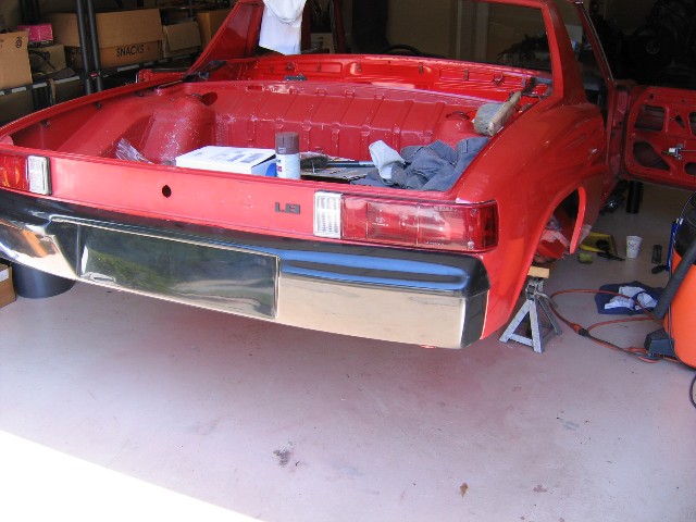

Rear fiberglass bumper fitted
