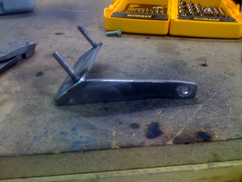

I fabbed the DFU brackets today:

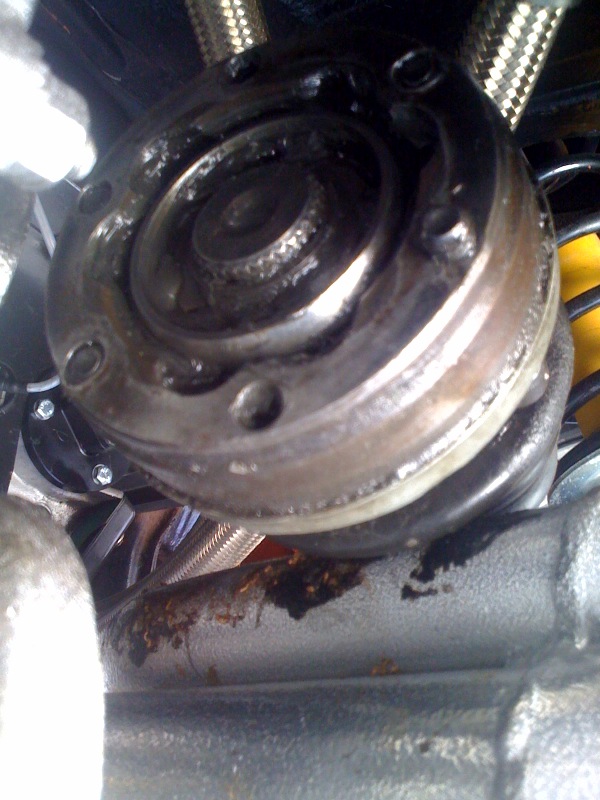

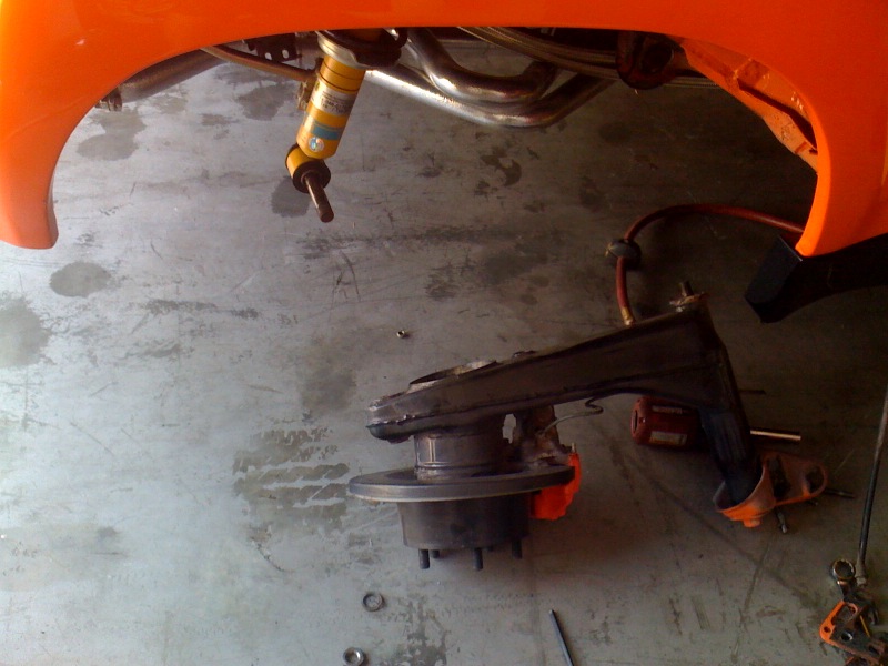

So I'm hooking up the drive shafts and I find this (anyone see something wrong?):

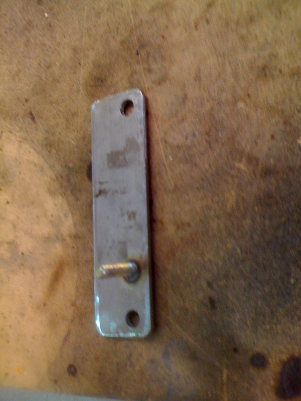

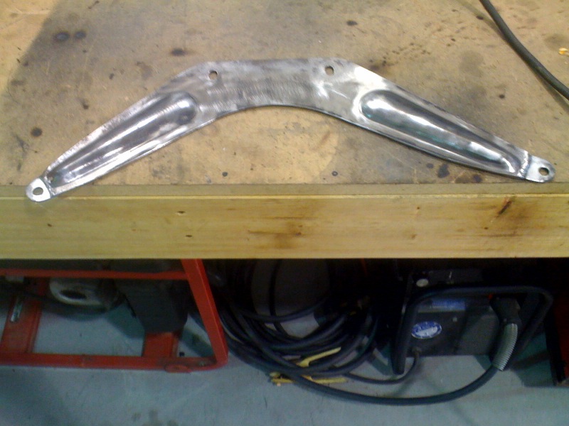

There's no way to get that axle out without:

Member No.: 2,602
/4 muffler hanger modified for this job.
Missing pins or is it a 6-bolt?

QUOTE(Eric_Shea @ Jun 10 2011, 07:47 PM) *
6-bolt w 4-bolt boot so you wouldn't notice if it were installed.
Eric_Shea
post Jun 10 2011, 09:50 PM
Post #211
PMB Performance
Posts: 19,304
Joined: 3-September 03
From: Salt Lake City, UT
Member No.: 1,110
Probably common I'm afraid. 930 (6-bolt) 108mm CV's are the only 108's available right now...
Either pin that one with larger (12mm?) pins or drill the bosses on the flange and stub axled to accept the 10x1.5 fastener (my choice). Be careful though, both pieces are hardened and it will cost you or your machinist a "bit" or two. If you pin it you'll still have to widen the holes in the stub and flange.

QUOTE(Eric_Shea @ Jun 10 2011, 11:50 PM) *
I found a new Lobro 914 CV on eBay. It's on the way.

QUOTE(ellisor3 @ Jun 11 2011, 11:42 AM) *
Eric or Joe,
Could you explain in a little more detail what the issue is, I am not sure I understand what I am looking at.
914 CVs have four bolts and two pins. This one is a six-bolt CV, so it's not possible to pin them. Your 3.2 would break that arrangement. I have the correct one on the way.

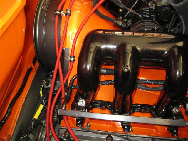

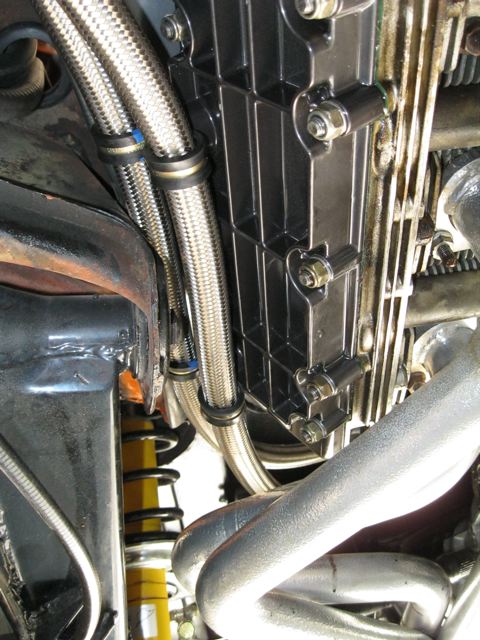

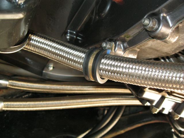

Adel clamp fun. I'm very happy with the oil lines attached to the lower valve cover. They were a bitch to install, but all is very secure and nothing will be rubbing.

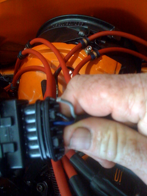

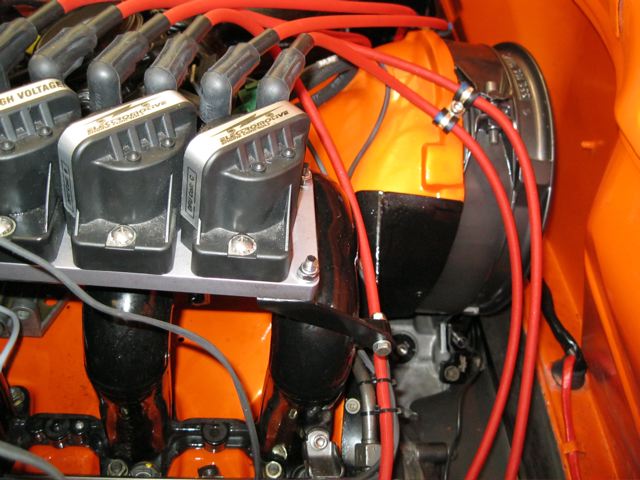

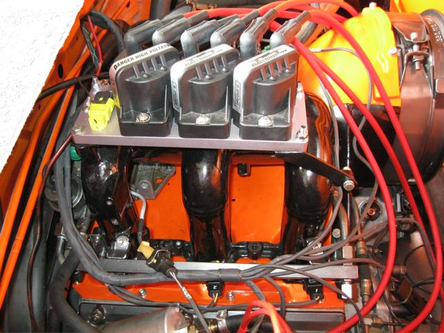

I also spent some time getting started on tidying up the wiring in the engine bay:

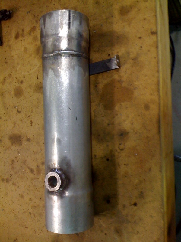

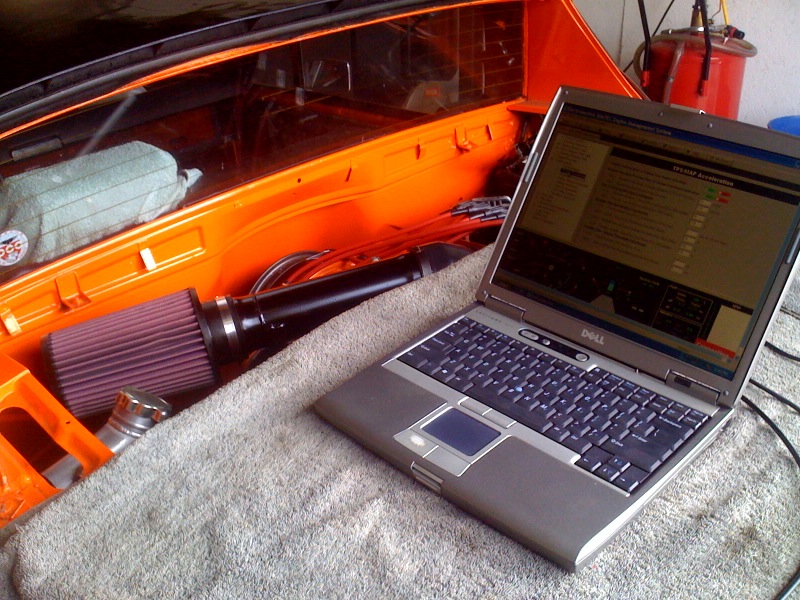

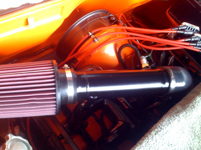

Many little things are being accomplished randomly, but today I made the intake with the MAT sensor installation and I made HUGE progress in the tuning of the engine.
If I had the last pieces it would be very drivable. I should be able to run it around the block next week!
My eyes are friggin' burning from the exhaust fumes. (IMG:style_emoticons/default/wacko.gif)
We are very close to completion.
Here are pictures of the intake fab, finished intake and tuning workstation:

Joe, I know you had some reservations about the Tec GT system. What are your thoughts, good and bad?? When can we see some #'s
Series9
post Jun 23 2011, 08:31 PM
Post #219
Lesbians taste like chicken.
Posts: 5,453
Joined: 22-August 04
From: DeLand, FL
Member No.: 2,602
I didn't and don't have reservations about the product. I had reservations about the amount of money and time it would cost to set up and tune on a stock engine, when we could use a stock Motronic DME that would make it run perfectly right out of the box.
The ignition portion of the system is excellent. At this point, distributors should be obsolete. Now you get to enjoy a virtually maintenance-free ignition.
As for the fuel side, it should be drivable now. I'll have to put some miles on it and tweak it some more. The file that was sent to me for this engine was basically unusable. It would neither reliably start nor accelerate the engine off idle. On the up side, this has caused me to have to dig deeply into programming and work it out on my own.
Also, if you decide to modify the engine in the future, I will be able to adapt the engine management to accept the changes. In that way, it could pay you back some of what you've spent.
The cool-factor is high. You're going to like it.
I'm gonna (IMG:style_emoticons/default/driving.gif) next week. I'll take some video for you.
