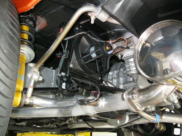

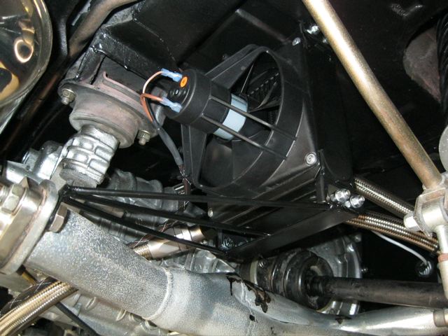

Today was the last day of fabrication. I'll be getting the last part on Friday. I'll drive it that afternoon.
Here are the bottom cooler brackets and fan/O2 sensor wiring:

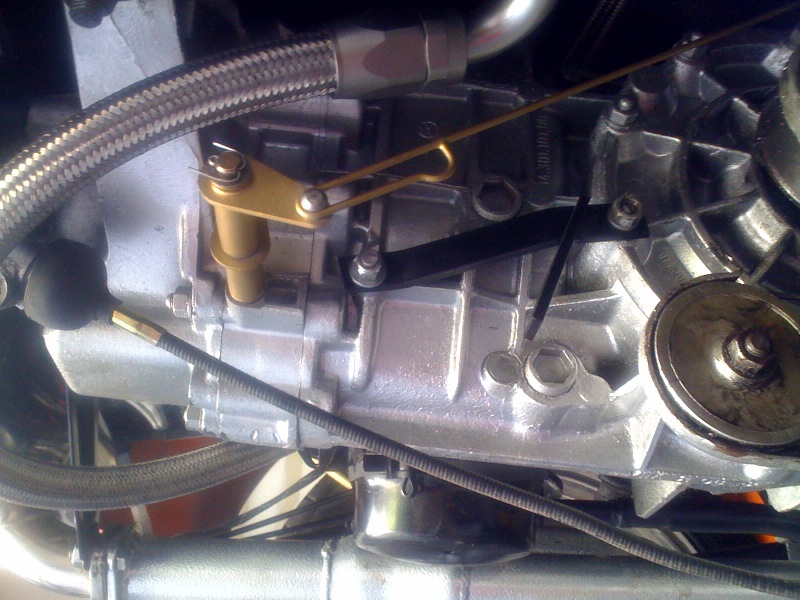

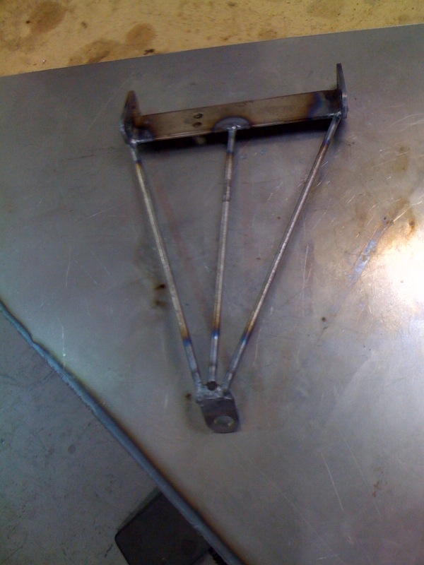

I was waiting on the throttle linkage from Rich.
It came today. When I started to install it, I noticed that something was wrong.
It looks like this tranny has an intermediate plate from a REAL 6.
I screwed the bellcrank shaft into the transmission and modified the RJ bracket to do the rest:
I had to remake the cross-over oil line between the coolers because the 45 on the passenger side was in the way of the throttle linkage.
