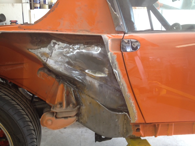

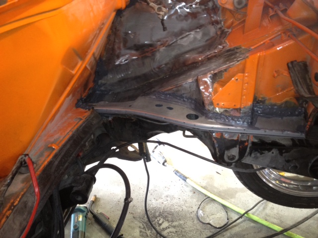

Here's where we are tonight.
The top piece is cut and welded and the bottom piece is mocked up:

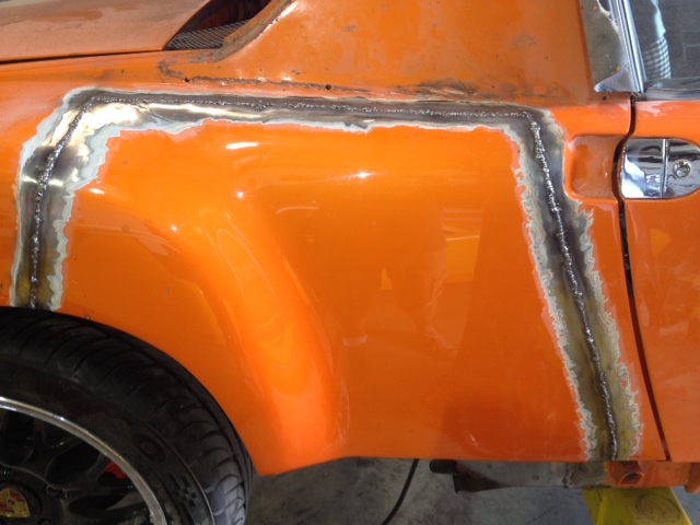

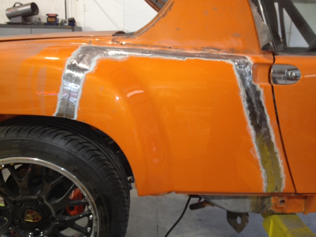

First time on the lift after installation of the new wheel house.
The door gap used to become ugly when this chassis was in the air.
No longer:

post Apr 18 2012, 12:24 PM
Post #326
Posts: 5,629
From: NoVA
Member No.: 50
Nice!

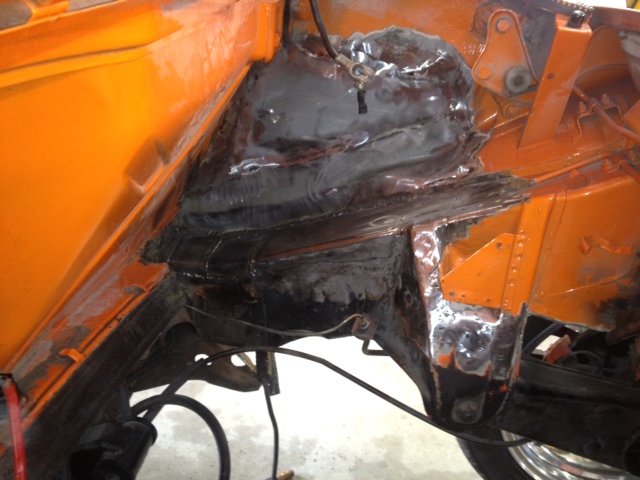

The longitudinal is whole again:

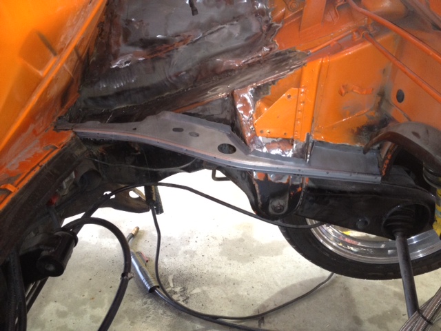

Test fitting the engine shelf.
Since the top of the long was hand made, this is taking some massaging to get it fit up.

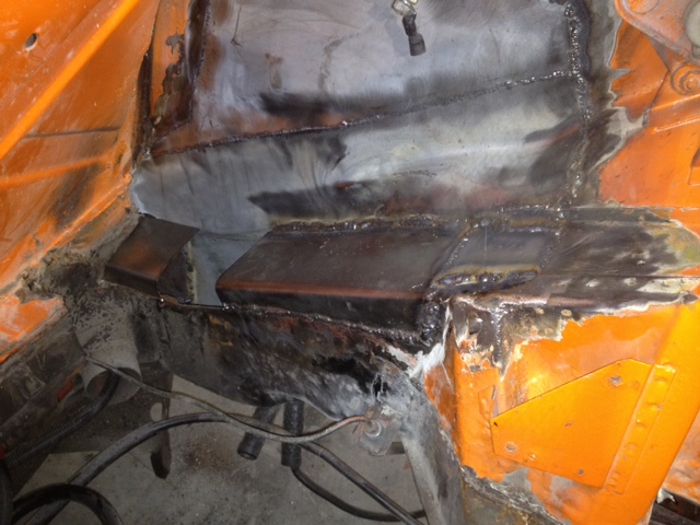

The shelf is welded and seam sealed:

This one's for James.
I'll have it fully welded by the end of the day:
