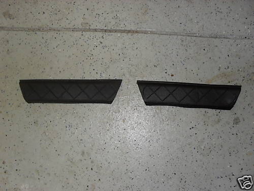

How do the plastic air foils that mount under the car, infront of the engine, help cooling? Are they worth adding?

They are helpful. Use them! They mix the air up so air can be picked up better otherwise the air is is ducted through under the car.

My guess is that they are worth having installed since the factory installed them for some reason. They mount on the bottom of the back edge of the firewall by 3 or 4 6mm screws, if I recall correctly. Do a search here as there were some recent post including a pic of the flaps installed.

They were mounted with 3 7mm? bolts on each side. If the car came equipped with them, there should be weld nuts on the rear body pan lip. You can easily drill and use regualar fastners ... no biggie.
As I remember, the are spaced about 15" apart from the centerline of the engine or car (There is a diagram in some manual that I have or try Pelican Parts tech section).
Purpose is to create lo pressure area under the cylinders to help suck air and aid in cooling (they do work well).

They cause a vacume to occur under the engine @ speed so as to help draw cold air in from the top & through the engine.

jimkelly
post Aug 22 2009, 10:20 AM
Delaware USA
Posts: 4,969
Joined: 5-August 04
From: Delaware, USA
Member No.: 2,460
pic

They induce turbulence which helps throw air along the underside of the engine as well.

Like Johny says above....
Actually they create a low pressure area behind them at speed and which helps draw down the air across they cylinders. Some of the race cars with big air dams actually remove the rear bumpers to help draw the cooling air out.

QUOTE(Bruce Hinds @ Aug 22 2009, 11:25 AM) *
That is the reason the 914-GT didn't have a rear valence.

They were introduced on the 73 model year, and were on all 914s after that.

QUOTE(thesey914 @ Aug 23 2009, 05:01 AM) *
ever fitted on a six?
Not from the factory, but they do make a difference with retrofitted. I didn't put them on my 73 conversion at first, but when I did, the oil temp dropped.
