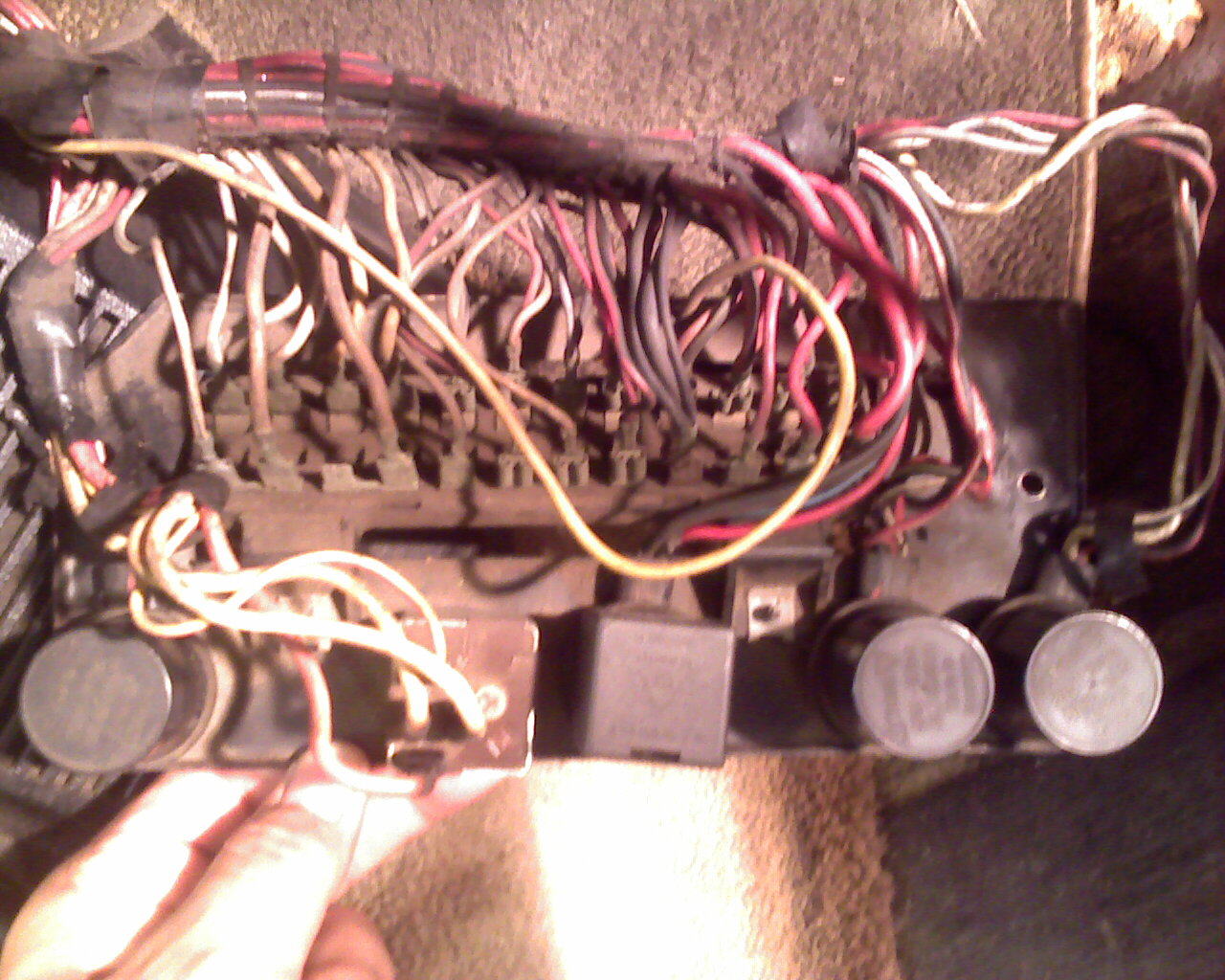

I have a 5 relay fuse panel and still can't figure out what they do, maybe I should take a pic and post it.........one of you can point me in the right direction? tell me what the hell they do?
