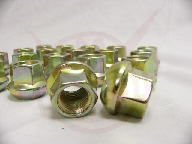

I've got a set of Fuchs wheels headed my way, and I would like to make sure I have the right lug nuts for them when they get here.
What type of lug nuts do they require, and where's the best place to get them? (f the ones I have don't work) |

You need 14mm x 1.5 ball seat nuts. If you want steel, they're CHEAP on eBay. Nice way to get rolling, then spend $200 on nice alloy lugs later.

Are yu going to use spacers of any kind ?? Check your lug / stud length , the closed top alloys may bottom out. McMark has agood idea of the open top steel lug nuts , maybe use them with a cover cap to go over them to cover the nut and stud protruding from the nut , ball seat definately.
