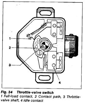

The TPS has two functions:
1. Idle indication. The TPS has two contacts that indicate when the throttle is fully closed. The TPS calibration procedure takes care of this function. Your car will idle poorly if the ECU doesn't know that the throttle is closed.
2. Transient throttle detection. The serrated traces on the board act to detect changes in throttle position so that the ECU can add additional fuel. The car will have poor throttle response if this circuit isn't working properly.
If you've performed the TPS calibration procedure and you still have poor idle, you should verify that your sensor wiring is OK. Check the continuity of the leads from the TPS connector to the ECU connector.

Nice update and follow through Dave. Tell me: how is the 1.8 L-Jet TPS different ?
It's not a wiper style, just a two-position contact switch.
http://manuals.type4.org/ljet/tests/ljet13.htm
