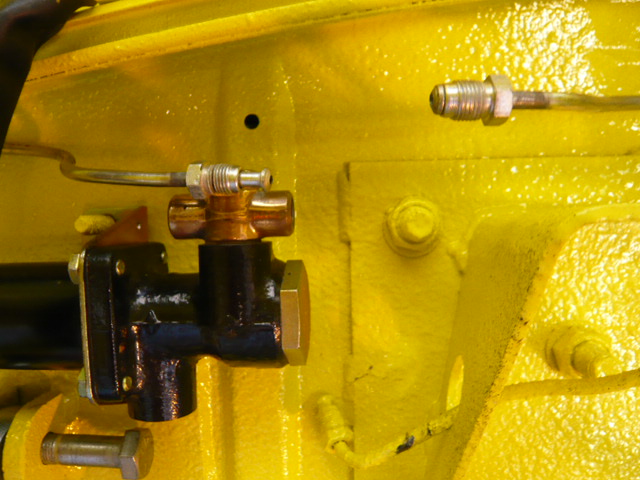

1970-1983 911 rears with either the rotor spaced out 5mm or the calipers spaced back 5mm with washers.
914's do not have proportioning valves.

"914's do not have proportioning valves."
Oh?

QUOTE(Eric_Shea @ Sep 22 2009, 02:22 PM) *
Maybe it was aftermarket, but my '73 2.0 had an adjustable proportioning valve, bought it that way. Not really sure what you're saying Eric, and I know you know more than I do, but I've seen many 914s with the valves, maybe all aftermarket, but nonetheless, 914s with valves.

QUOTE(Cap'n Krusty @ Sep 22 2009, 04:25 PM) *
Oh?
The Cap'n
LOL, well mine doesn't...cuz I took it out (IMG:style_emoticons/default/huh.gif)
Anyway, I am using 911SC "A" calipers and rotors up front, and front 914 calipers in back. (No e-brake but it is not really a street car anymore.) I put a "tee" in place of the proportioning valve, but I have an adjustable Wilwood sitting here if I ever decide I need the bias adjustability. 19mm master cylinder, Pagid pads. I have never felt short of brakes thus far although many of our local tracks are not extremely tough on brakes relatively speaking.

Oh?
It doesn't "proportion" anything. It's a saftey device that shuts the rear brakes off in a panic stop (535 ft. lbs. of pressure if I recall). Otherwise, it acts like a "T" passing fluid back and forth without a care in the world.
At least that is what I am led to understand after reading the page in the factory manual describing the unit and it's operation. I may not have read it properly...
It was one of the first things to go back into my car.

QUOTE(Eric_Shea @ Sep 23 2009, 12:49 PM) *
Oh?
One went back in my car today... Thanks E! (IMG:style_emoticons/default/smile.gif)

Eric,
Yeah, I strongly suspect you are right about the function of this puppy. The main reasons I removed mine were (a) I had already seriously modified the stock braking system, (b) it was heavy and © I have no reason to limit or cut-off rear hydraulic pressure in a track car application, so far (might change though).
