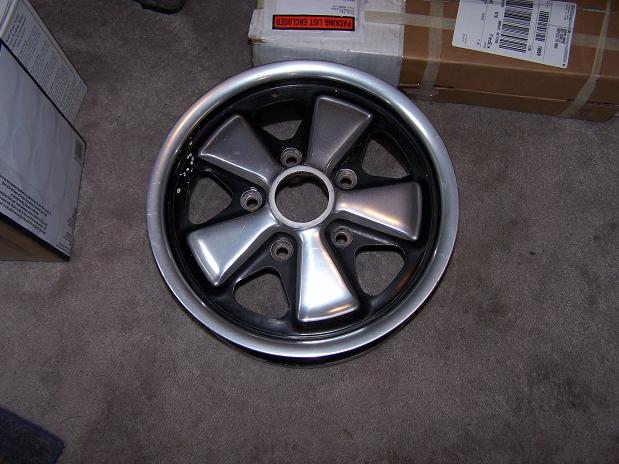

I am inching closer to completing my GT clone. I also have a 911SC and I have 4 sets of wheels total that fit either car. I have 2 sets of Fuchs that are 16x7 + 16x8 and a set of BBS in the same size. I also have a set of Borbets in 17x7.5 + 17x9. Not all wheels have tires on them but so far I have 205/55 + 245/45x16 and 225/45 + 255/40x17. I purchased a 16x6 Fuch to be used as a spare tire/rim for the 914. So assuming I stay with the tire sizes I listed what would be a good tire size to mount on the spare ? I want to make sure the tire/rim will fit in the front trunk in the original horizontal position and be useful as a spare if needed. My guess is 185/55 or 195/55 ? Thanks guys.

After a few cups of coffee (IMG:style_emoticons/default/biggrin.gif) and some web searching it looks like a 195/55x16 is a good match.

I used a 14x5.5 fuch with 195/60/14 tire. The tire height was just about the same as the tires on the car.
All my tires are aprox. 24.68 - 25.03 tall and the 195/55x16 is 24.44 so I think that's a good match for any of the tires that could go flat. Nice looking wheel you got there. (IMG:style_emoticons/default/beerchug.gif)
