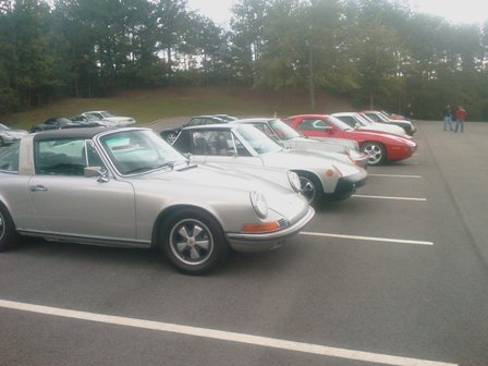

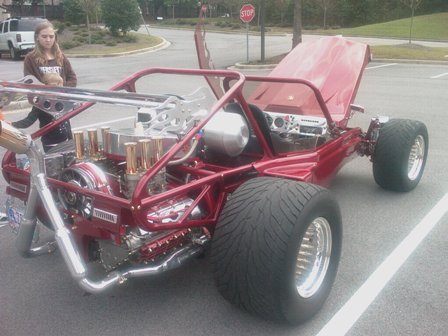

Here are a couple more pics from the Fall Festival.

I love that last pic of the rail with a six. I'm just trying to figure out where he can use it, especially with those tires? And no air cleaners.... guess it's just for show.

HA! There is no way that "sand" rail ever gets driven. That shiny engine would be trashed with a quickness. It does look cool though.

That Rail looks like a Wheelie machine
