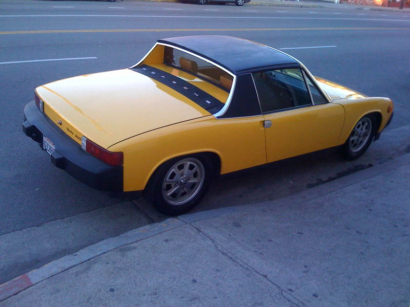

I have 205/50-15 on my car will no rubbing and no pulling of the body by me. This is a 76 car.
BobClick to view attachment
