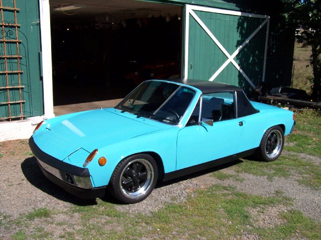

This is the look of factory 7” Fuchs with 911 offsets with 205/55 tires. Rolled lip on rear of car.
