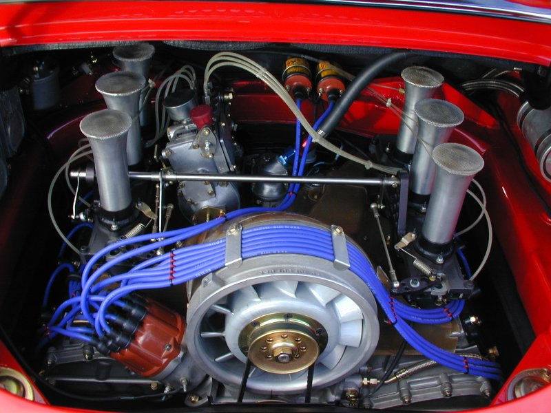

No... What I need is something like THIS!!!!
(Did I mention that I hate carburetors??)

I need that motor in my 914 /6!
