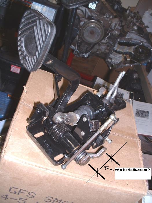

Well through a little investigation ,I have discovered that the PPPO had installed a 911 clutch pedal spindle and lever. Not only is the spindle an inch longer (he had spacers installed) but so is the lever at the cable/clevis end. This of course broke the clutch tube off the inner tunnel (which I have rewelded better that new)and with spacers removed now makes contact with the gas pedal linkage.
This gives me a couple of options: order a new spindle/lever from pelican or just cut the 911 one down to size. Because I'm all about fixing what I have, I need the dimension from the center of the spindle to the center of the clevis hole.
anyone have a pedal cluster in the tickle trunk that could take a measurement and help a member out? PS- this is not my cluster but shows the part I need to modify on mine
